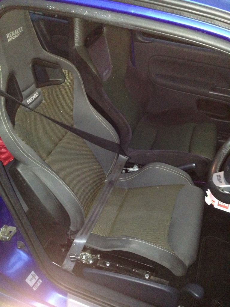

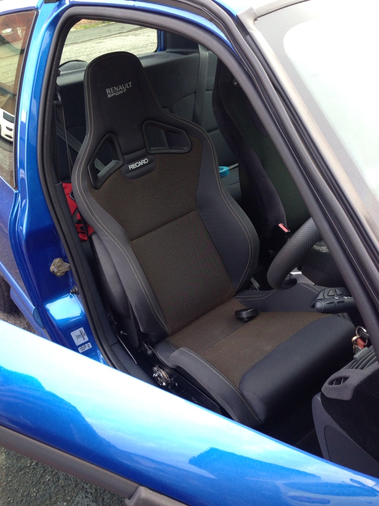

Turns out drivers seat isn't to hard at all to fit mate it's the passenger that's a bit tricky

Looks really good! why was the passenger one harder?
