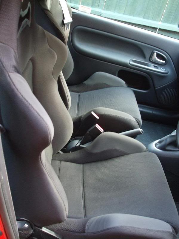

There's a washer (about 3mm thick) in between the runner and the subframe. Remove it and the driving position is even better. Doesn't serve a function IIRC.
i removed my washers on my drivers seat - there 15mm iirc! makes such a difference! :)
needs pics! lol
sexy :)
thats just what i did! lol! (took longer in the dark) but i couldnt wait! :) - ooh the memorys!!!!

depends on your interior Mr Fubar! mine looks in keeping and im a fussy sod!
