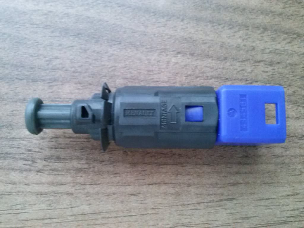

Just fitting the crusie control from a 182 to my 172. All was pretty straight forward except i have this clutch switch (see pic). I followed this fitting guide http://www.cliosport.net/forum/show...-RS-172-or-a-dCi-(DIY)&highlight=cruise+guide but cant see anywhere to fit this switch, is the switch just for the Dci models? From what i have read on here i think the brake pedal cancels the cruise control on an RS not the clutch?
Ignore this thread, i have figured it out, fitted it and now have cruise control.
Yeah delivered this morning cheers. Was going to let you know after i had made sure all was in working order, and it is so thank you,pleasure doing business with you

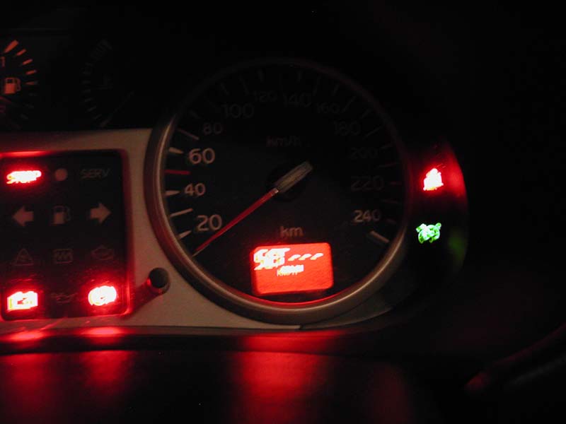

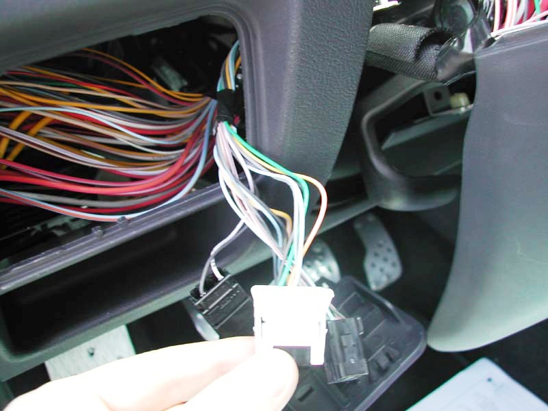

+ i have the white connector behind the dash (see pic 1) but when I short the green with the yellow wire; the SET... doesn't appear on the dash (see pic 2)

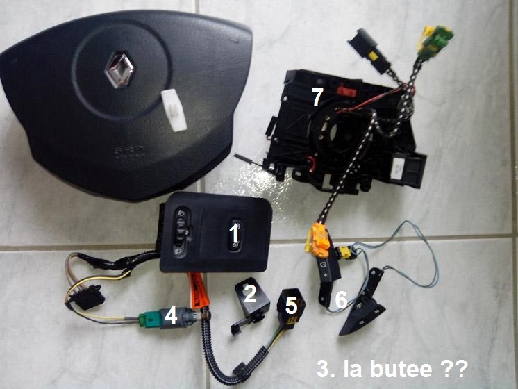

+ I have all the equipment (see pic 3)

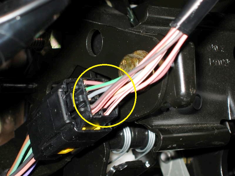

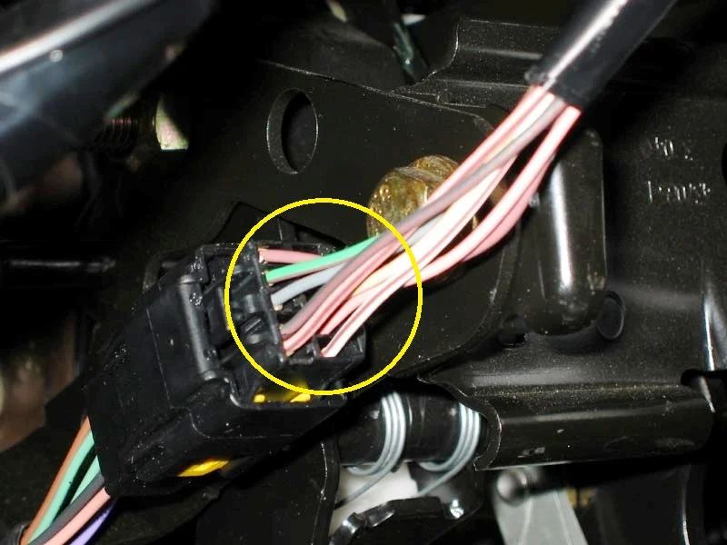

+ I also don't have the loom next to the clutch pedal that fits in the connector No5 of pic 3 (see pic 4)
has anyone fitted the cruise control which is not pre cabled from factory ??
