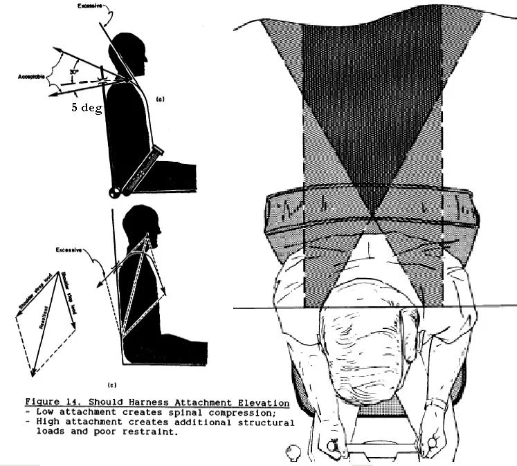

Best look at the attched photo to show where the harnesses should be attched for safety in a crash situation. I had mine mounted that low and I could fell them squashing my spine in hard braking in a crash it would have been very dangerous.
