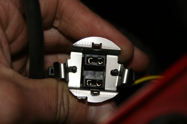

I know its been called upon loads of times - Has anyone done a fitting guide? I have just bought a HID kit for the trophy H7 but found out when fitting 'how the hell do you hold the bulb back in the headlight??!! because the holder has already got the wires in it.

There aren't to versions of the H7 bulb is there???? the bottom of the hid bulb is exactly the same as the OE bulb - but there is no way of holding the hid bulb in the headlight??

In the back of my headlight I hust have a hole! so you can insert the bulb and holder then twist the holder to secure the bulb in place?? but with the hid kit there is no way to hold the bulb? the holder has two slots where you put the OE bulb in to or the 'spades' from the hid bulb.

hey mate... When you ordered the kit, if you told them it was for a clio they should have told you that you will need a little metal apadtion bit! Basically it just fits over the hid bulb so that you can twist the bulb into place to hold it in! Like if you remember when you took your orginally bulb out you had to twist it out yer...?

there should have been a metal clip with it to hold the bulbs in place

I have found the problem - I do need new metal clips but can also modify my old ones. Just slot the sides to pass the wires through.

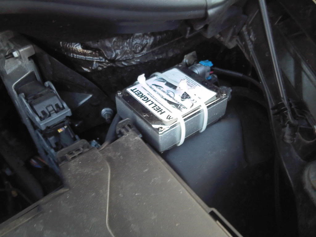

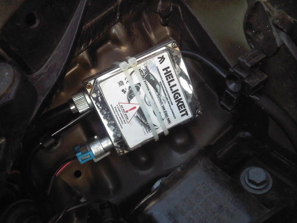

Can I ask has anybody got any pics of where they have mounted or the best place to mount there ballasts.

I just cable tied mine anywhere lol, not the tidiest but does the job!

Erm just behind the headlights!
In a mk3 tho so not sure how much room there is in a trophy!

haven't fitted the kit yet - that is what is on the original bulb, you place the bulb in those slots the put the bulb in the headlight and twist it to hold the bulb in place. I will have to remove the metal clip and cut the side to open it slighty to pass the wires through so then I can hold the hid in the headlight.
You can buy modded ones (just the side cut out) for £14 of web
