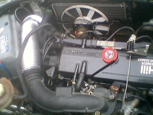

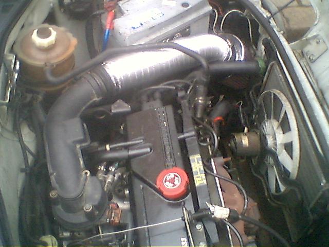

Right mate......
pics are here! the black plastic bit that comes off the throttle body is from a laguna, and i saw it pointless slapping a filter on the end of that. So i extended it with some aluminum ducting secured with some trusty jubilee clips!!
Then positioned in that small gap next to the rad! make sure u trim that plastic flap away or no air will get to it. one or two cable ties later and eh voila!
i heard about this from a mate and got my self down the scrappy. im sure it was a laguna of similar age as its the same engine. u will no when u see it anyway!
did make a diference pik up was better much smoother response aswel!
ur very unfortunate as ive just sold the hole kit in the picture!
hopw this helps u out if youve got any questions drop me a message!
cheers
Amir

Cheers matey,very helpful.
Found a laguna at the breakers today and its got the bit i need.Take it it holds on well enough with 2 bolts as thats how yours was fitted?
Be straight back down there tomorrow to swipe it :D
well its supposed to have 3 bolts but i only managed to get hold of 2 lol as the laguna a took it off only had 2. meant to go down b&q or sumfin to get one but neva got round to it!
best of look mate good bit of kit!
