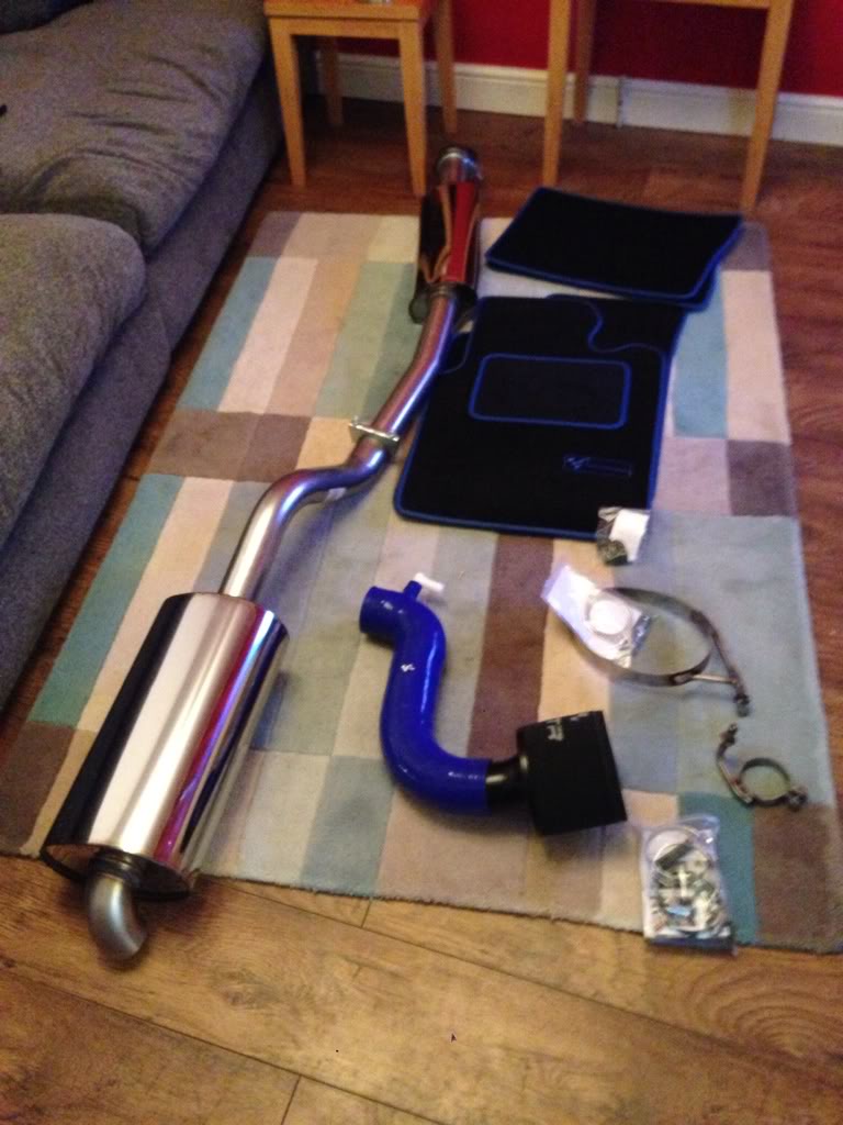

and inside . .
Fitted the Ik earlier and absolutely love it!
Im gonna be fitting the exhaust tomorrow (ktec stealth) along with a sports cat.
Just thought someone may have a method or tips on fitting? Ive bought new spring fitting kit, along with new centre mount and a powerflex exhaust mount to go in the rear hanger .
I have had the standard one apart and fitted it back togethor, just want to make sure i fit it perfectly !!
any help would be much appreciated. Cheers, lee
