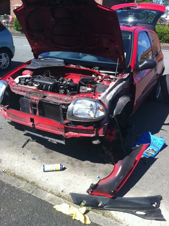

It's all plug and play mate, I'm 99% sure you have to remove the front bumper on ph1's. (You have to on ph2's).
http://www.cliosport.net/forum/showthread.php?240464-Clio-mk2ph1-Double-optic-(sports)-lights-conversion-guide
W
iring new Dual Optics up on your car mate.
As for the head light you have to remove the grill between the lights to remove the lights (2 screw and 2 clips) some are saying remove the whole front bumper but I must say its an absolute b*tch to do that lol...
