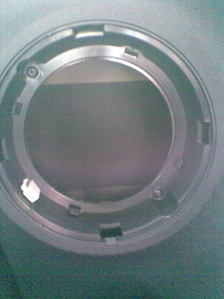

Heres a pic of what you're left with when the grilles off if it helps at all..

Got the grilles off now, cheers. For connecting the speakers, did you just remove the renault connectors and wire them stright in?

Thin flatheaded driver on the outer edge and you should be able to pry it off just take it easy though....
