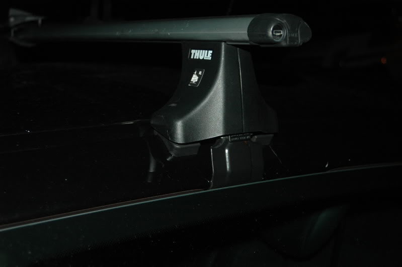

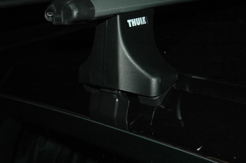

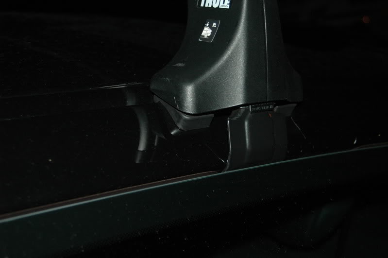

I have not got a closer pic but hopefully this should give you a bit of an idea.
  '03 1.2 Dynamique
Looking at your pics I am doing it right. I think I've found the problem the 760 kit isn't long enough (I assume it is for a 5 door), it's a 760/761 bar I need for front and back. The 761 is 4[SUP]3[/SUP]/[SUB]4[/SUB]" bigger which would explain.
Got to love websites that have the wrong info printed on them when buying kits!

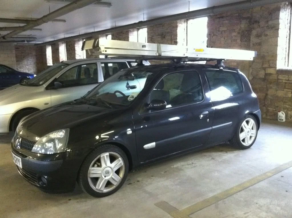

I got it on. Modified a bit of old 30mm square bar and gave it a coat of hammerite. Fits fine.
Problem was the length of the Thule 760, the kit I was sent was for a 5 door, not a 3 door.
