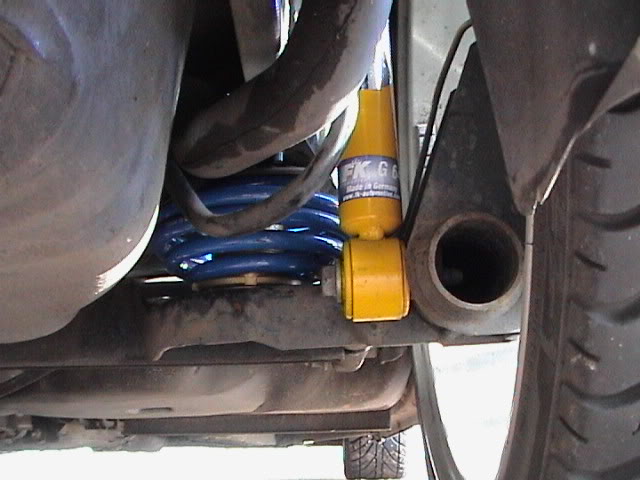

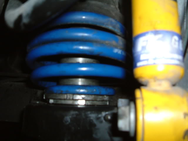

Trying to lower the rear of my car a bit more, i have loosend the two adjuster screws off with the sea spanners. im a bit confused as to which way i shud go to go lower, do i wind the spring up so its getting more conpressed or downwards so its at the bottom of the thread?
cheers
like this
wind it down
yep i had them custom made, thats as low as you can go in your pic
a little trick for you, remove the lower adjuster, that'll give you another 3-5mm
