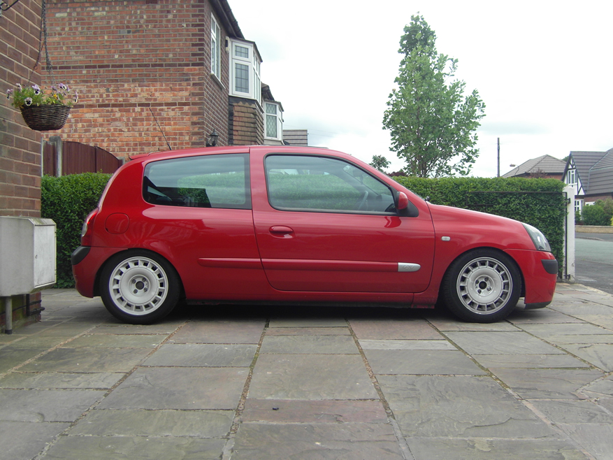

For reference to how low they go here is a picture of my 1.2, fronts could still go lower, however it rubbed at that hight due to the tyre profile. The rears were as low as possible minus the spring platforms.
Hope this helps.
