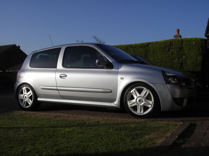

My old '72 on Konigs:
Personally I thought they were pretty good, got them on a groupbuy I sorted on here through Rimstyle though for £490 which was a good price (Gary @ Rimstyle maybe able to offer you a discount price). There was no issues that you'd not have with any other brand of coil for the 6 months I had them on it, usual tweaking issues after settling and the odd scrubbing but barring that IMO they are perfectly useable on the road if you're fond of a sharp firm handling motor.
No problems (regarding the back, I removed the rubber mounts and that gives you another 10mm or so of play to stop any coil bind).
Nope, all the way down means the bumper/splitter would be on the floor. Anything lower than that and it scrubbed with my 205's with passengers, and multi-storeys became impossible.
Back was fully down though.
