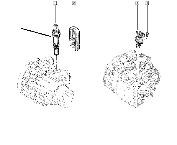

A ph1 172 uses a digital input sensor plugged into the gearbox ( JC5 089 ) it will either be the digital input sensor at fault or the internal speedo drive. Usually its the plug in input sensor.

just one thing, trying to source the input sensor through my local autoparts...
Would you have the Renault part code for the sensor? Or is JC5 089 the part number?
