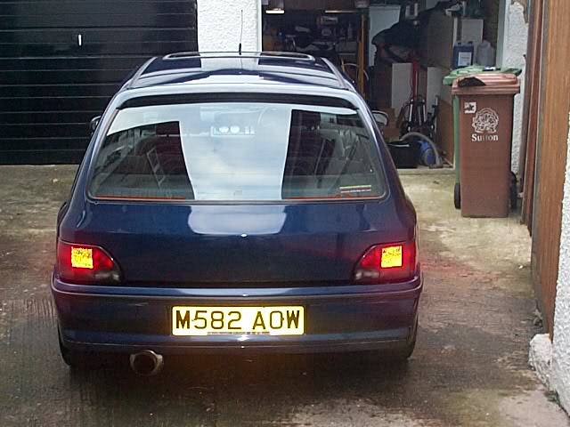

Hi all im looking to flush my tailgate, i need to get a door popper but i would like to put the button on the exterior of the car if its possible or have it remote, if a button, somewhere stleath would be best..i dont like the idea of wiring it up to my rear wiper..
Would be very greatful of for any help and advise or ideas and where and what gear i will be needing.

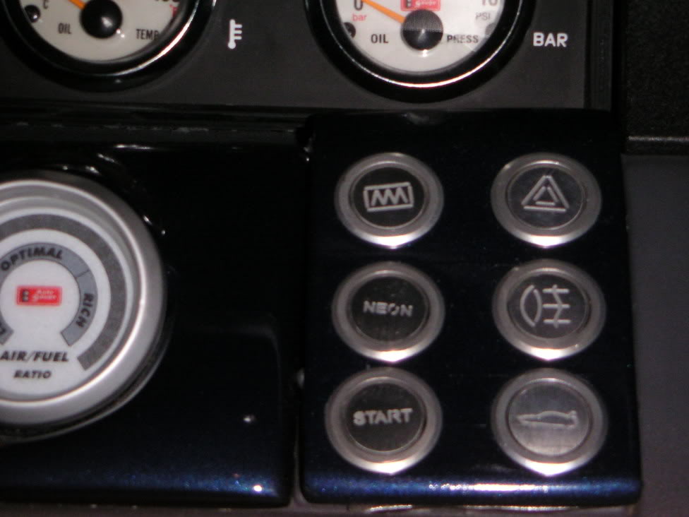

Just get a spare switch and put it in one of the blanks and wire it to that. You don't need a door popper just turn the standard solenoid that activates the lock round so it activates the catch.
Matt
you mean like this???
ignore the neaon button, this is very long gone................
How do you get the wire from the boot to the front? I can't see a way to do it without going through the rubber wire guide thing near the hinges?
Yep thats what i want it to look like only thing is mines is a 2003 model..Would i still be able to turn the standard solenoid around and use it?
