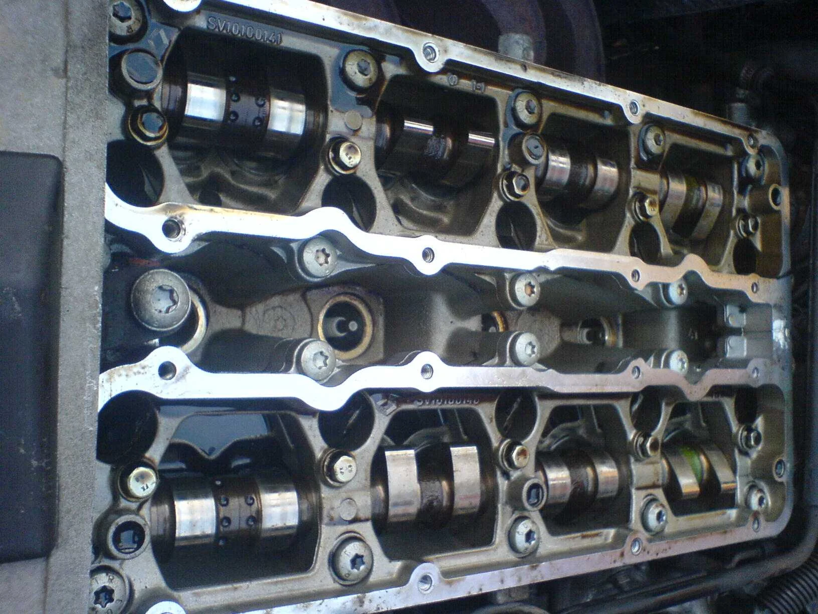

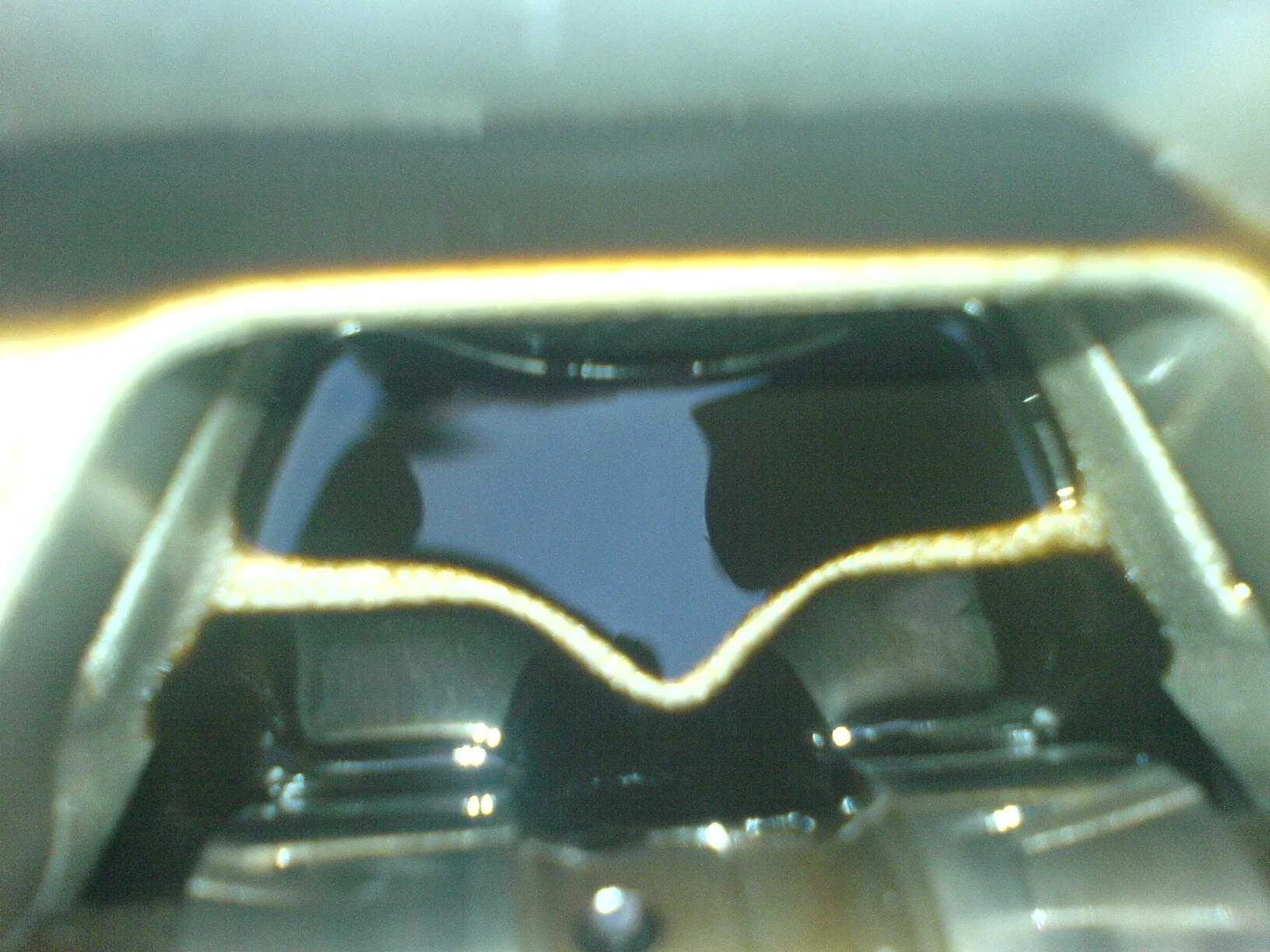

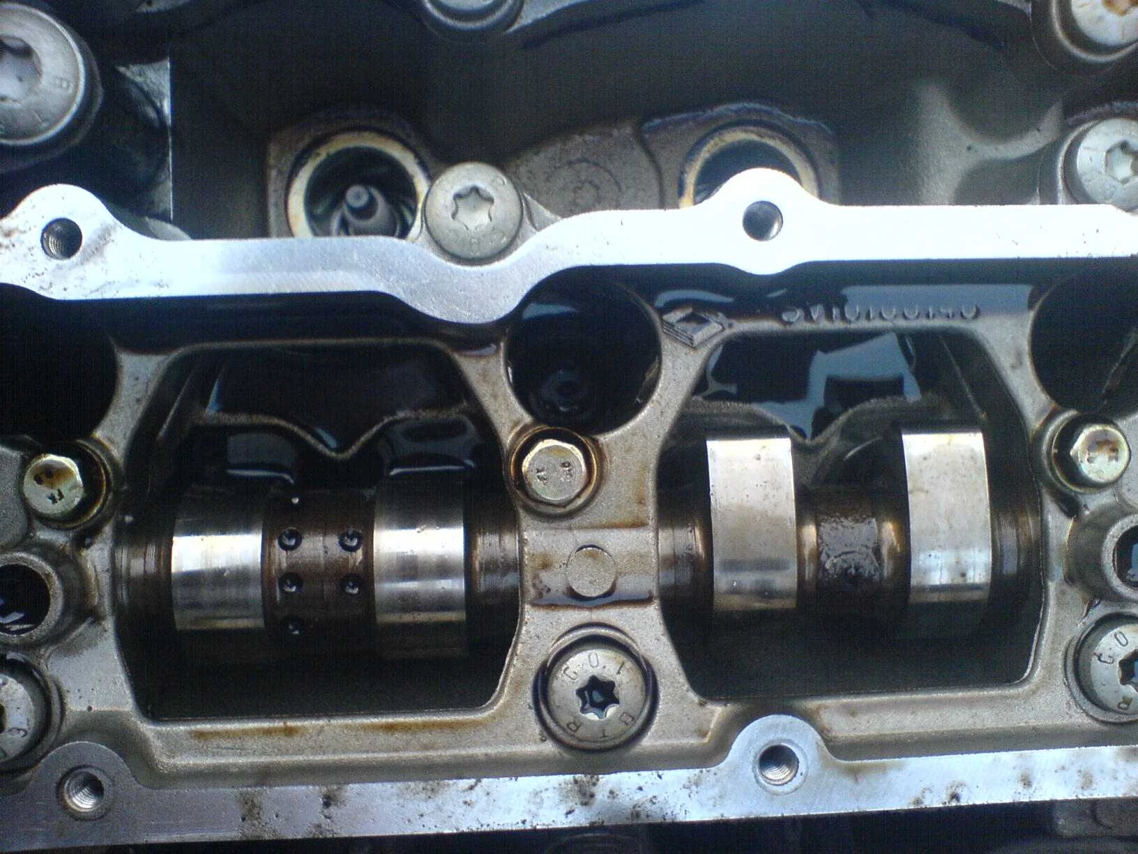

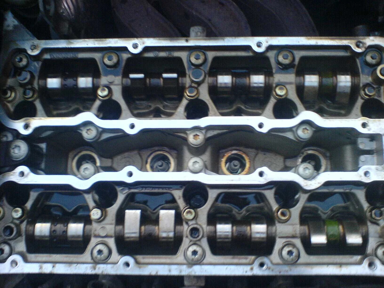

Had the top of the head off earlier, oil doesn't look like its had any water contamination? Took some pics maybe some could confirm, or can you not tell?
Pics are pretty big so click and zoom in!

Whether there are signs of the HG failing showing up in the oil depends on how the HG has failed. As there is no water/oil contamination its seems as though the gasket has failed between the cylinder bores and waterways, hence no oil contamination. Is there any white smoke out the back?
No white smoke and I topped the coolant up sunday before going for a longish drive and went to work monday and today and the coolant hasn't gone down at all? :S
