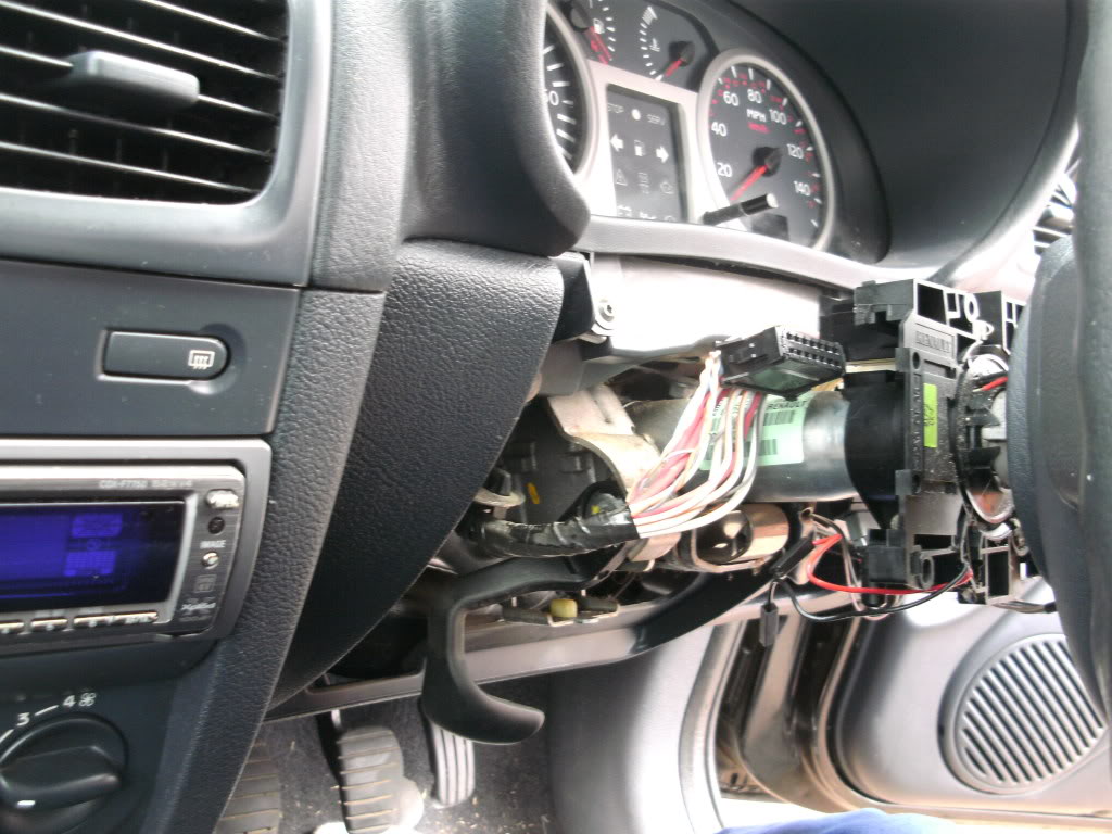

Brought my first clio a month or so back, and had notice that the front fogs didnt work. But when i switched them ''on'' nothing happend but when i pulled the indicator stick towards me slightly they would come on :S
so my first thought was that its a loose connection. So today i finally decided to take a look and sort it out.
So i took the ''shell'' off and this was the result:
sorry for the crap pic wasnt really a good angle for it :P

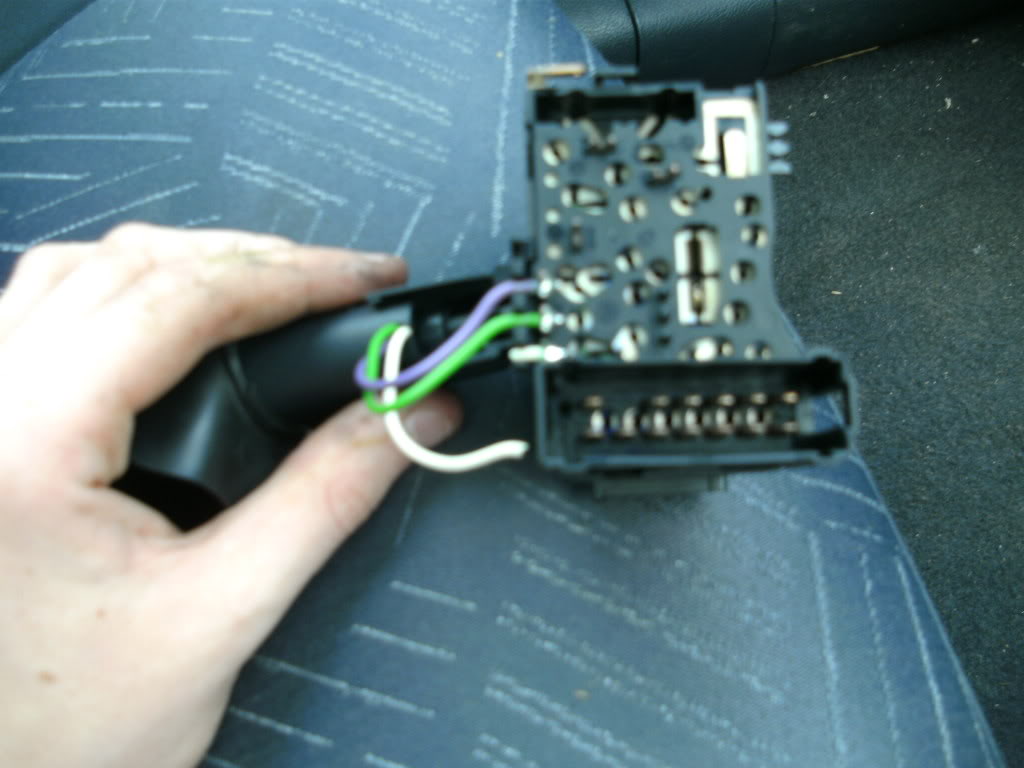

so i unscrew'd the two screws holdin on the stick and it pulled straight out:
And as u can see, the fog light wire had totally snapped (white wire).
Solution:
strip back the wire and just solder it back to where it should be.
put everything back in
Sorted.
