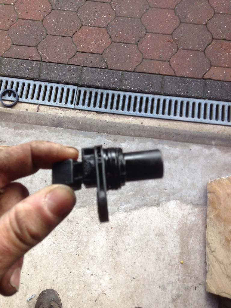

1st up was the Cam Position Sensor. I noticed I had a lot of oil around the coilpack area and down the side of the gearbox. I removed the sensor to find there was no seal on it....
Untitled by Jonff1, on Flickr
bought a replacement, fitted it and the the oil leak was rectified.

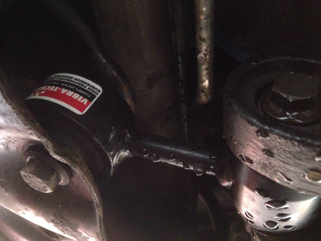

Next up was the lower engine/Torque mount, after messing about with the powerflex mounts, I decided to abandon that idea and went for the Vibrtechnics option instead
Reduced a lot of engine movement and the gear changes feel alot more crisper.

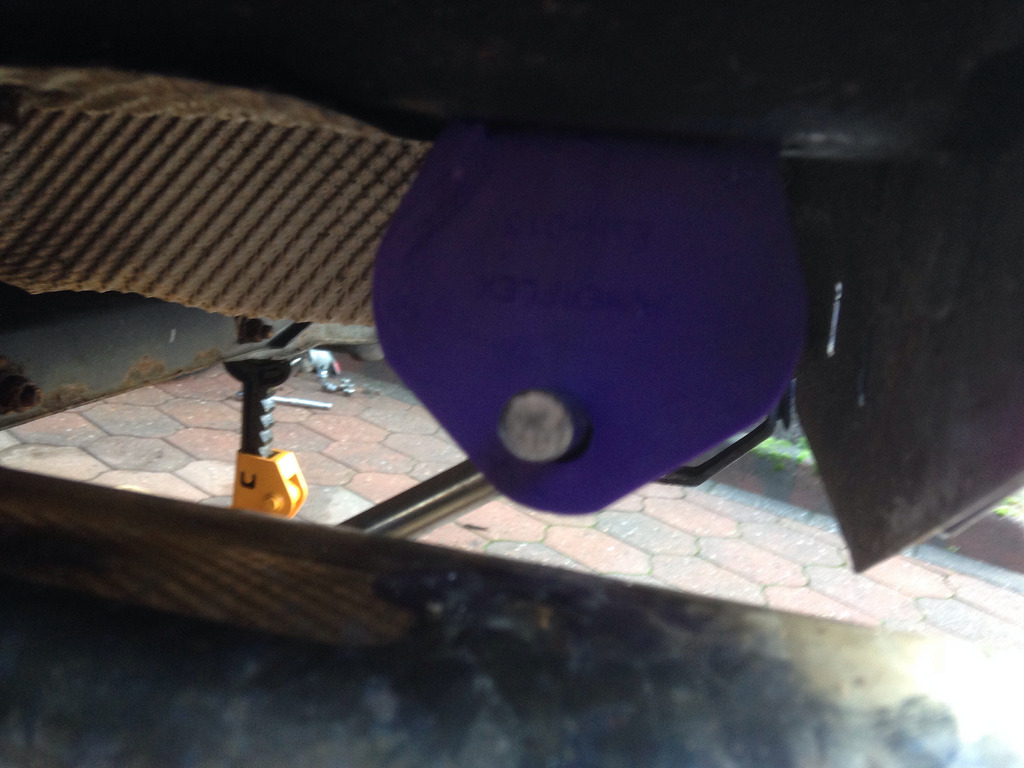

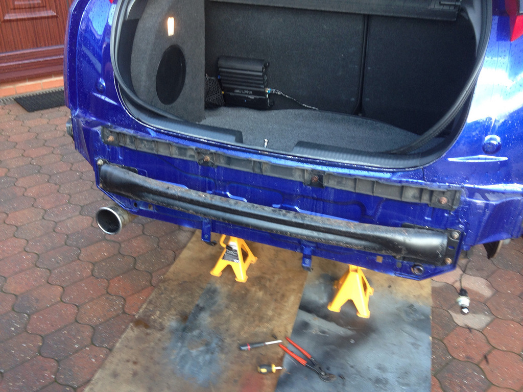

Then it was the exhaust mounts, decided to replace them with poweflex mounts as the old ones were a little saggy and once warm I was getting too much movement and causing the exhaust to hit the underside of the car during cornering.
1st off rear bumper removed to allow access
Powerflex fitted
I thought my turbo was leaking oil
bur i traced it back to the cam sensor too, few pence for a new O ring and jobs a good one,

Yeahhh it made a right mess underneath, oil everywhere and it looked like something had exploded lol. Thankfully it was just the sensor.

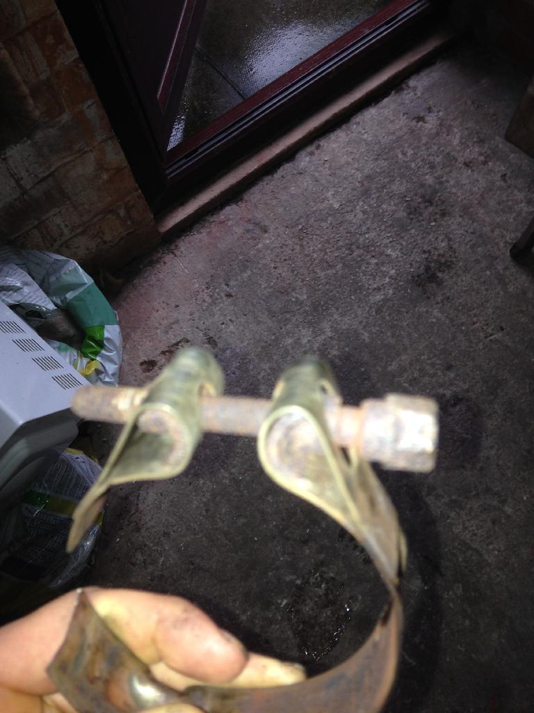

Next up was to drop the oil and change the spark plugs
Found this while doing that, so bought a new one and replaced that too

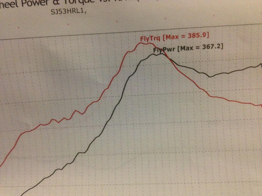

This is one of the powergraph after it had been on EFI RR, making plenty of power and torque

That graph still makes me laugh. We were thinking closer to 290 iirc. How wrong we were.
Indeed lol, it even had Chris doubting the calibration of his RR

Tbh the power has been pegged back a bit since that RR, wound the boost back a little bit via the adjustable actuator to make it a bit safer. Needs to go back on the RR to see what it's making now but I'd predict around the 330/340 mark.

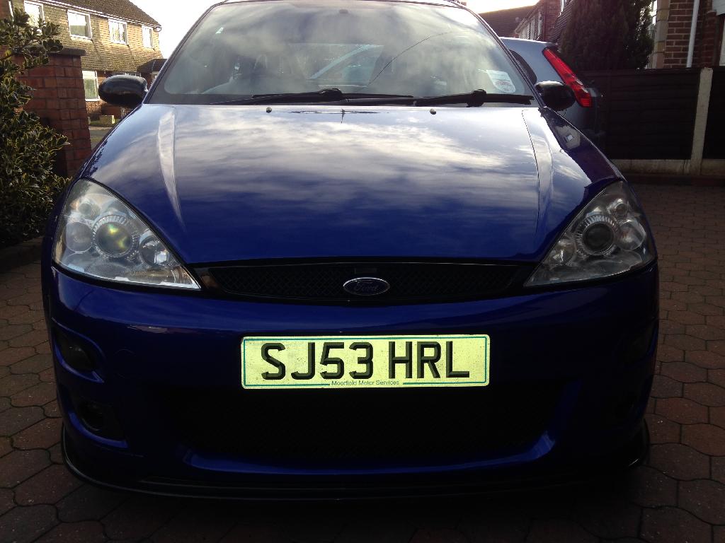

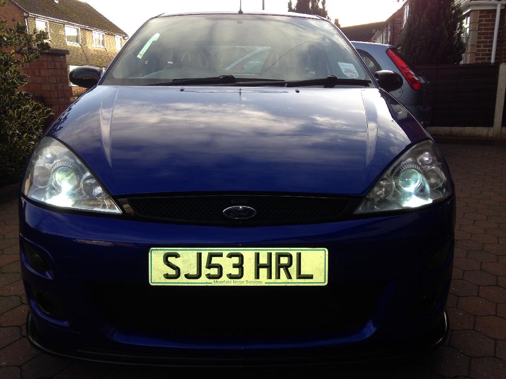

Decided to buy and fit some ST170 xenons, I'm still a little unsure about them as it looks a bit too busy inside the headlights, I still do prefer the look of the standard headlights but the beam pattern from the xenons is far superior.
Couple of quick (s**t) photos of them fitted.
I've ordered some Ferodo DS2500s from G172 on here, they should be here fairly soon and will be fitted ASAP.
They give a nice beam and they look good, what's not to like?

Now I've wound it back it's peaking at 21/22psi and holds around 19psi, originally it was peaking at 25psi and holding 22psi but it was dangerous in that state hence why I wound it back.

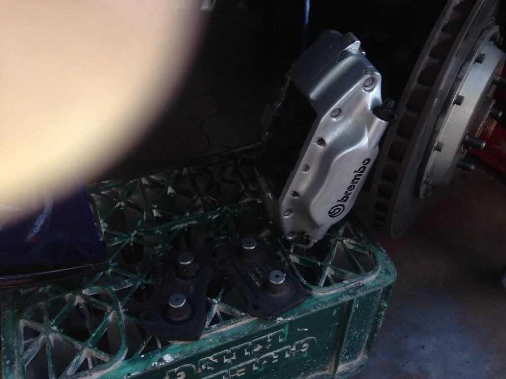

So I cracked on fitting them as the previous brake pads fitted are pretty poor IMO.
What should have been a 40minute job max turned in to 2 hour job. The anti-squeal shims needed removing to fit the DS2500 pads and of course they were held on with torx bolts that were rounded off. Was a right pain in the arse trying to grind them off inside the caliper with it still attached to the brake hose. Access was poor and had to be careful not to burn the seals on the caliper pistons.
Well worth the effort though as the brakes are 10times better.
Good to hear Jon :approve:
Bed them in as per instructions in box (if you haven't already mate) to get the best from them
Cars looking good and it bet it goes well by the power it's putting out!
Aye already bedded them in last night mate ;) lol and yeahhhh needed the better to help stop it better with the power it's got.
