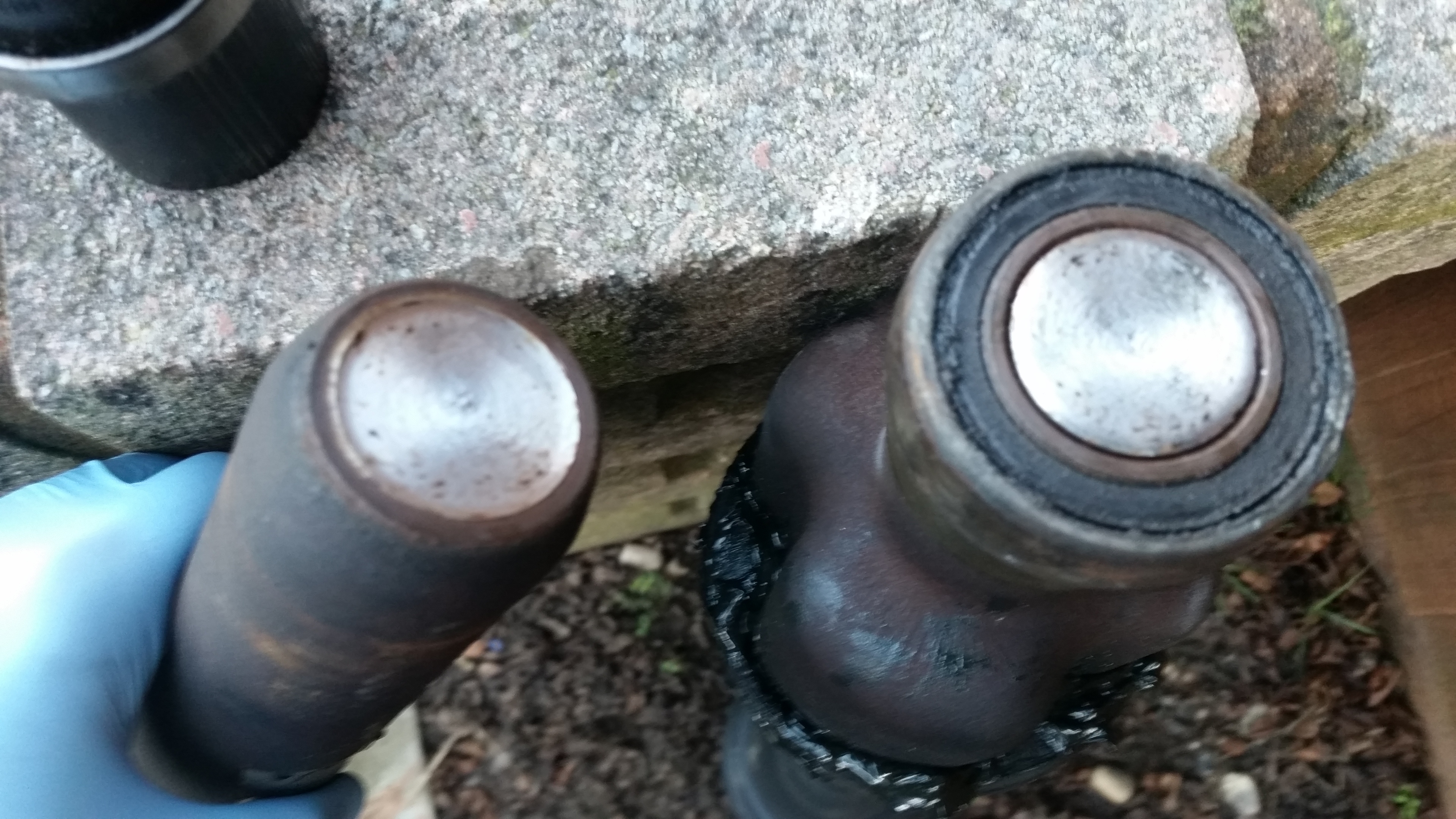

Yeh quite high 411bhp and 485nm torque, gave it a little bit of spin on the way to the line then it broke as soon as i launched it, its not fun being pushed back down the strip!! quite interested in what you have done for the oil and coolant temps, mine was seeing 120c for the coolant on the scan gauge at ford fair and i was running it a low boost in fear of doing damage.
Pic of broken shaft, broke on the joint from the half shaft
Lol proper job that, bet that made some noise when it went.

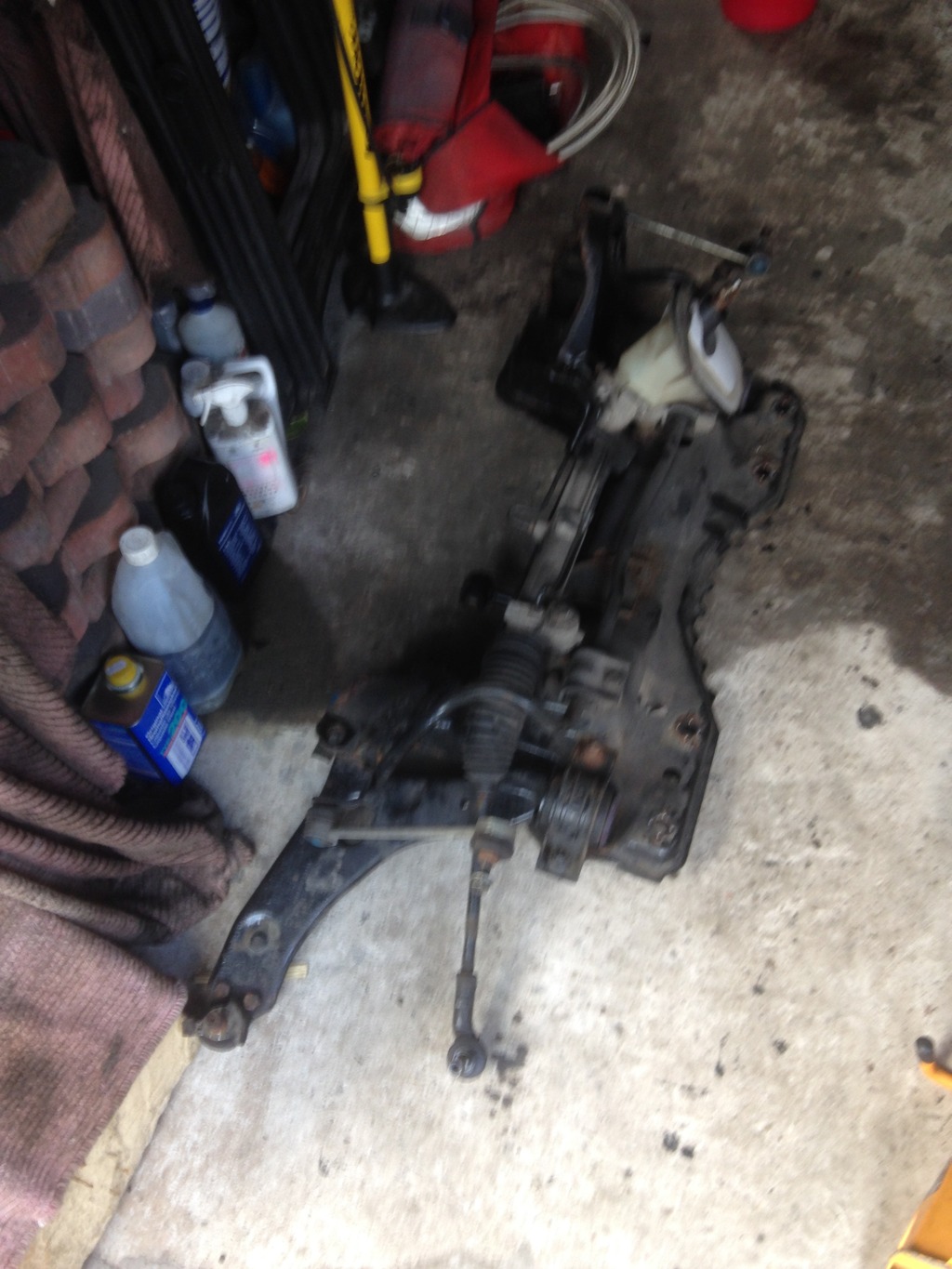

Just before Oulton I was getting a knock from the steering when I dry steered it with the engine off, early signs of steering rack failure. I risked doing Oulton as I didn't have time to sort it then but did plan to do it shortly after. To be fair the rack has done 100k+ miles so it's done pretty well.

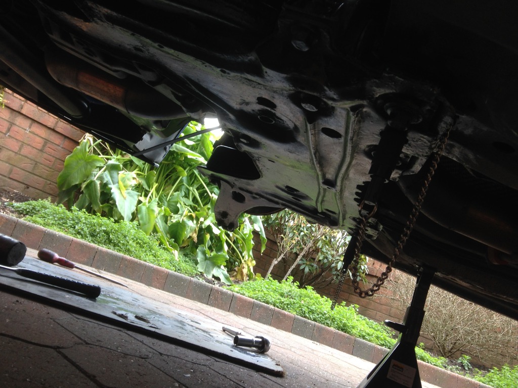

To make life easier I just dropped th entire front subframe (some weight in it which surprised me actually)

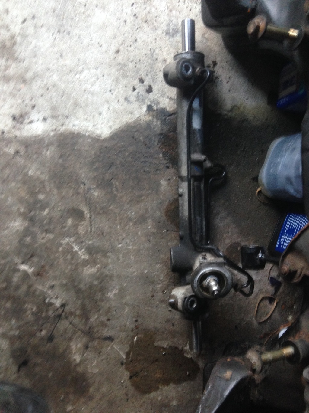

rack removed and tie rods detached

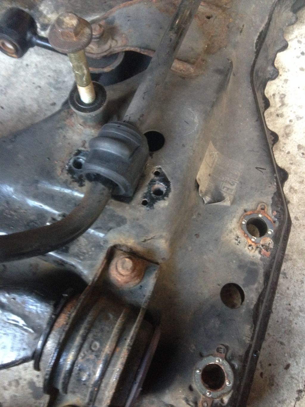

Thought I may as well replace the ARB bushes while the subframe was down

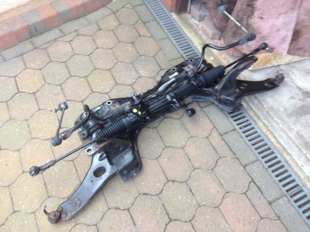

quick degrease of the subframe and I bolted the rack to it
Then I bolted the subframe back on to the car via the alignment pins to get it central
This turned out to be an absolute pig on my own lol. Trying to balance the subframe on the trolley jack whilst lifting it up isn't really a 1 man job so it took a few attempts but I got there in the end. Managed to get the rack perfectly central 1st time too, steering column and rack lined up perfectly on the 1st attempt :D

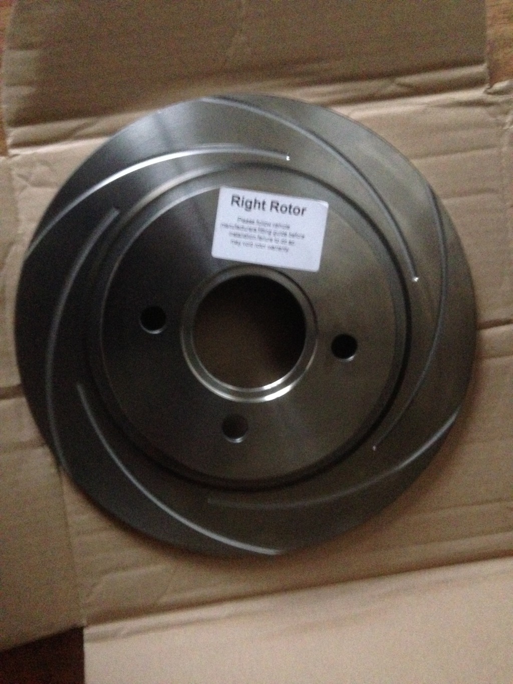

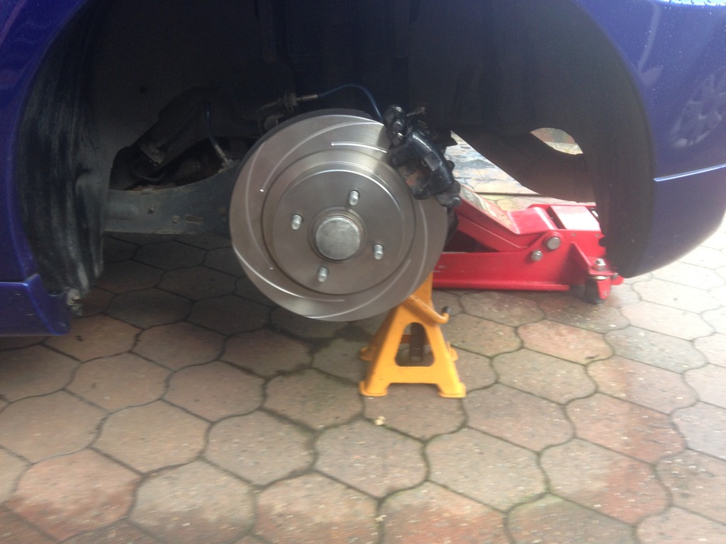

Replaced the rear brake discs too as the old ones were starting to get tired

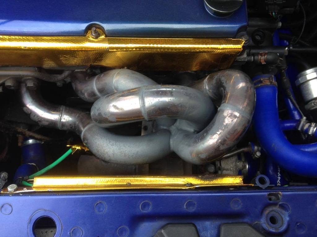

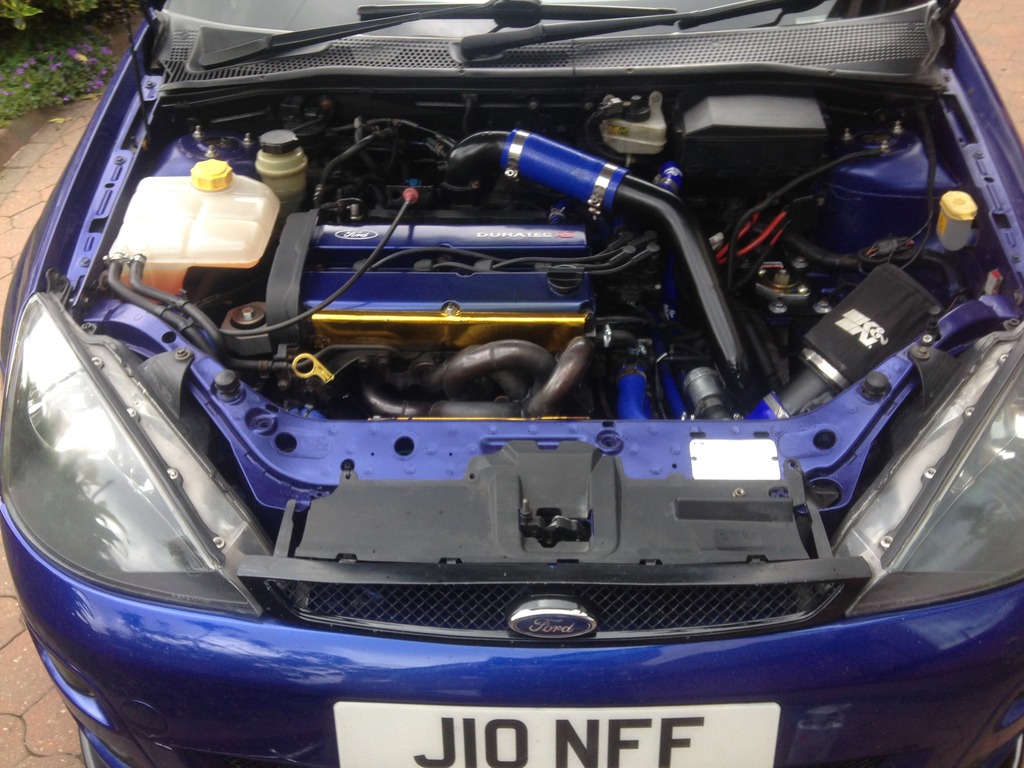

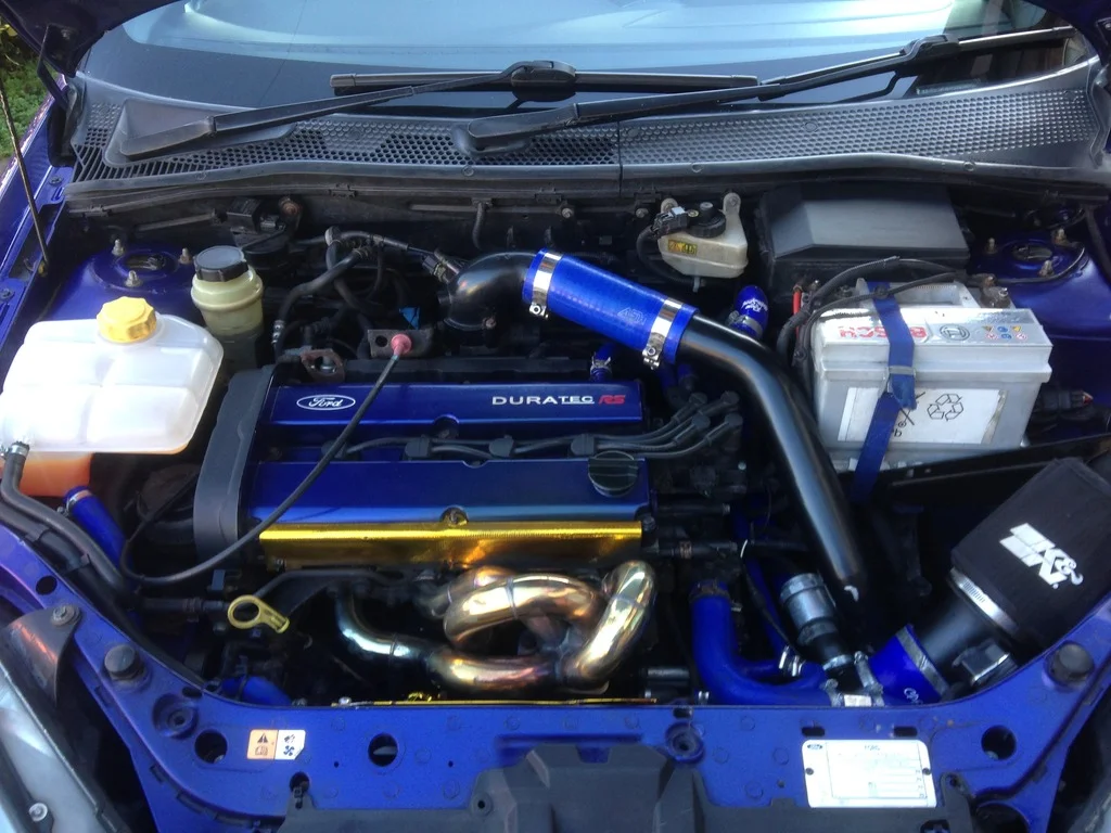

Well the Direnza Manifold turned up so I cracked on with fitting it. Quality isn't fantastic and the flanges are definitely not perfectly flat but thought I'd test fit it anyway just to see how it fits.
Went on relatively easily, turbo to manifold studs/nuts are more awkward on this one but it's actually easier to fit overall than my old one. At 1st I found the chrome finish a bit much but after a blast it dulled down a bit and it has more of a gold tinge to it. During the test run the car is noticeably more responsive, still boosts the same but the it reacts quicker to throttle inputs, even the exhaust note on idle has changed. Will have to see how it gets on but for £120 I can't complain so far as I'll be honest, I expected it to crack as soon as I exerted any heat through it.

Iooking good! Loved the change the tubular gave on mine,
Got loads of little niggly bits i need to sort on mine, buts its too cold and im too lazy lol

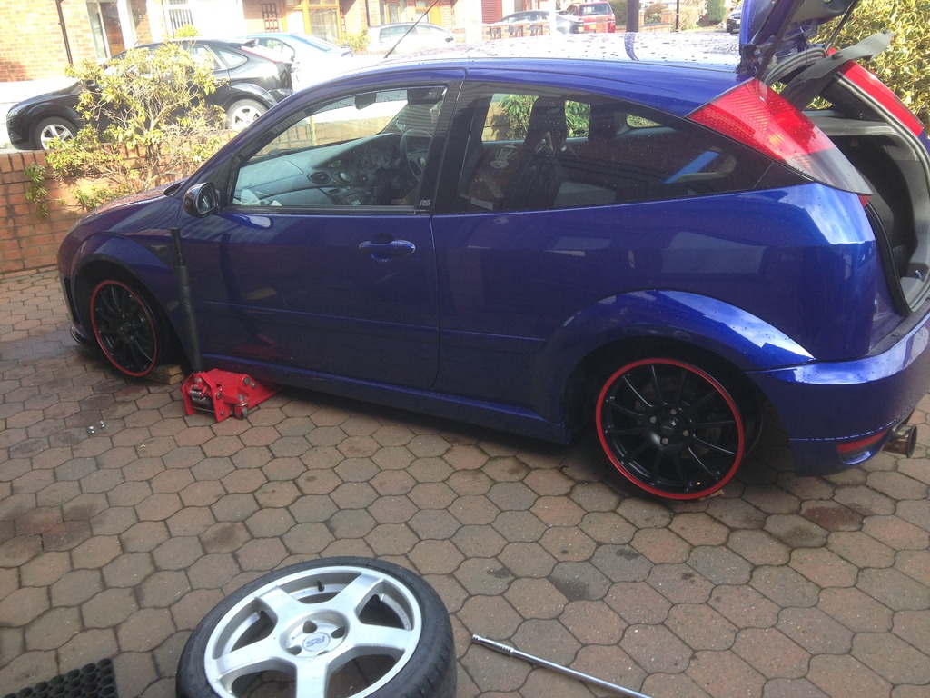

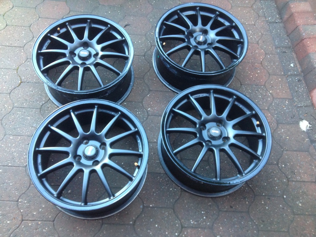

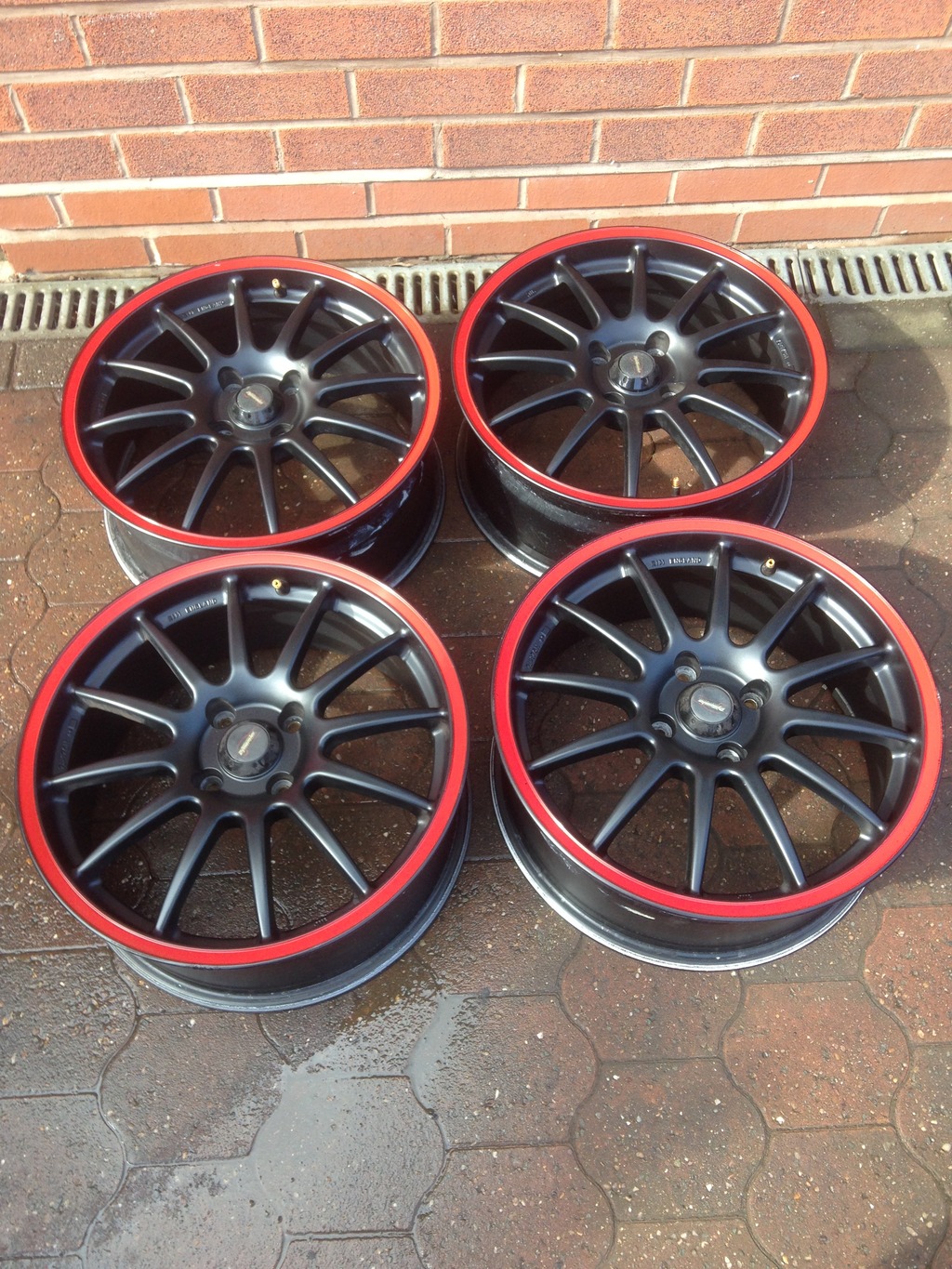

I managed to cause some heavy wear to 2 of my RSRs so I've decided to sell my ST wheels and all 4 RSRs and opt for something else, bought another set of TD Pro-Race 1.2s but in 17s this time and I've just ordered a full set of Pilot Sport Cup2s to wrap them in.
I wasn't too keen on the red lip so I just painted over it with a bit of black paint.

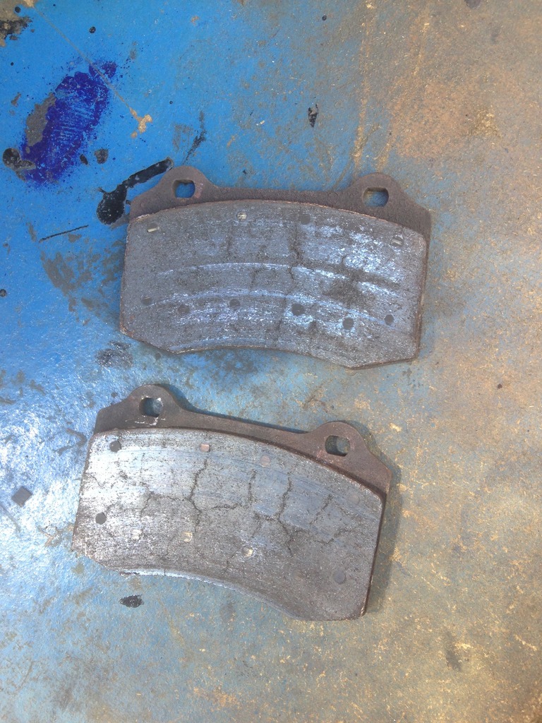

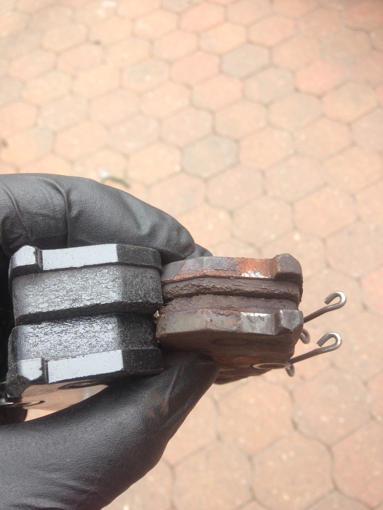

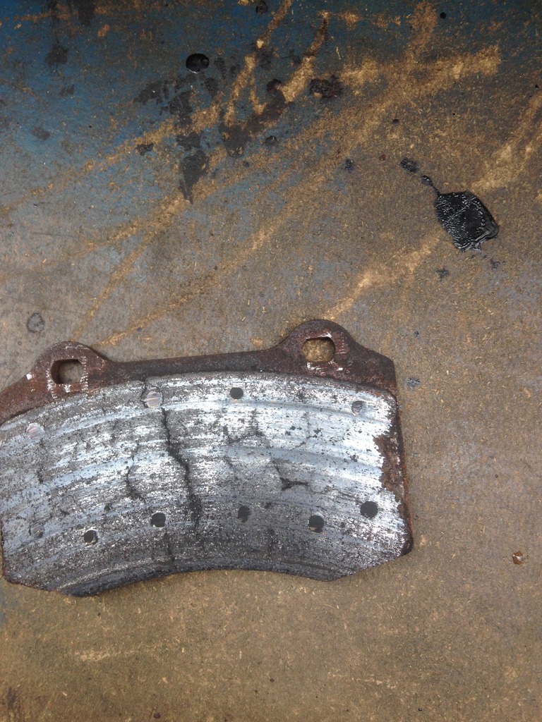

Literally days before Anglesey I found my front brake pads were knackered lol. My own fault for just assuming they were ok.
So it was a rush job to find replacements, fortunately I did but I had to use CL RC5+s instead, turns out they're nearly on par with the RS14s but £100 cheaper so I'll be sticking them from now on.

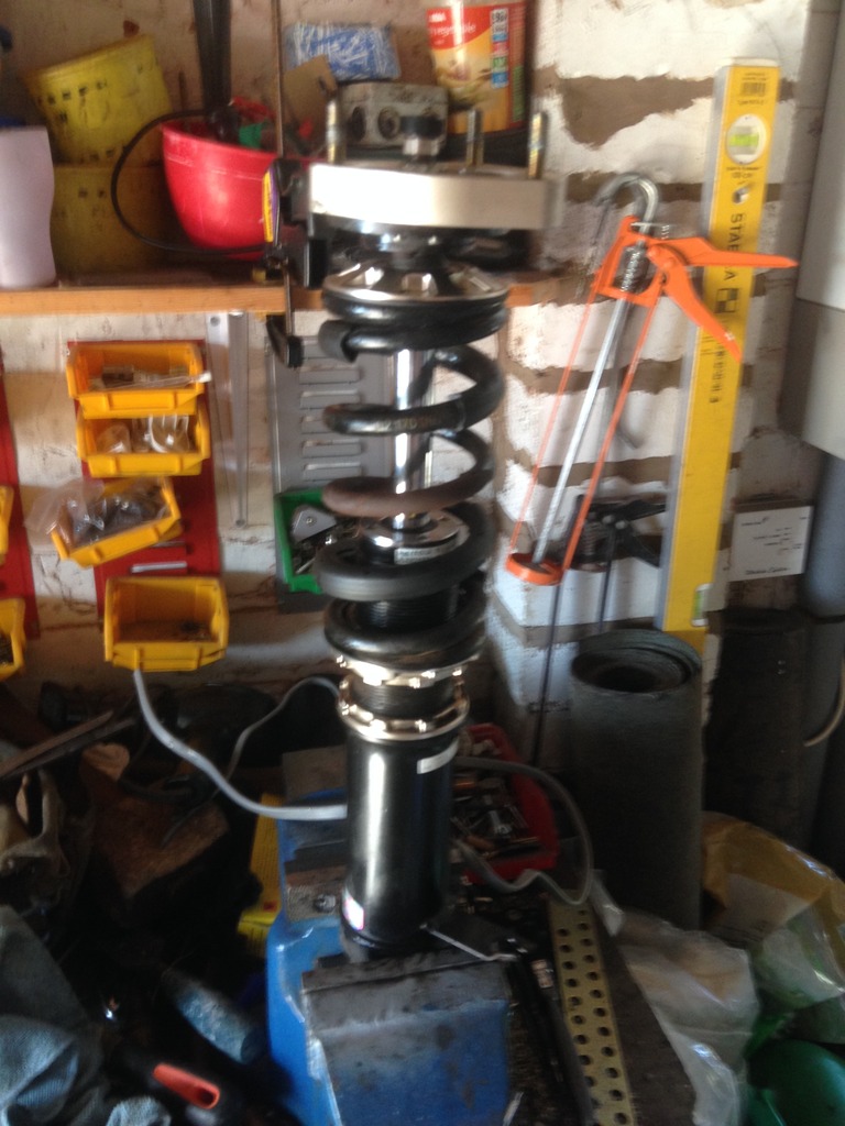

Once I got home, I decided to investigate the handling issue, took the front shocks off and dismantled them.
Both were perfectly fine and have faired pretty well after 2 years use, apart from a bit of corrosion on the springs they still look solid and damp perfectly. Rear shocks are fine as is anything that could cause understeer so I'm still clueless to what it was. It's either the Cup2s I was using or my car really doesn't like Anglesey lol.

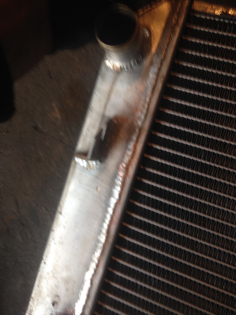

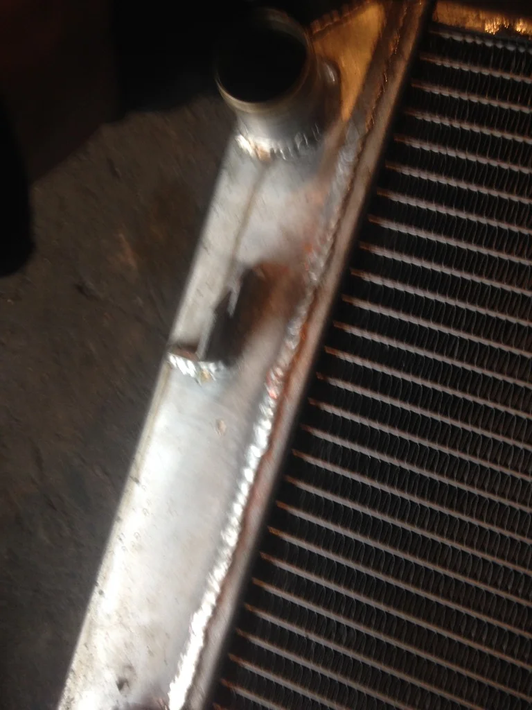

While investigating I found a leak on my ally rad.

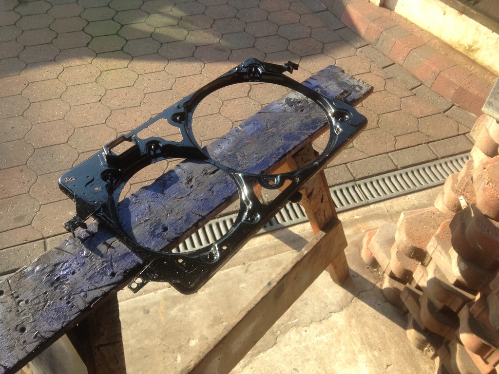

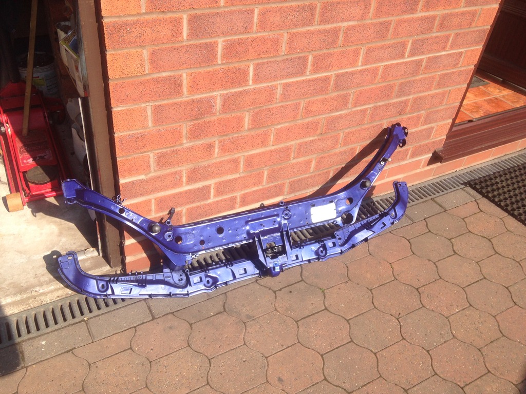

So while that was off being welded I decided to clean up the fan housing and slam panel and give them a lick of paint to tidy them up.

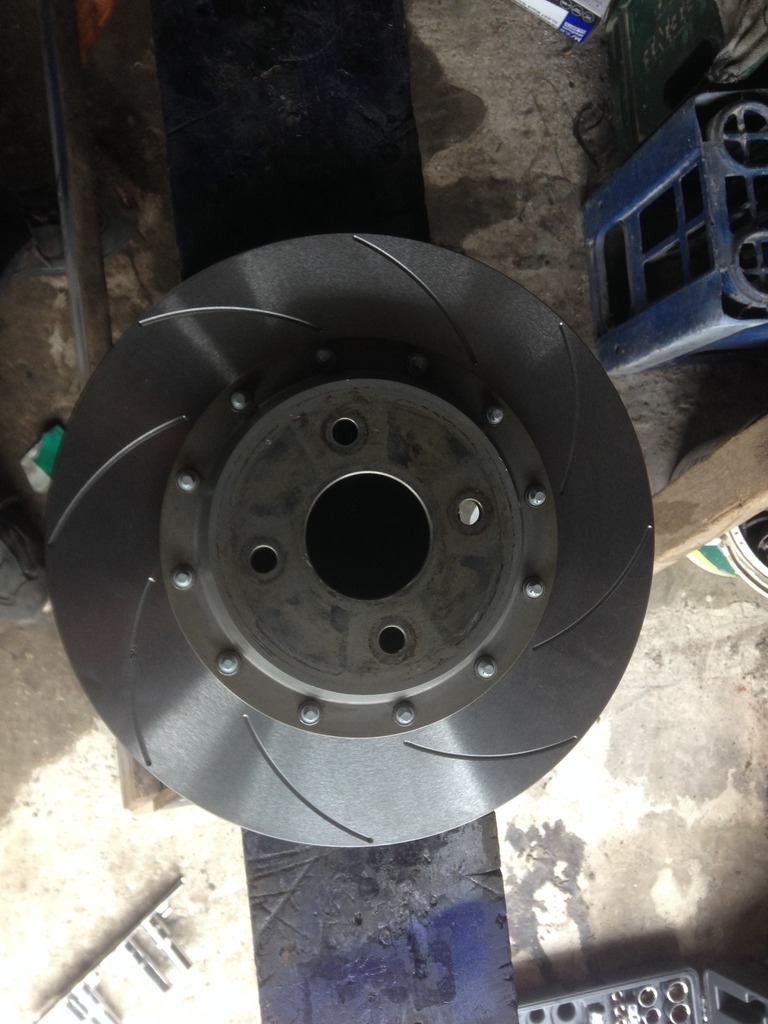

I've also replaced the front brake discs and rear brake pads, both severely worn after many trackdays lol.

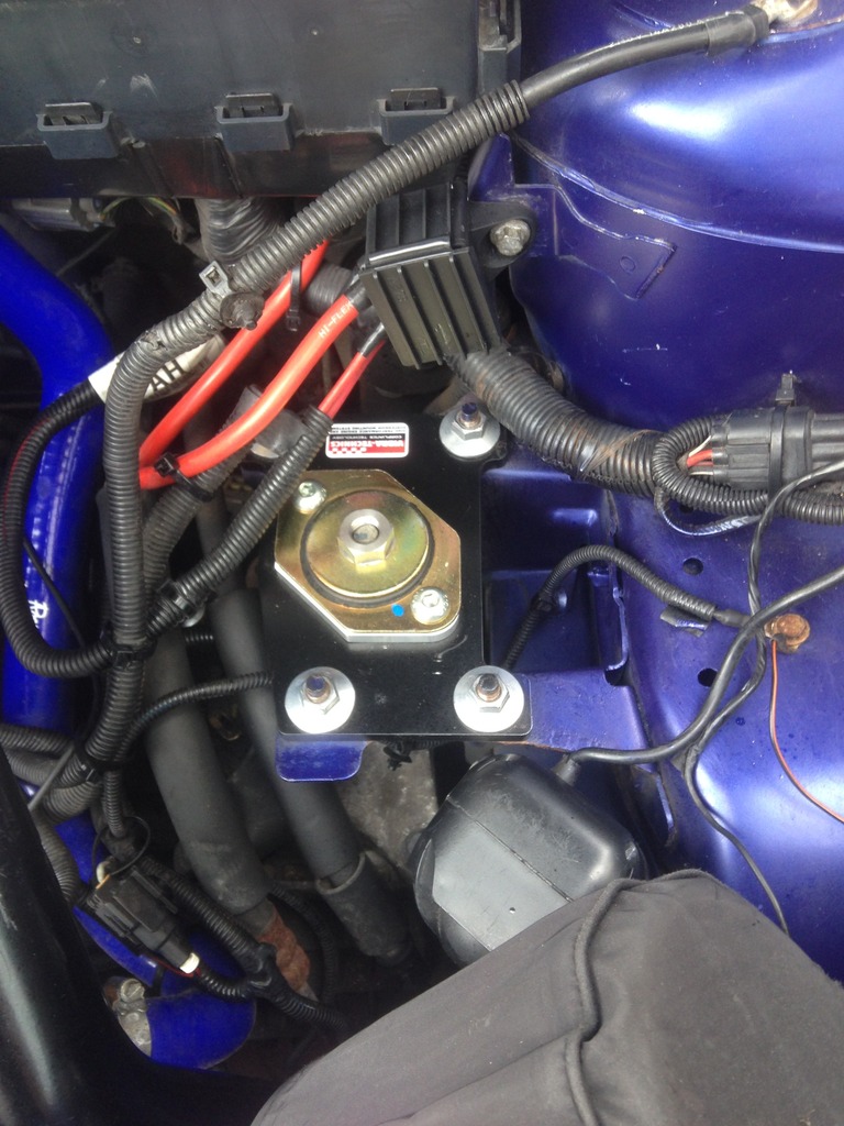

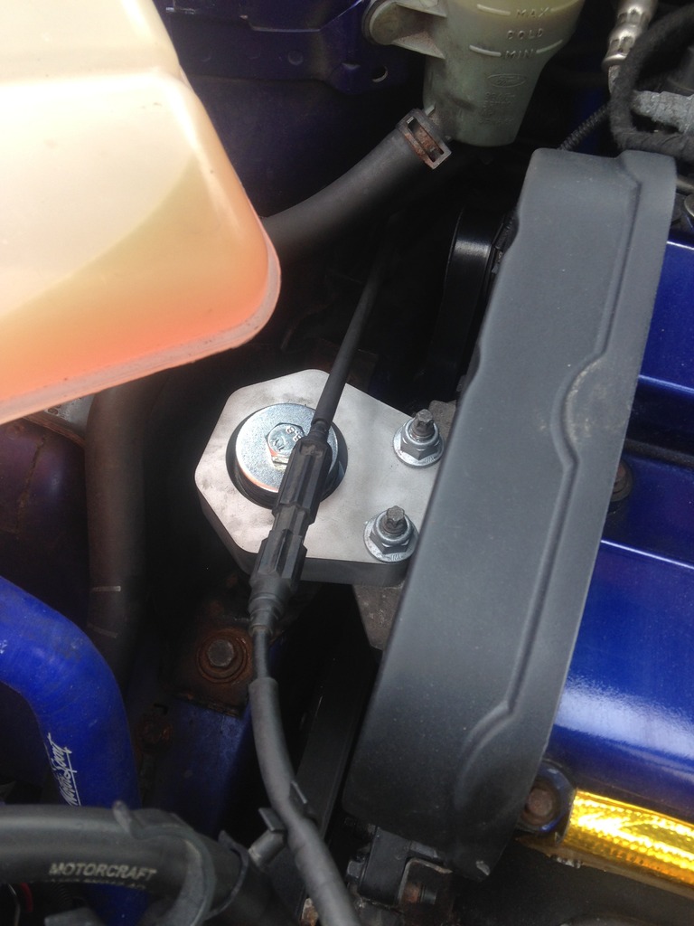

Got a pair of upper vibratechnic engine mounts at a reduced price in a group buy so I've fitted those too.
What a difference these make, engine isn't swinging around like a pendulum in the engine bay anymore and gearchanges are far more crisp and easier. Well worth it.

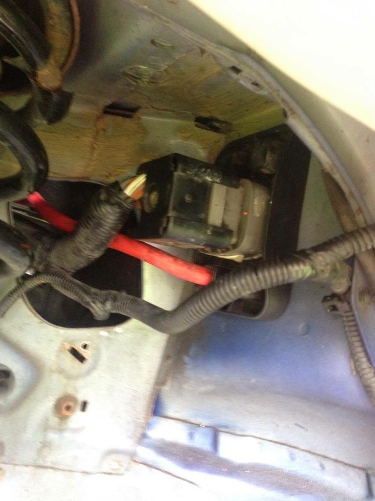

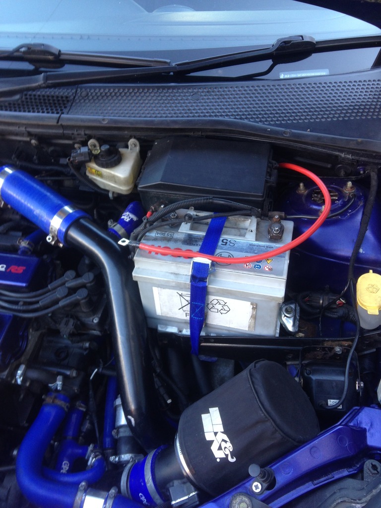

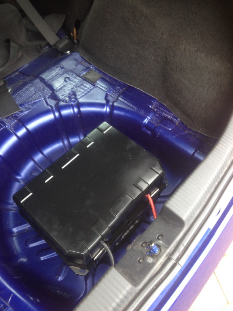

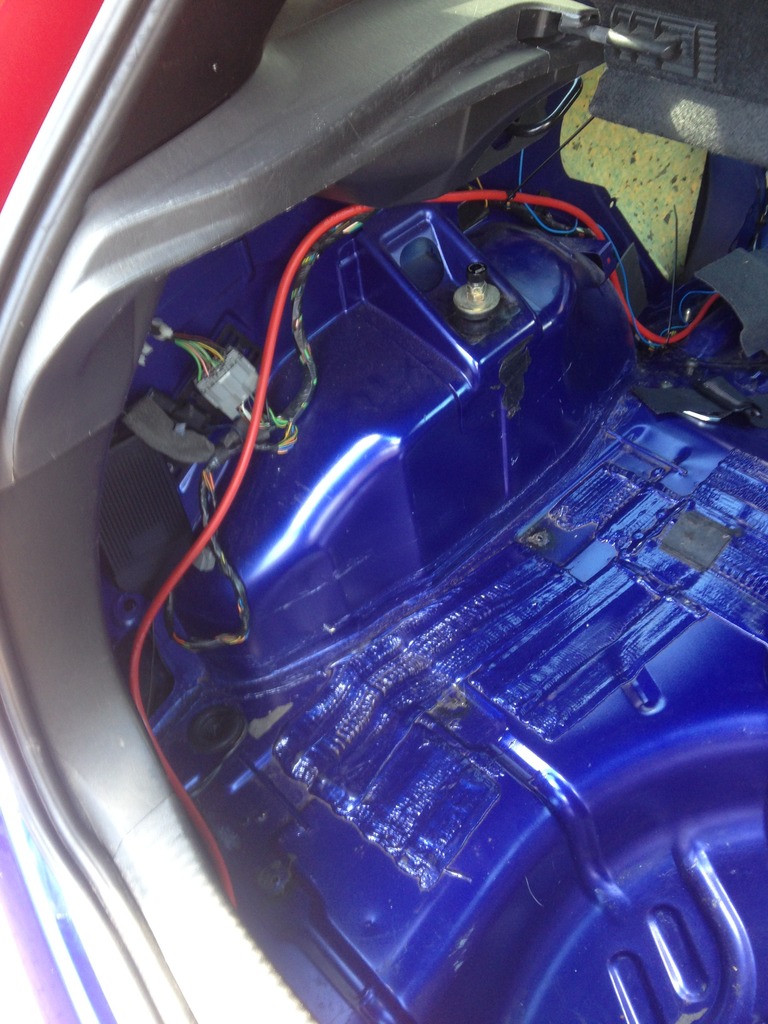

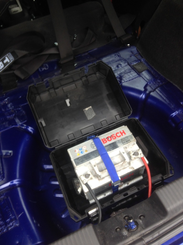

Next up was relocating my battery in to the boot.

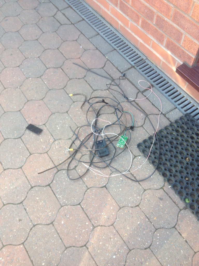

while I had the trim removed so I could fit my power cable, I came across alot of random wiring, I can only assume it's for the ST170 sub the previous owner fitted but there was an awful lot of it so all that got chopped out.
I then set about laying the cable down to try and keep it out of the way and as neat as possible.
Then I set about fixing my make shift battery box to the boot floor, it's bolted from underneath in to the battery tray which the battery sits on inside the box, it's very solid and won't be going anywhere.
Nice and tidy.
With the battery out of the engine bay I have the bay a bit of a tidy up, 1st time it's looked properly clean now there's not a big dirty battery sitting there lol

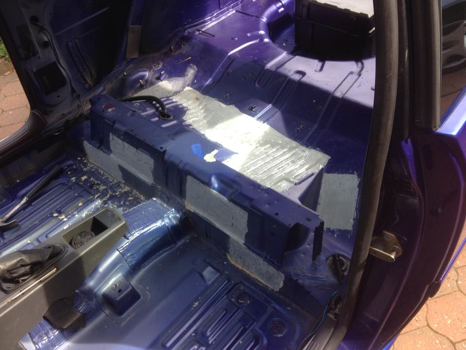

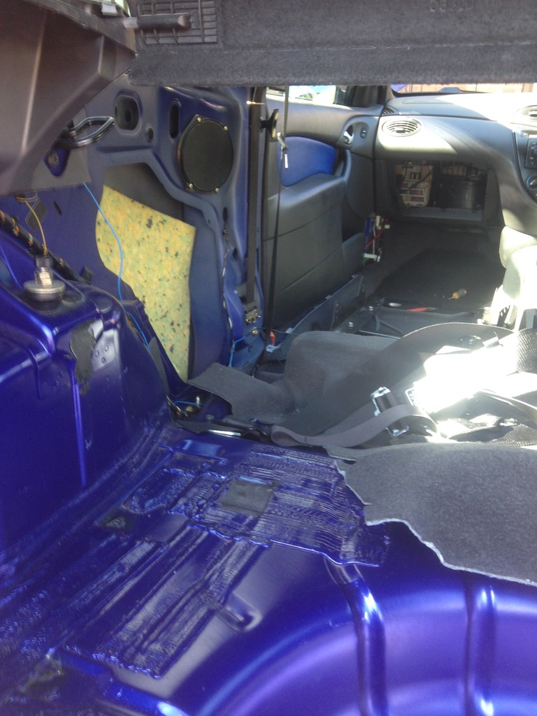

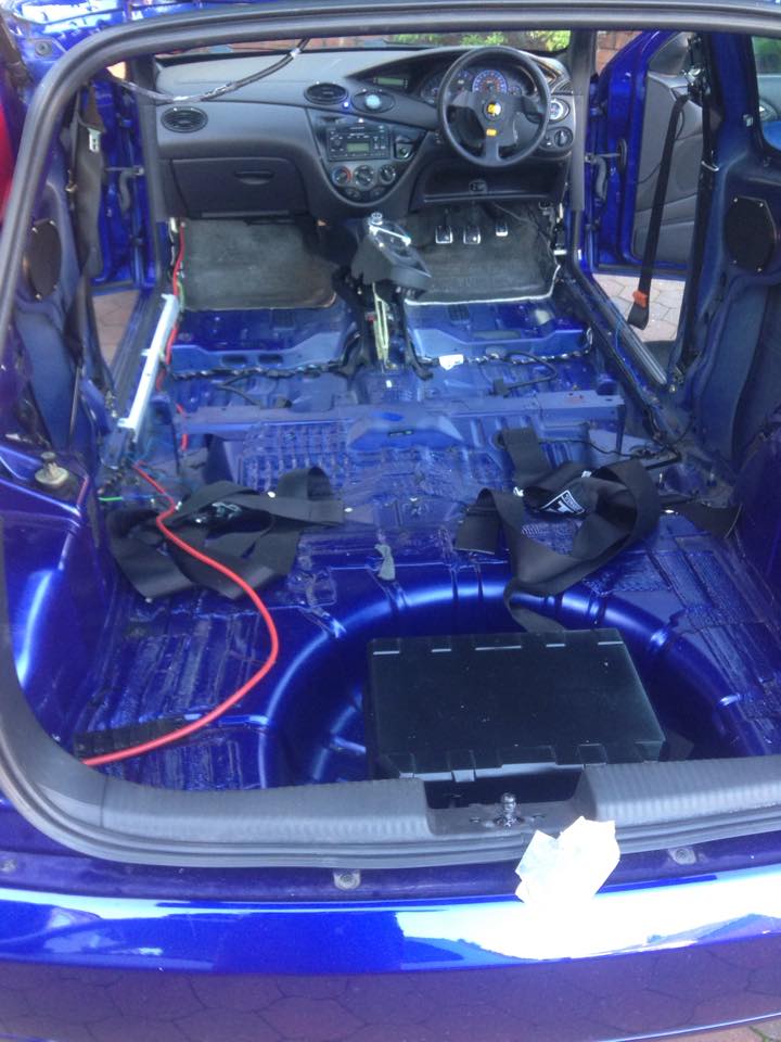

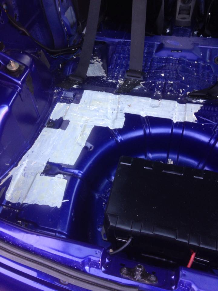

I've decided to go for a more track biased approach with the car now as I barely use it on the road anymore, I said I'd never do it when it was mentioned to me but I've pulled out the rest of the interior.

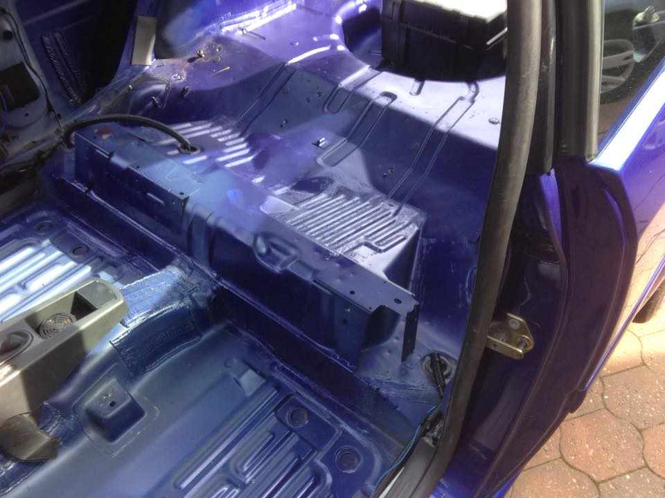

Then I started pulling out the sound proofing
Then I just rattle canned over the exposed bits with some IMP blue paint from Halfords.

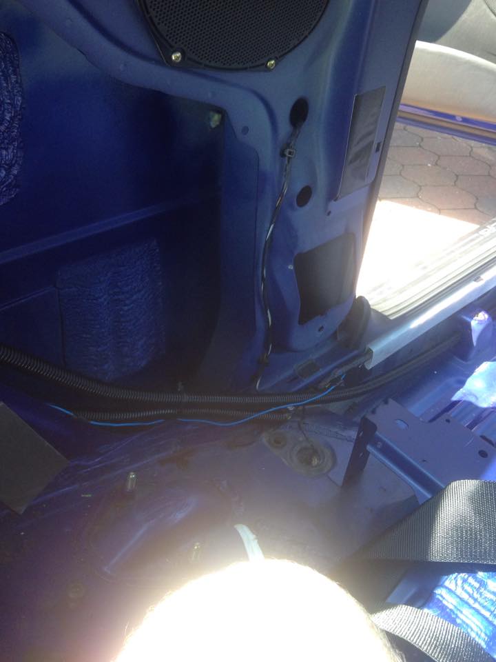

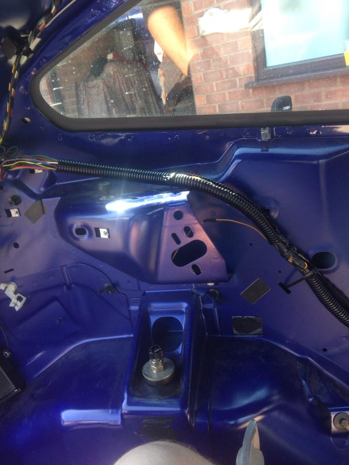

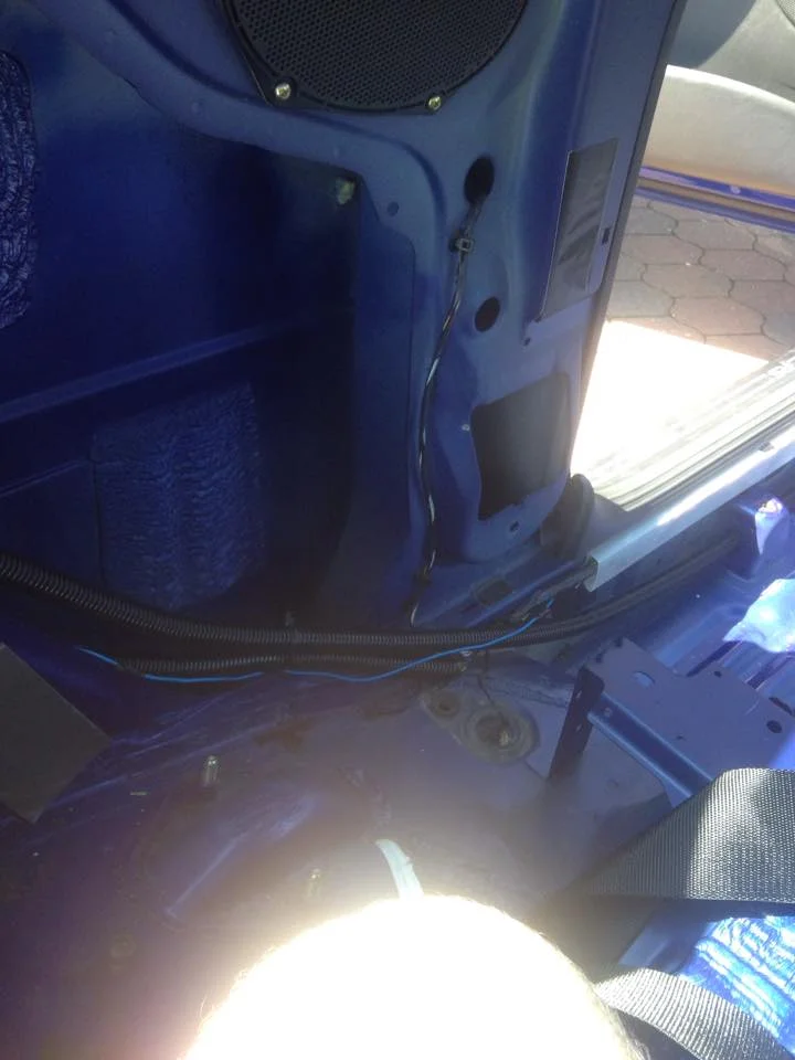

I wasn't happy with all the wiring being exposed, looked really untidy too, So I set about tidying it up a little
I did have far more pictures of the job but I smashed the screen on my phone and subsequently lost the majority of the photos unfortunately. Car definitely feels more lively with pulling out the rest of the interior, I was quite surprised really.
