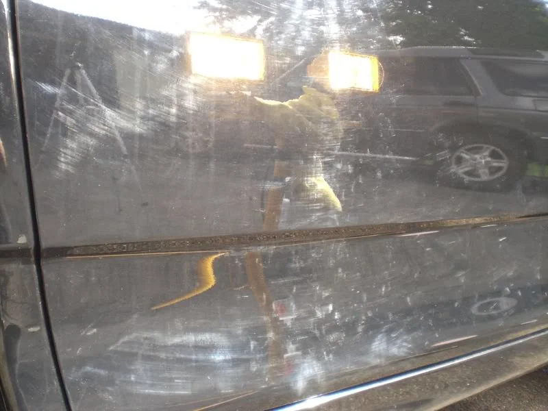

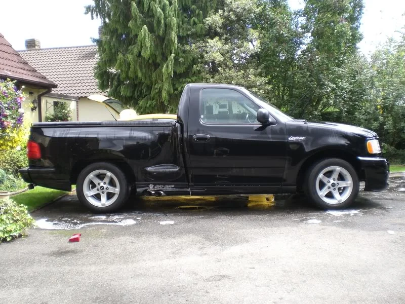

Started out like this, dull and dirty!
Treated to an APC/Shampoo plus mix via the superspray:

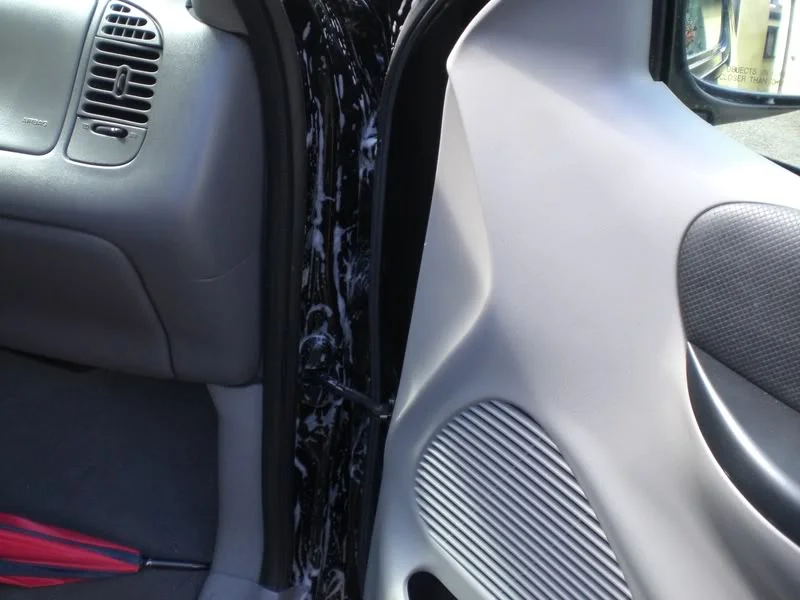

Door shuts also cleaned:

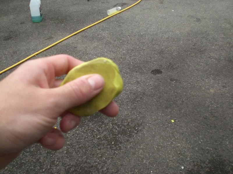

After claying, was looking a bit better!

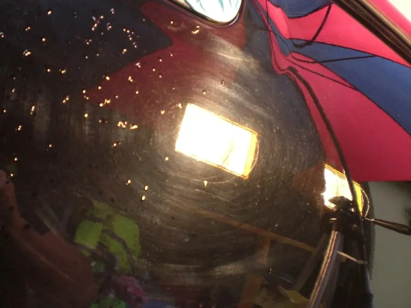

Dried and taped up, and this is what I was greeted with, lovely!

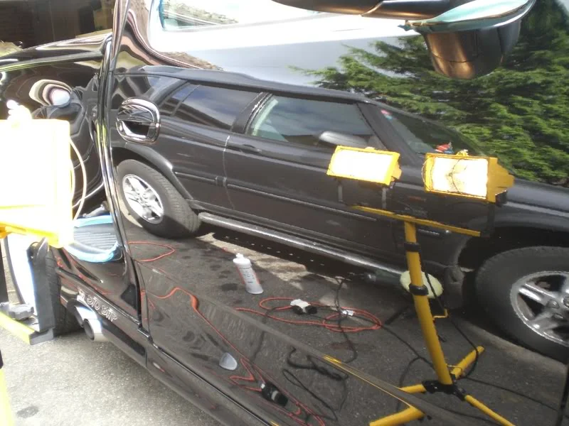

Anyway I cracked on, I think I ended up using an SFX-1 and 106FA, although I'm not 100% sure. A massive improvement with only a few RDS remaining:

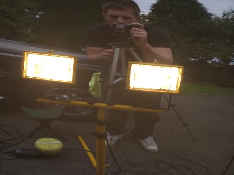

The tripod is only there to make it easier to take pics by the way!

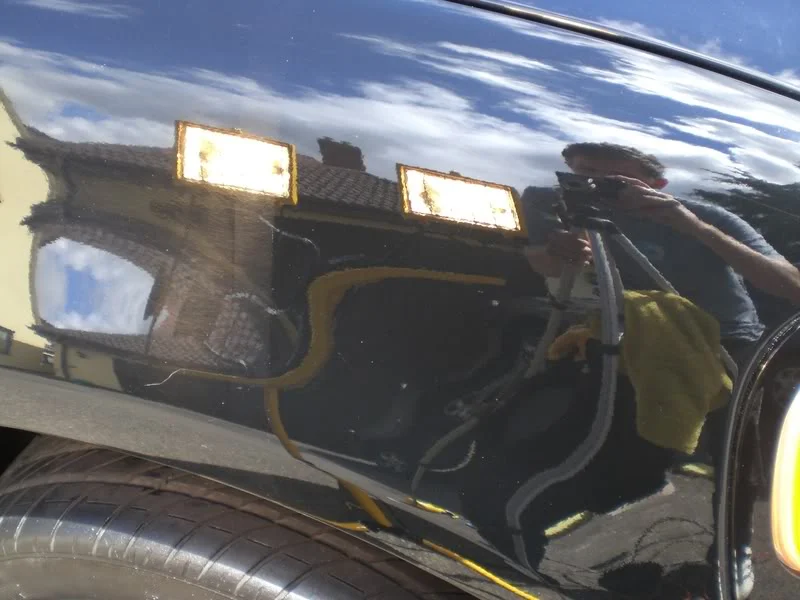

Wing corrected:
Wing corrected, door untouched:
Both corrected:
Door corrected:
Clarity/reflection shot:

i find the Menz is a nightmare in cold conditions! Doesn't break down properly.
This was over a year ago I did this though, think the weather was still fairly mild. Halogens help a bit, they put out some right heat!
I've been using Menz S100 for this mini I've been doing and it doesn't seem to be affected by heat as much as 106fa etc. Dusts a bit less too! But yeh the menz is fussy in the cold, can be very frustrating!
