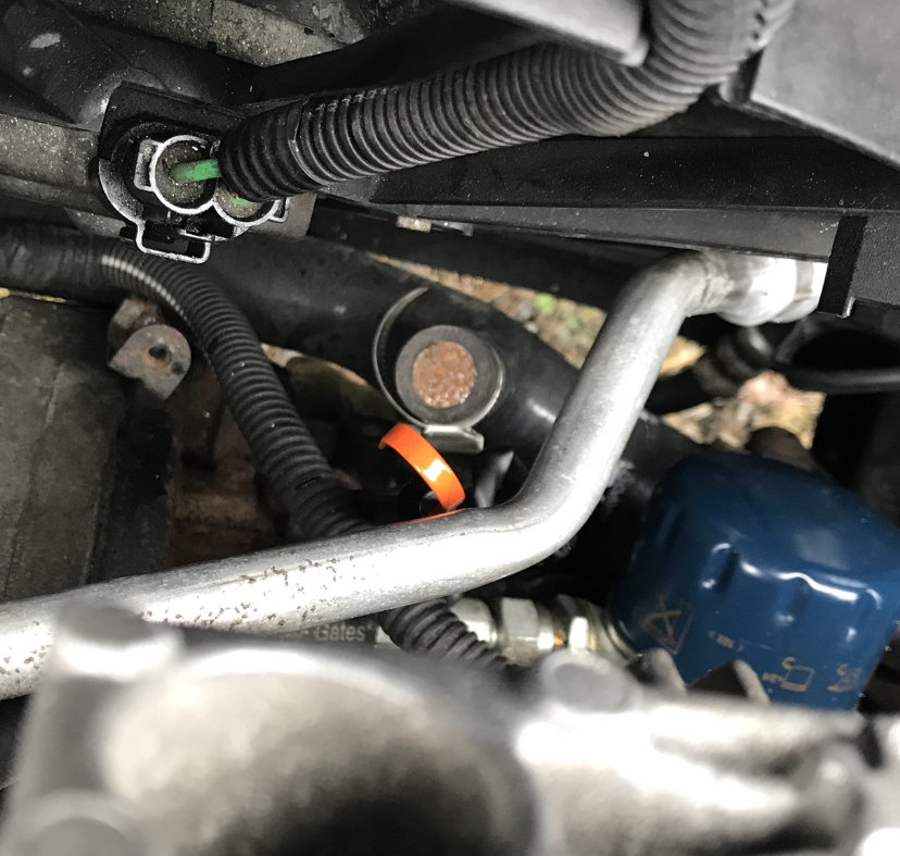

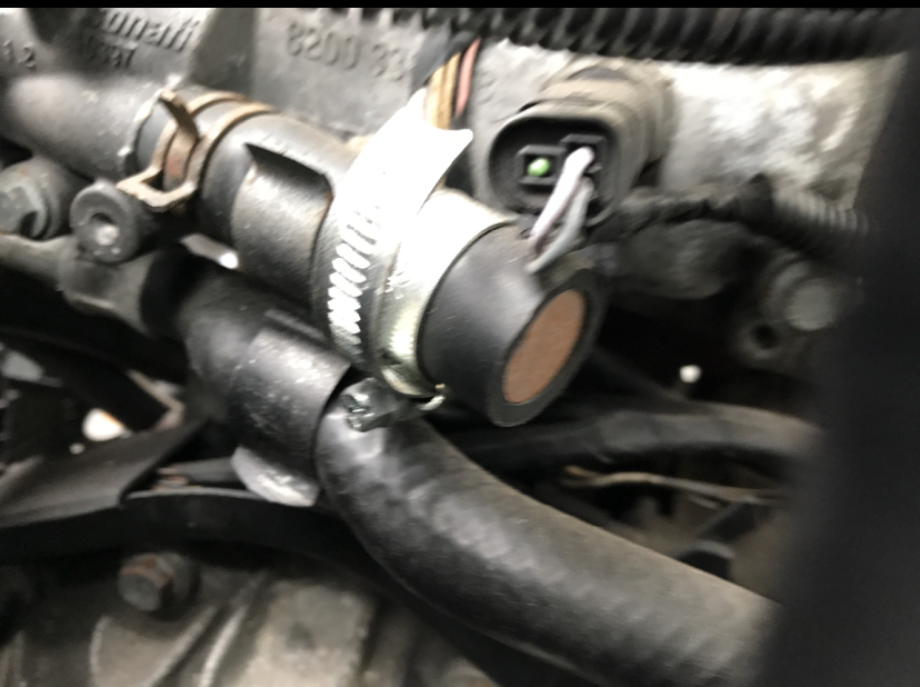

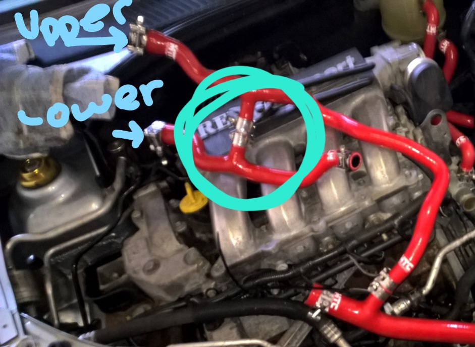

Bit of a resurrection here. Has anyone blanked off the two misaligned T sections? The OE hoses don't feature this heater matrix bypass design?
Mr Underhill
Yeah. Can’t remember what size steel I used again, but caused me zero issues after 5years of hard circuit work. It’s still like that today.

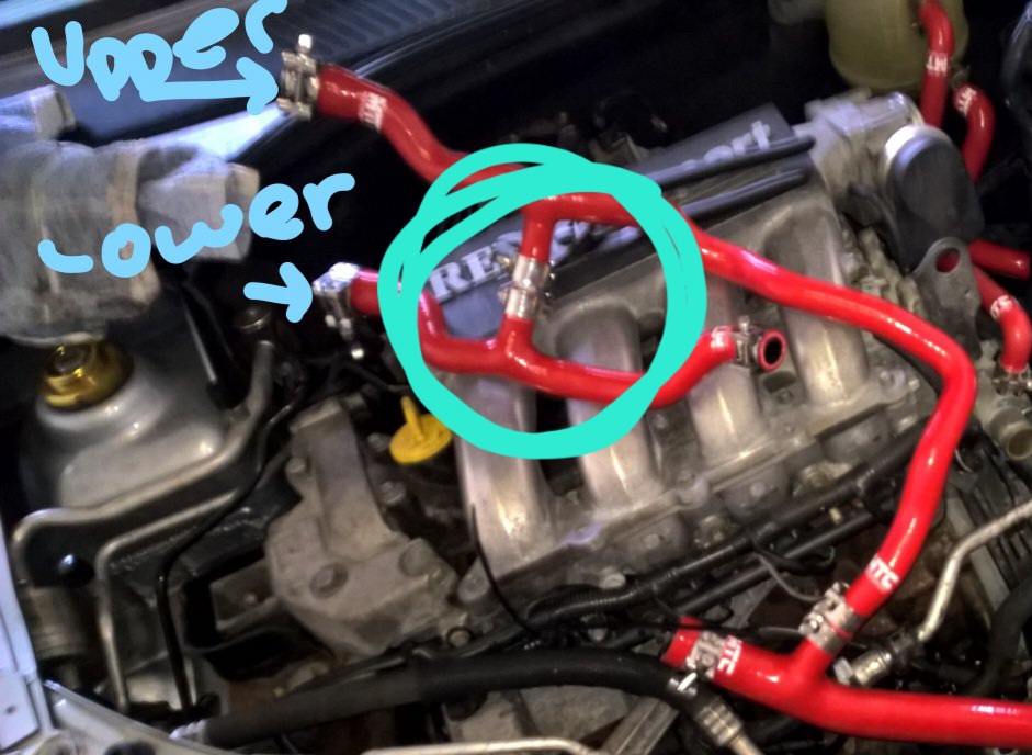

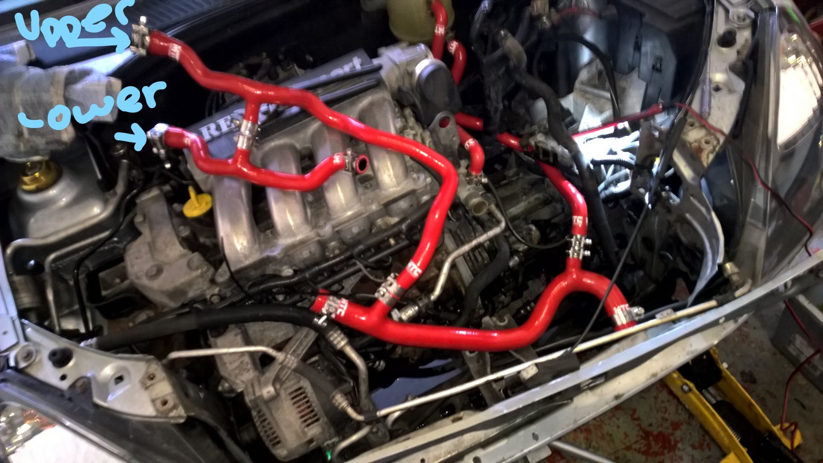

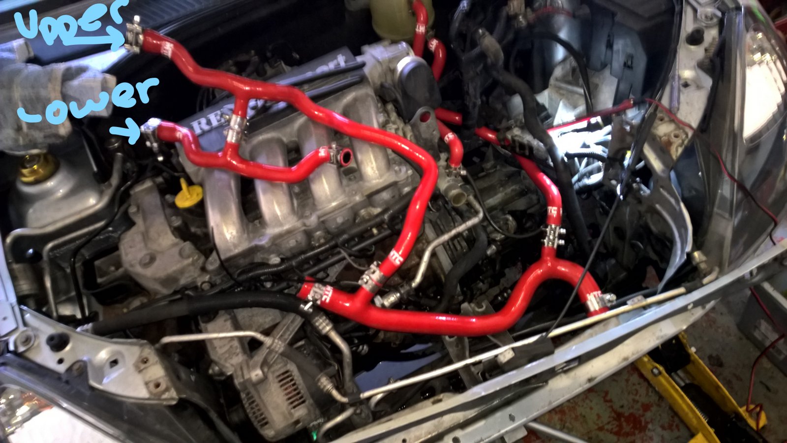

So the pic below (not mine) showing "Upper" and "Lower" are meant to go to the Heater Matrix connections in the bulkhead however they are so far part I'm going to struggle to get them lined up to the matrix connection.
Please note on the pic below they are closer than mine are
Thanks as always in advance.

Ah, sorry, I was meaning the heater matrix bypass section pictured above/below.
I think this connection is what was giving the OP issues with fitment, as it makes it awkward to fit the hoses onto the heater matrix connections on the bulkhead.
The original hoses dont have this.

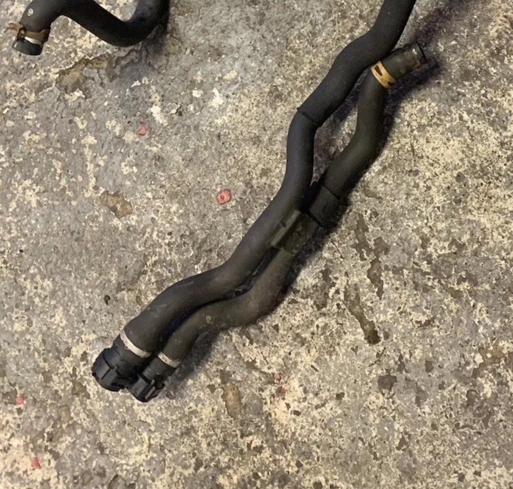

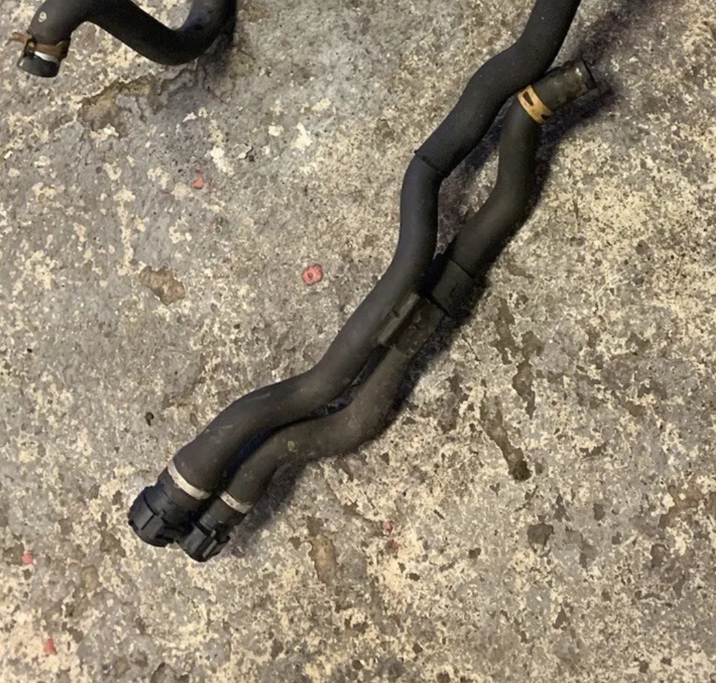

I'm pretty sure the oem one does have that?
aldo_87
  Campus 1*2
They're joined together, I presume for keeping things tidy/secure. But it doesn't look like there is a coolant path between them.
