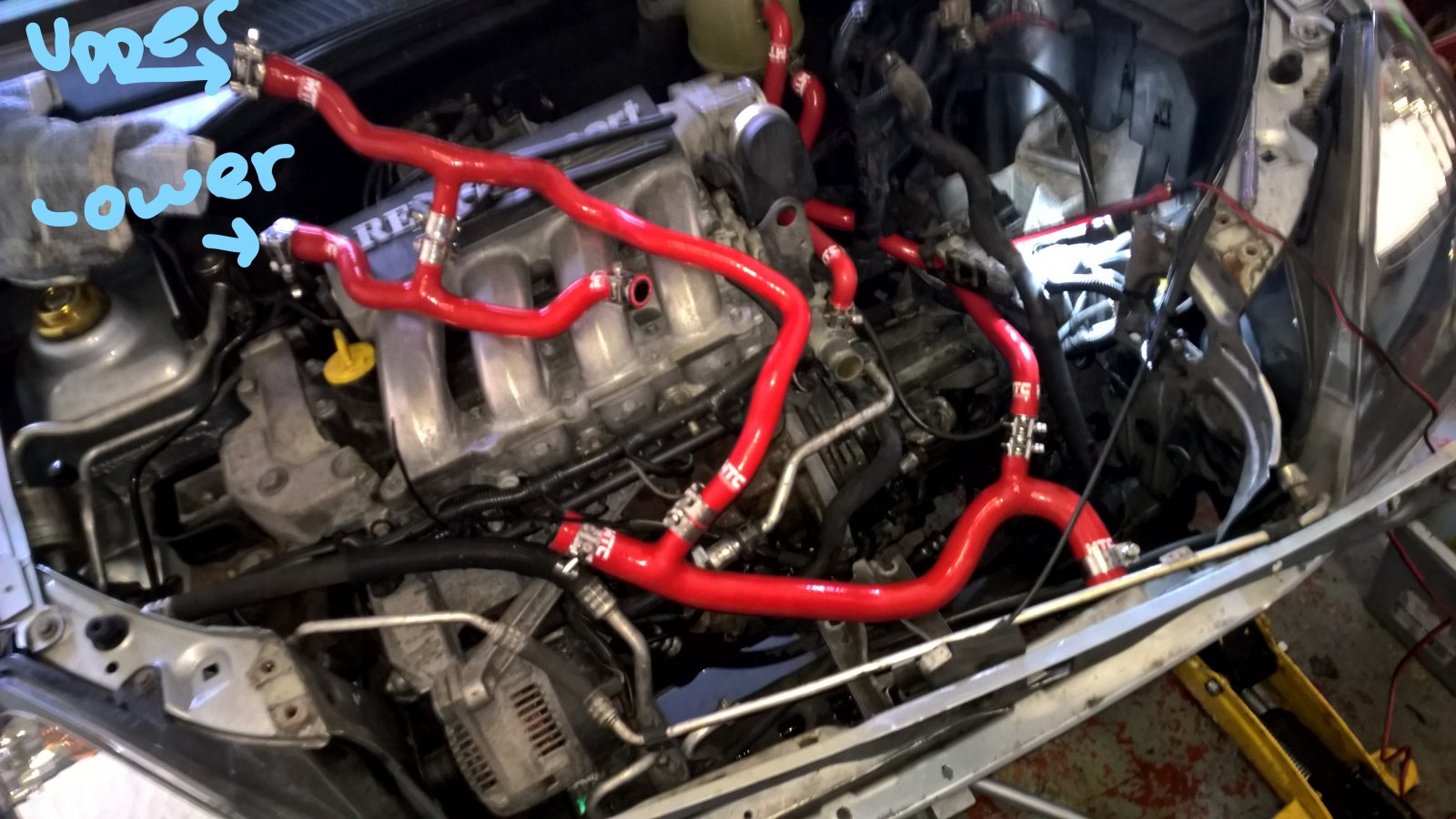

I've had a little trouble today fitting my Forge hoses.
In short I can't seem to get them to fit. The main issue being the two hoses which go to the heater matrix. I'm sure I have the hoses all connected in the correct way however the two pipes don't line up to the matrix connections. I've followed a guide on here but it looks like the join between the top pipes going to the matrix are too long thus making the gap too large for them hoses to fit (not sure if any of this makes sense!)
Help!
Tom
PS: I'll try and get some pics
So the pic below (not mine) showing "Upper" and "Lower" are meant to go to the Heater Matrix connections in the bulkhead however they are so far part I'm going to struggle to get them lined up to the matrix connection.
Please note on the pic below they are closer than mine are

In brighter news I've got to the bottom of the issue, thanks to @Stuiemc we measured his forge hoses and my "t sections" are almost twice as long as his, thus the problem fitting them! I contacted Forge earlier and received a guide on how to cut the hoses. If I'm honest I'm a little disappointed with the response so I'm going to send another email shortly explaining the difference in length between mine and another set and see what they say.

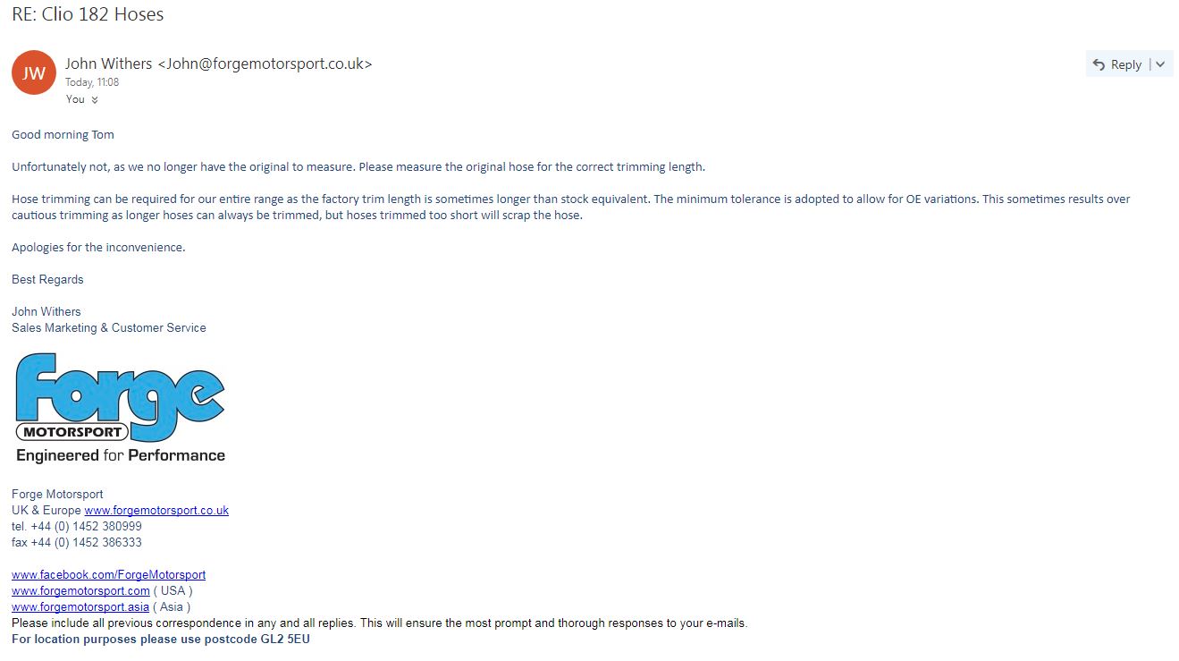

So i received a reply from my email of last night, quick reply IMO however no real joy.
Pic of email below but in short they basically want me to trim the hoses myself, which when paying almost twice the amount "compared" to a "lesser" brand leases a bitter taste, in hindsight I should have gone with the Samco items, which were only a bit more expensive than the Forge items.
I'll get trimming tonight!

I know mate and lets not forget it's almost 40mm on each hose so I was a good 80mm out, no wonder I was having trouble lining them up!

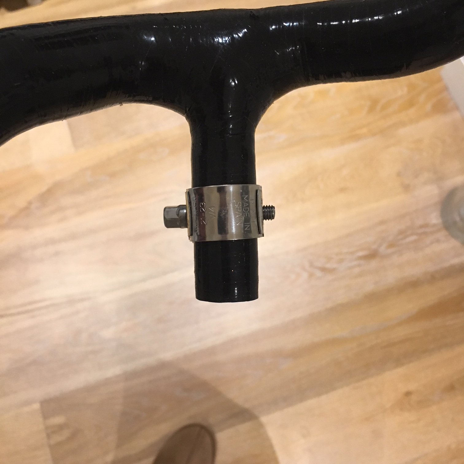

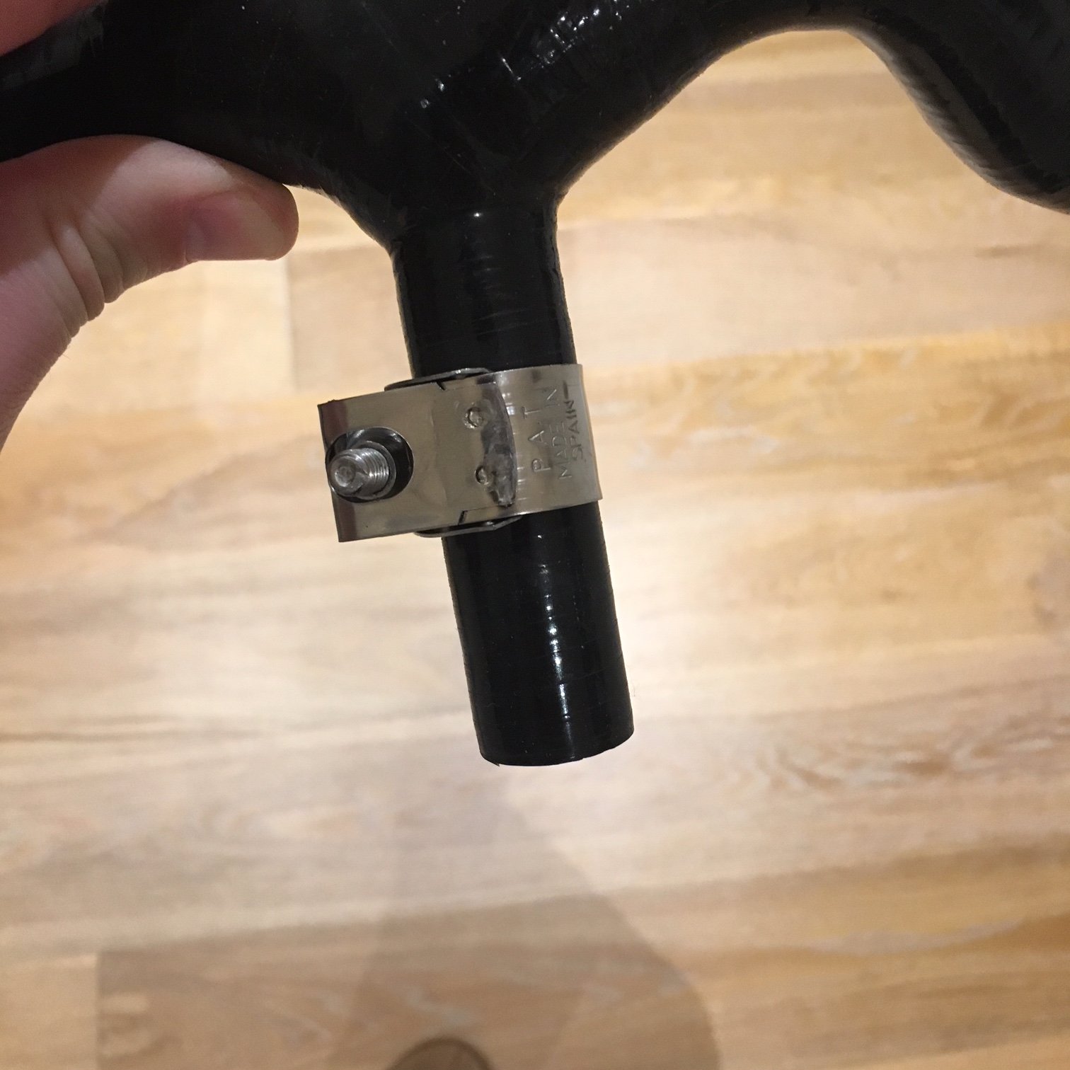

For reference the pic below shows how much I need to trim to make the same length as @Stuiemc
I need to cut off below each clamp:

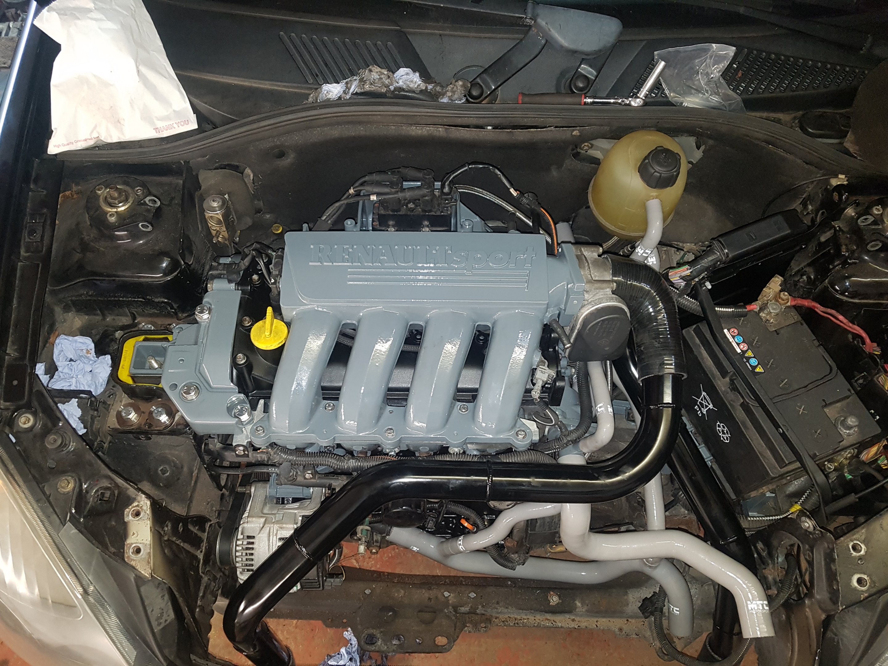

goes well with the other grey and the satin black, throttle body is going black and all the hoses having black jubilee clips as well.
Can I ask where you get your black jubilee clips from? Been looking at some myself but don’t want to end up with crap ones where the coating just comes off and they end up looking naff.. cheers!!
got some mikalor stainless ones off ebay, not fitted yet though.
