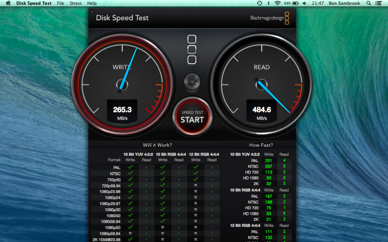

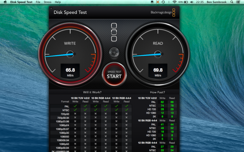

Doesn't mean much but a quick before and after read & write speeds.
Before
After
Just timed the after start up time, got 13.75 seconds to the login menu. Unfortunately I didn't get a before time recorded but it was at least 40 seconds, massive difference.
