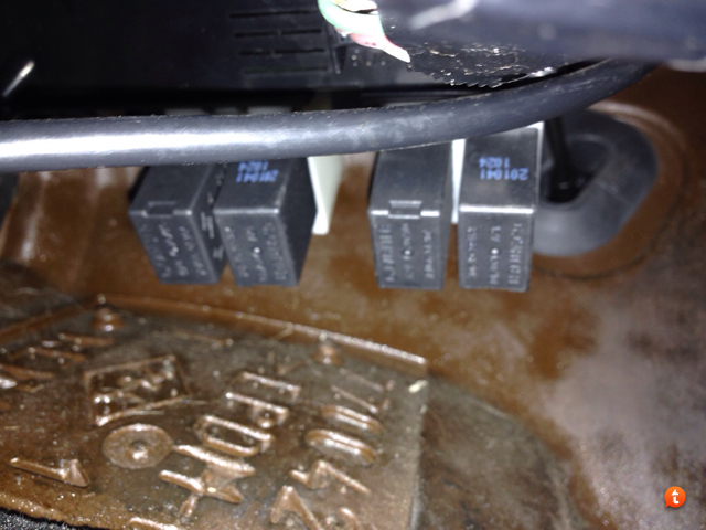

Knocked one of the relays out under the glove box I bet
looks like that just get your head under there and push them back in

Anyway, the lights being out is probably a relay under the glovebox in the footwell that's loose or been knocked out. No idea what switch you're on about. One main beam bulb is probably a coincidence.
