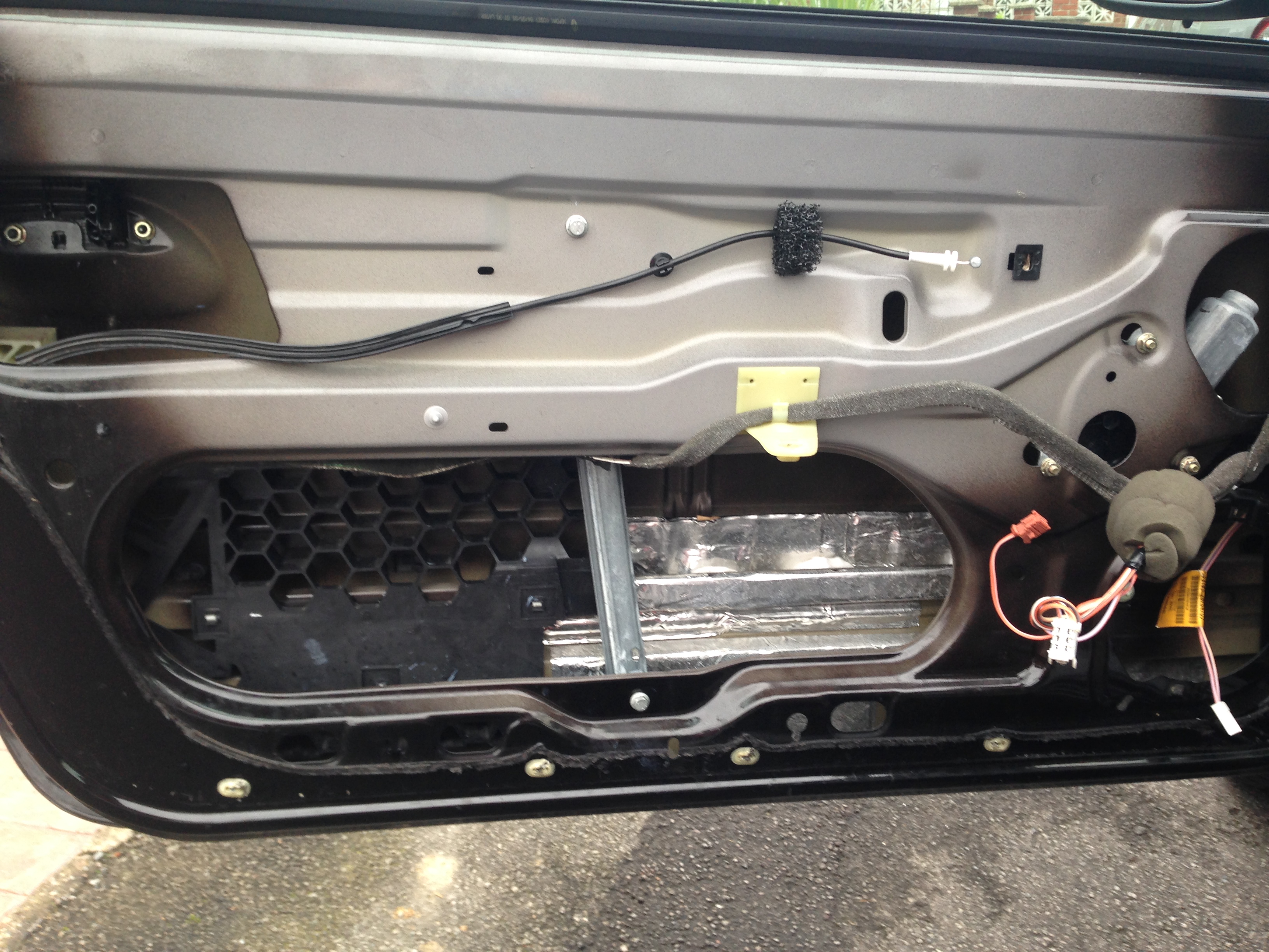

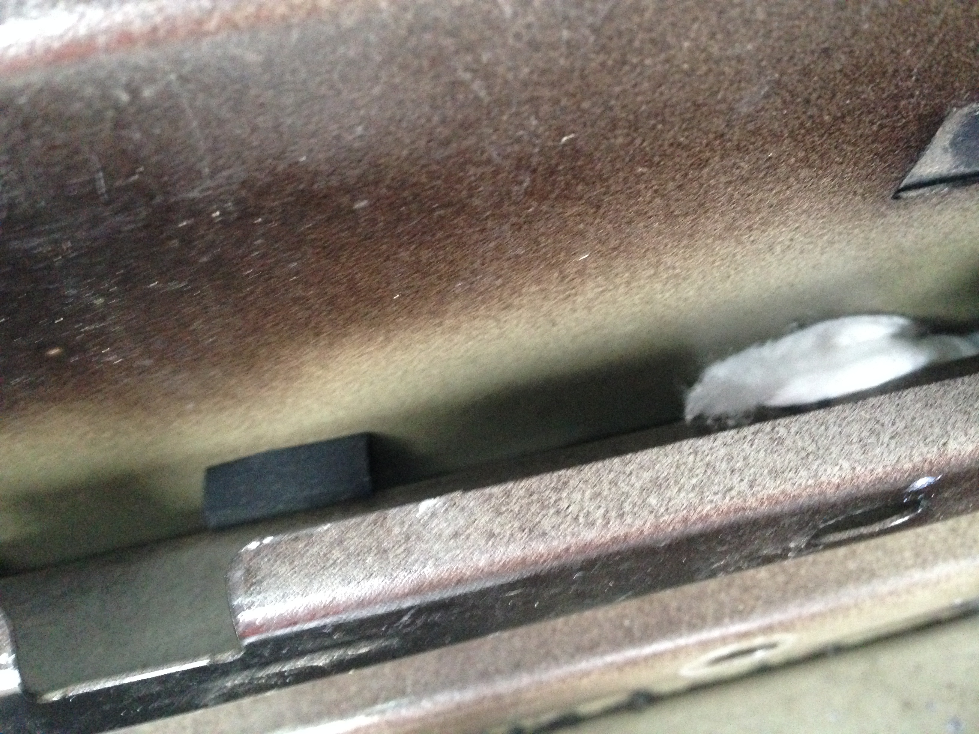

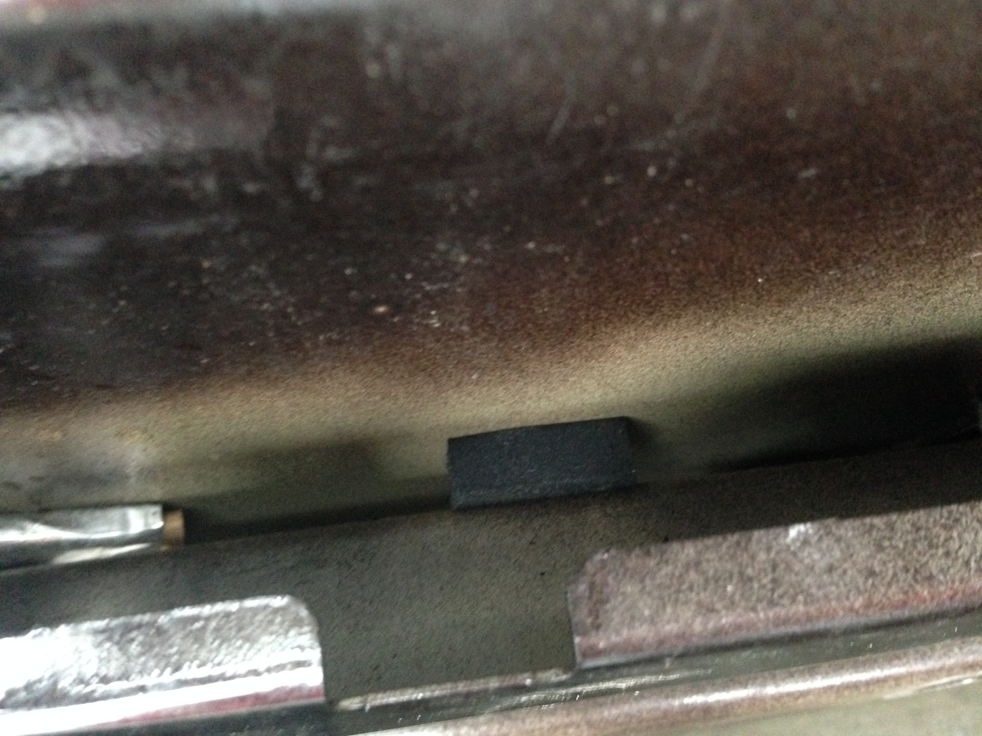

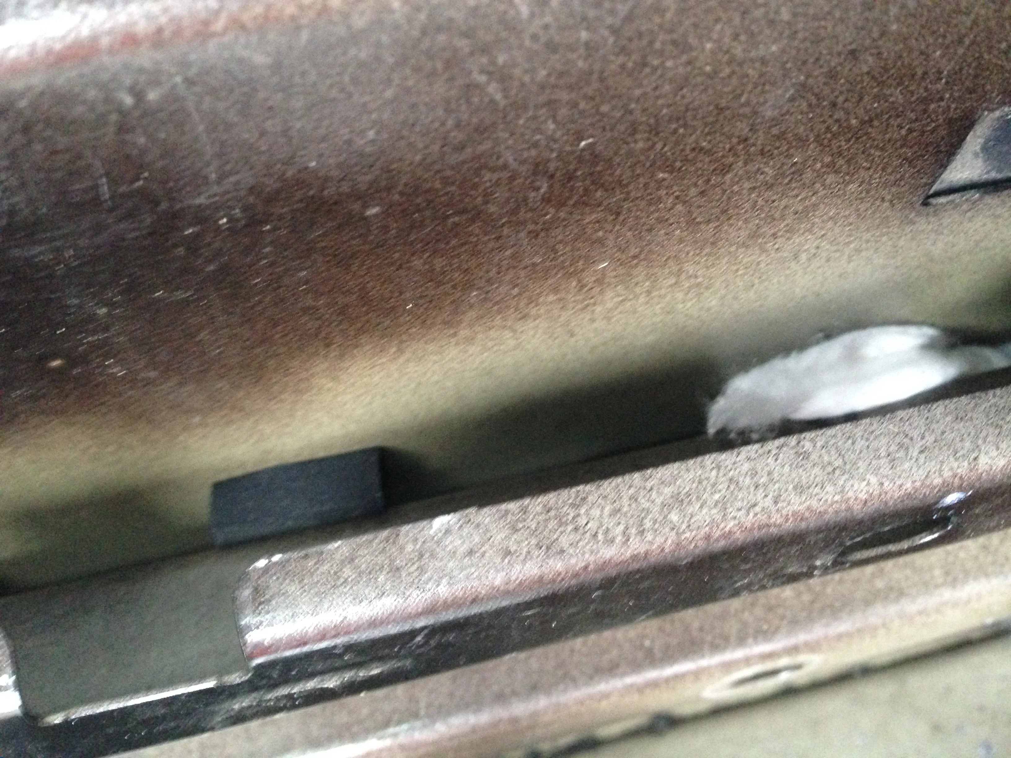

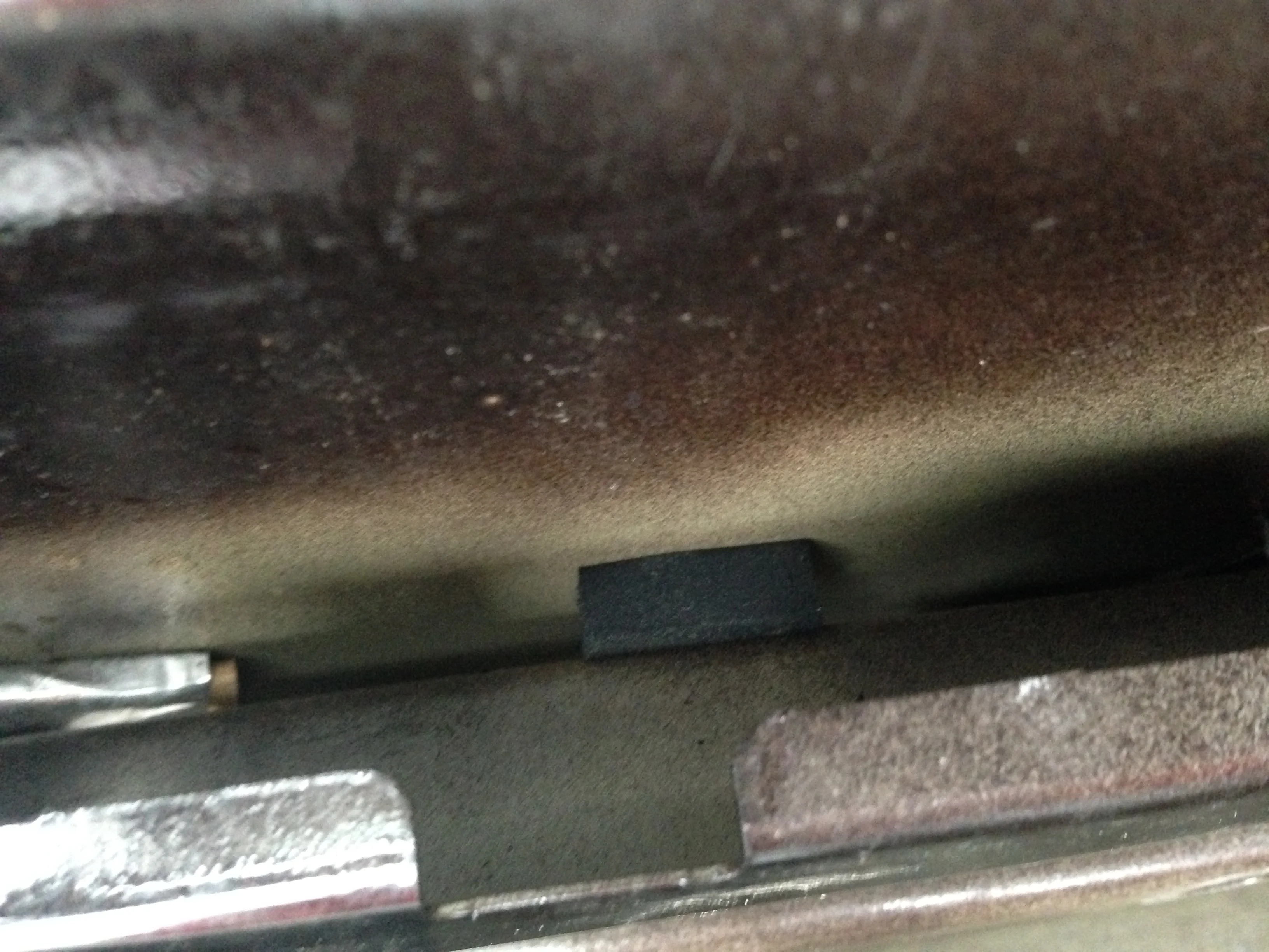

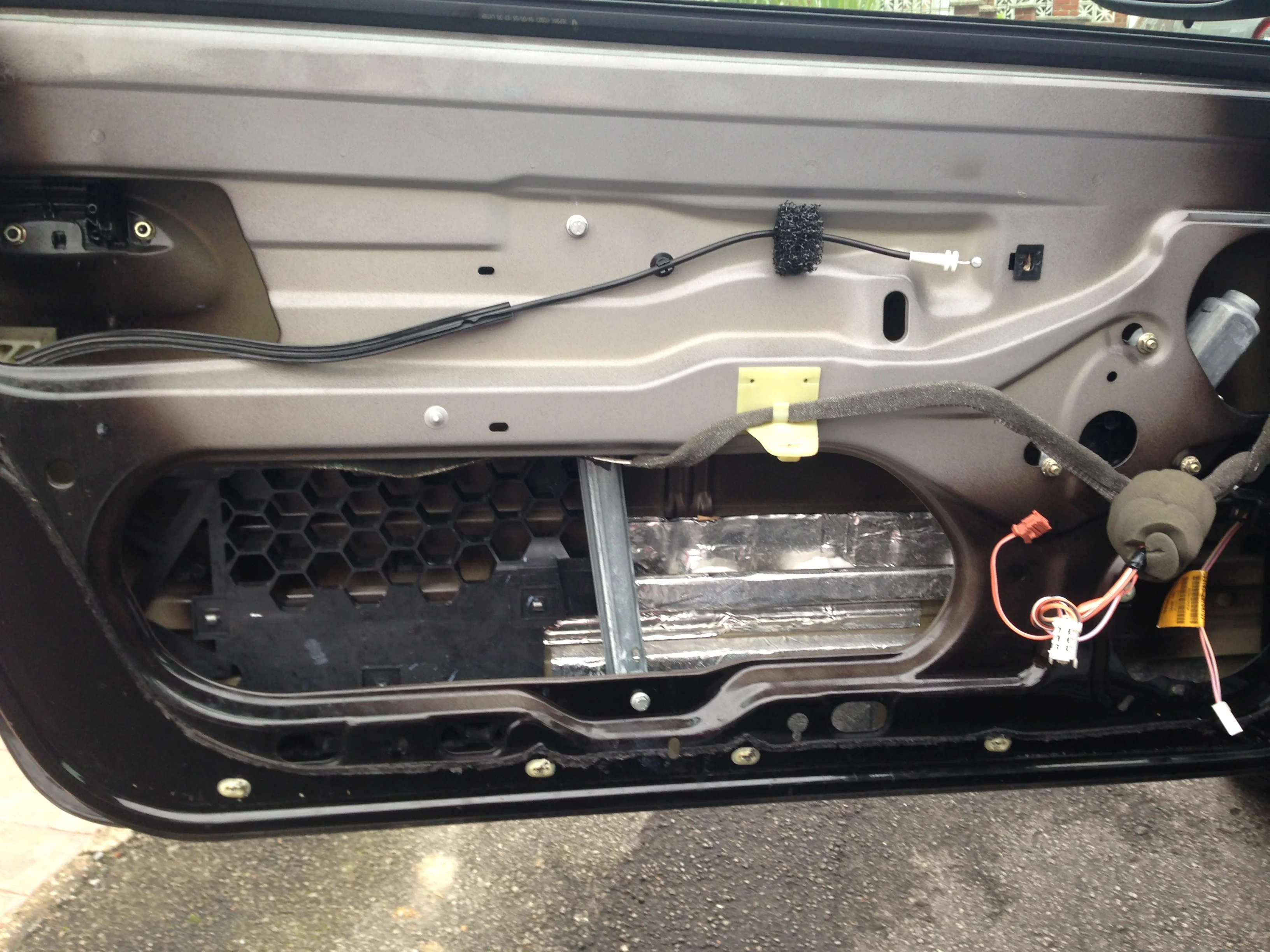

Well i have finally fixed the problem related to my window. My problem was similar to @Diagro's where the foam pads had appeared to have fallen off or something. I have now filled the gaps in with cotton wool pads for now until i get my foam pads in the post over the next few days.
