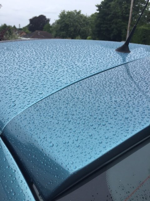

Gave the car a clean last week and then a once over with Simoniz Quickshine Detailer. Glad to see a week on the car is still beading. Not very uniformly but beading nonetheless.

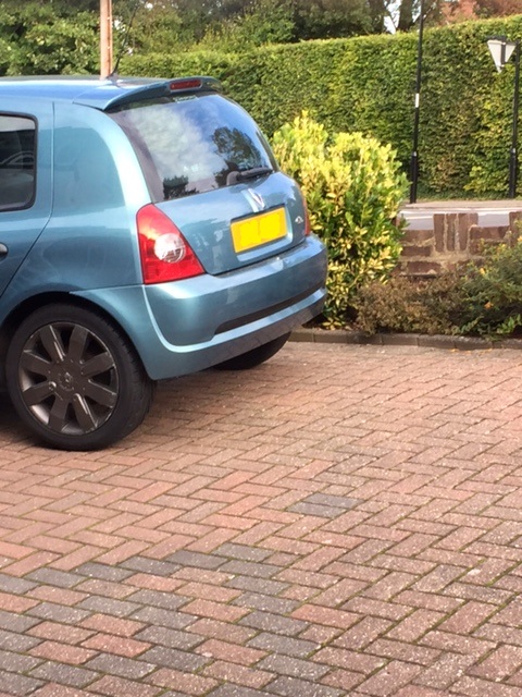

  3. I've also sourced a 172 rear bumper that's been resprayed and I've fitted this on my drive albeit! Pic below.
