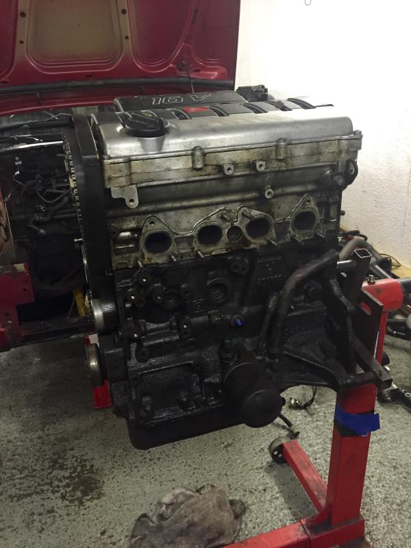

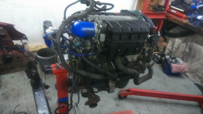

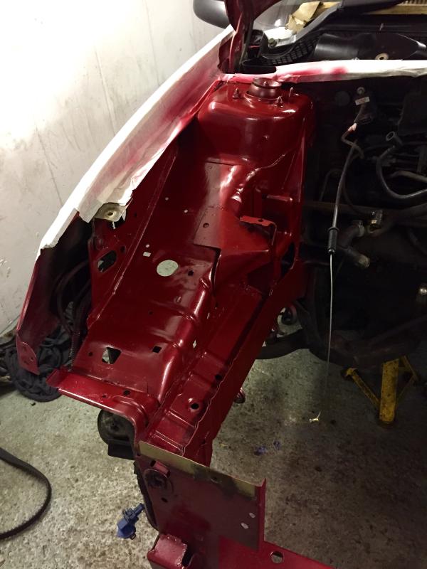

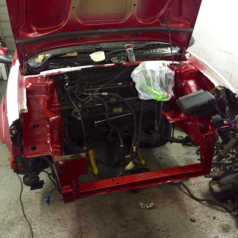

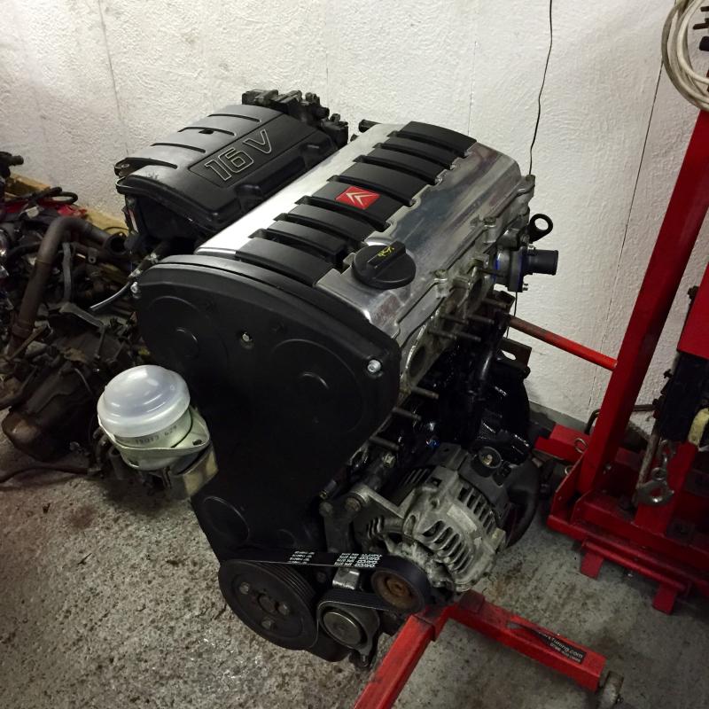

Engines out and the bay will be getting a lick of paint before it goes back in.

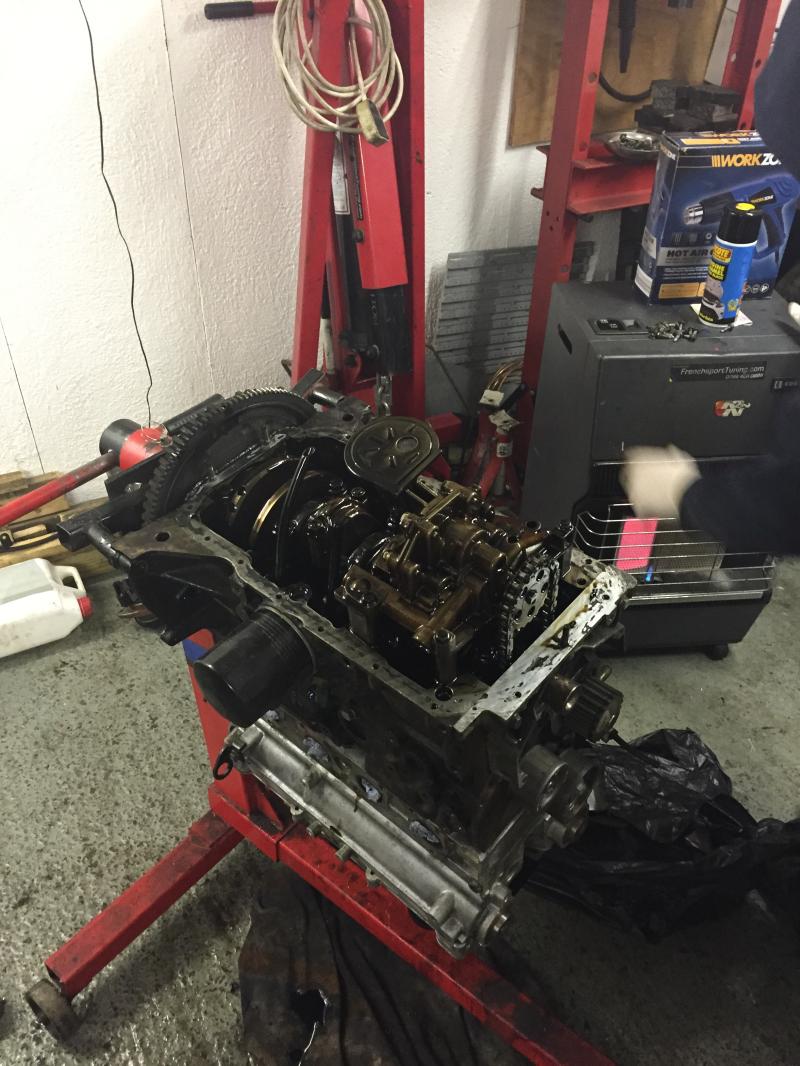

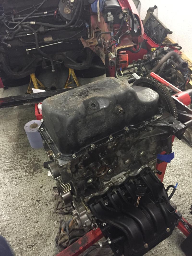

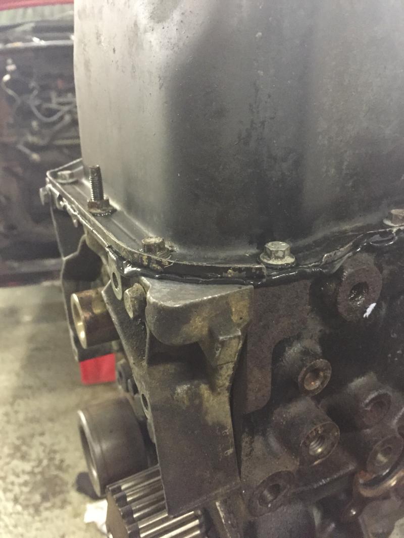

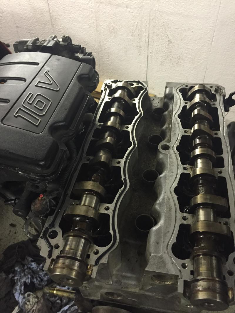

Went down to help out on the Saxo tonight. First of all the manifold, turbo etc were all stripped from the engine leaving just the inlet on. The car'd had some nasty oil leaks so we brake cleanered it to death but will probably paint the block before it goes back in the car.
Pre clean up;
Next was to take the sump off and reseal that. Sump will be getting painted before the engine goes back in.

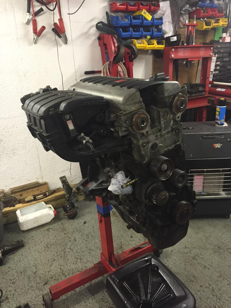

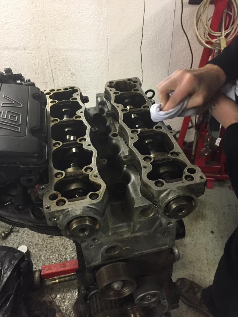

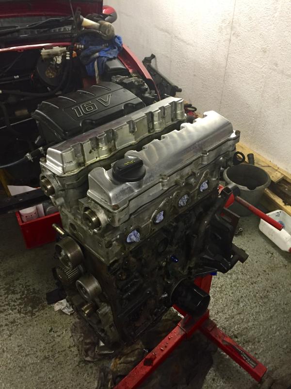

Next off was the cam ladders to be resealed;

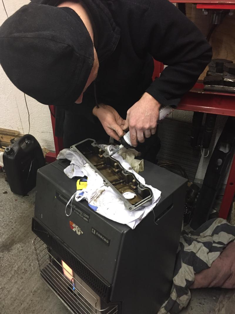

And then the rocker covers;

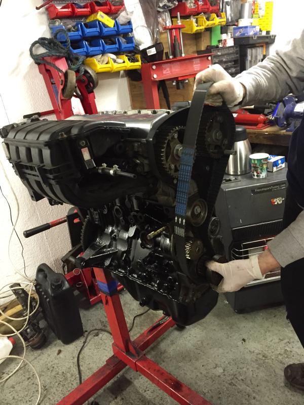

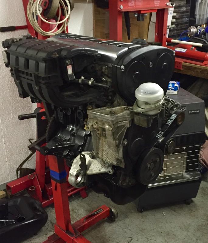

All done and ready for tomorrow;

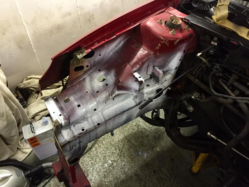

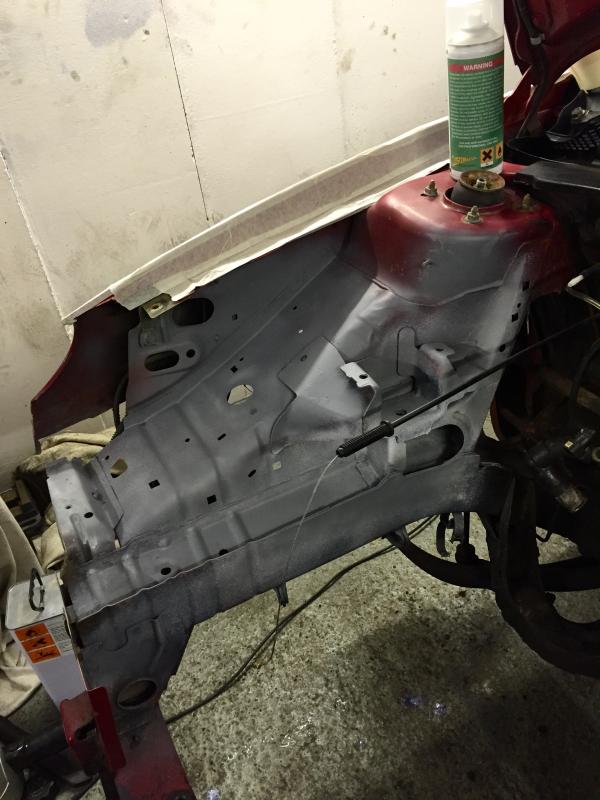

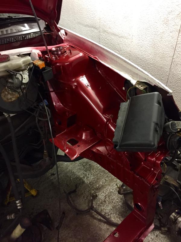

Rattle cans turned up for the bay;

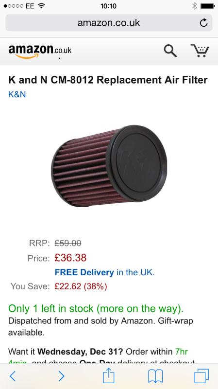

Also ordered a new filter as we are looking to relocate where it is now;

Good work, you've spent your crimbo holiday wiser than me,
also can i have the part number for the gas fire's k&n, mine could do with a few more btu's
