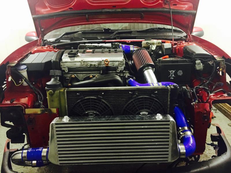

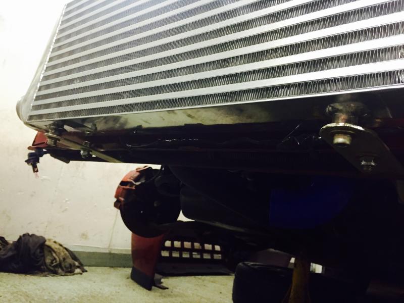

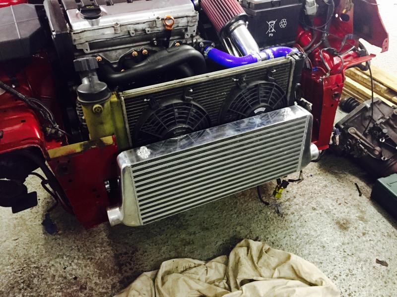

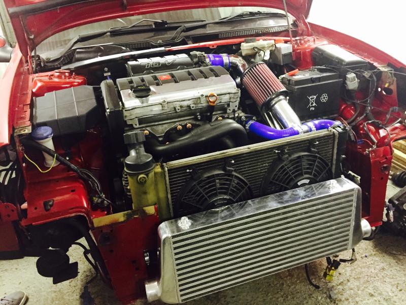

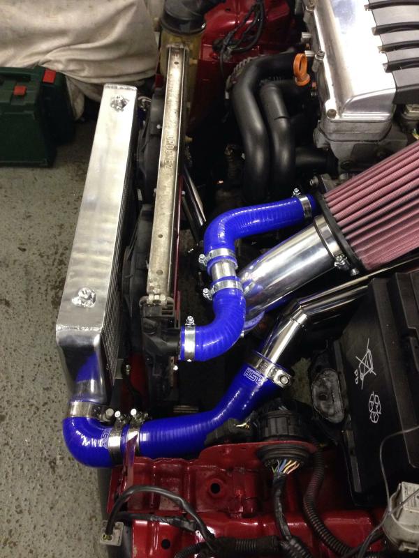

Got the intercooler mounted tonight;
Filled the oil with Fuchs Titan supersyn 5-40w and then got all the pipes fitted.

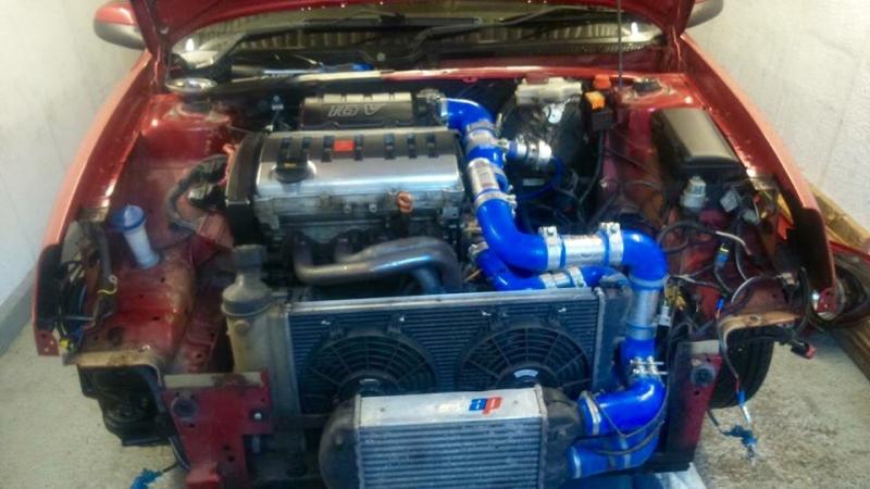

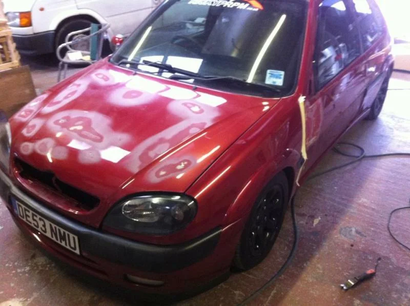

Here's a couple of before and afters to show how it was when I got it and how it is now;
Before;
After;

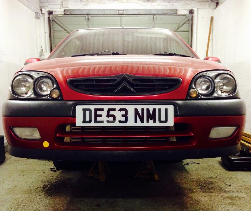

Front bumper is gonna need some trimming before it goes back on...,.
Looks good but I wouldn't have wasted my money on the fmic unless you have bigger plans.
Are you planning to run a touch more boost or something?
Also, whilst it's apart have you considered repositioning the filter?

What happened to the black wheels you showed it with when you were thinking about buying it? Did the dude keep those?

It was a dudet! Yeah, she kept them - said she was sentimently attached to them and then sold them the following week.

I'd have used a cooler with the exits on the same side but other than that it looks good. Needs new fogs though.
I wouldn't bother upping the boost on the GT17, it'll already be way out of its efficiency cycle. Get a used GT25 on it.

No no no, that's an old pic from the previous owner. I just used it to illustrate the lights as they're the same ones that are going back on.

As mentioned, can you not remove the fogs and relocate that filter? But then I'm guessing with the super cooler it isn't going to make a huge difference to the inlet temps..
Ph1 Tom
Looks a tidy install, nice one! Could you turn the filter so it goes in front of the battery or behind the headlight and get air to it with a CAF?

There's no space really to do that although that's what cituning do but I don't know how they do it. I'll see how it goes.

Looking great, but isn't the intercooler a little bit oversized for that application?! That wouldn't look out of place on an 800hp Supra!
Yeah! I bought it from a guy in hudds and measured up must've miscalculated. To be fair, I thought it was an alright price at £59.
It's future proofed for when I'm running a fully forged 400bhp number.

I do think it will be considerably more laggy. You have longer pipework and a intercooler twice the size. That coupled with a turbo which exhales about the same volume as a sparrow.
Just means one thing, you've got to go back to the R5 dayz..lol
Ricardos
  LY 200 EDC
The bleed valve of death! I remember seeing them on loads of R5s back in the day... Why oh why?!
