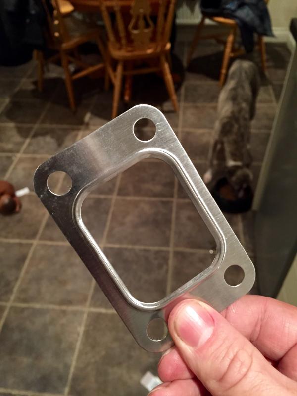

At least you've found it. My glanza mani used to crack what seemed to be every other week..
leeds_182
North Yorkshire & Humber
Yeah, took it to Tony banks in Leeds today and he welded it up for me for free. Will hopefully fit tonight and see where the new blow comes from!
