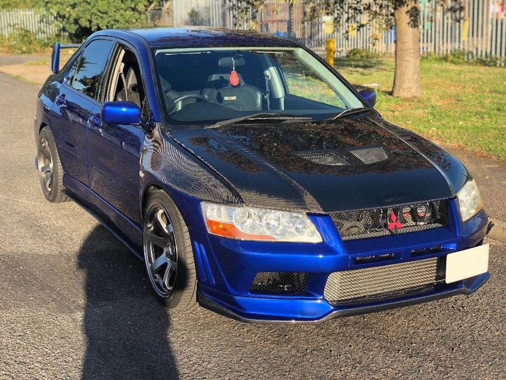

Congratulations to my friend who recently purchased his dream car an Evo 7! Couldn't be happier for him! Today it came back from Norris Designs where it had a Link ECU fitted and mapping. It made just shy of 400bhp on low boost and 500bhp on higher boost. The car is mint and im very jealous!!

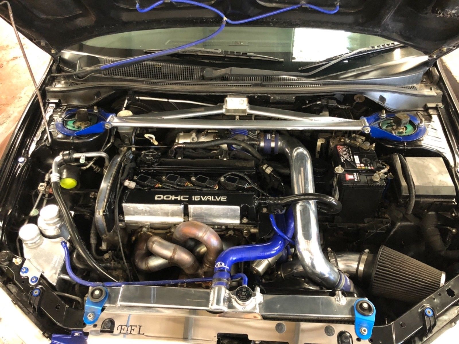

Engine
2.0l long rod Engine - built by Damico Race Engines.
Standard bore Evo 7 block striped and acid dipped.
Line bored to take the new ARP studs
Balance shaft oil gallery’s tapped out and plugged for extra tight oil seal.
Re-honed, As it didn’t need a re-bore.
New core plugs
New sump pan
New oil squirters and banjo bolts
New Mitsubishi oil pump
New oil strainer
New water pump
Cometic 1.2 mm head gasket
Genuine gasket kit
Cam and crank seals
Rear main seal
Weisco 85mm 1400 hd stroker pistons
156mm Carrillo long rods
ACL Race Bearings
ACL thrust bearings
ARP head Studs
ARP main studs
New Mitsubishi Balanced and lightened Crank
Tomei Oil Baffle plate
Brian Crowner Titanium Valve Springs & Retainers
3mm Lash Adjusters.
GT 262 cams
Genuine HKS Cam Pulleys
Gates Racing Cam Belt
Zaklee upper cam belt cover
New Hydraulic tensioner
New genuine cam belt idler and tensioner pulleys
Balance Shaft Delete
New cam shaft and crankshaft sensors
New temperature sensors
New water pump pulley (these are known to crack so was replaced)
Polished alternator
Evo 6 rocker cover with AN -10 fittings
Neverman stealth catch can
Cylinder head striped down and acid cleaned. valve guides checked and valves re-ground into seats new valve stem seals fitted.

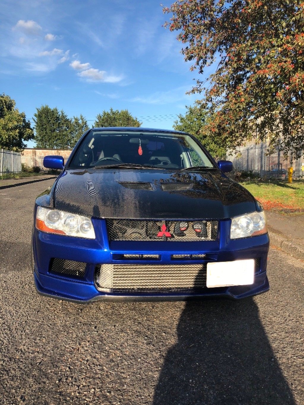

Massive OBX Intercooler

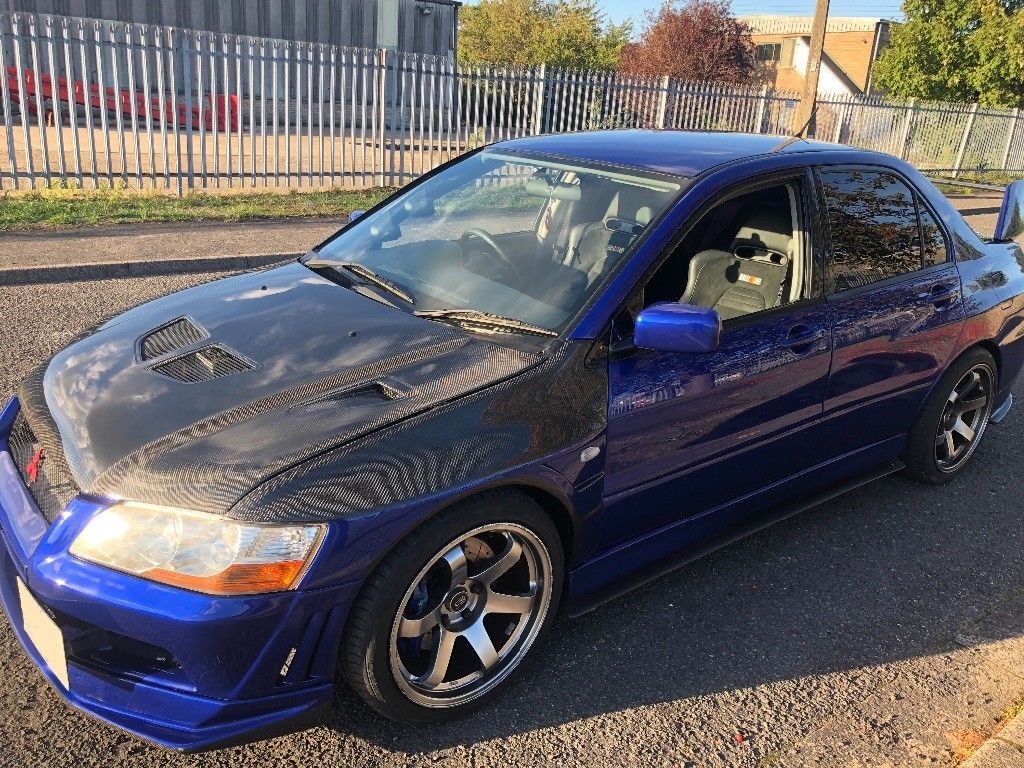

Rota's 18 x 9.5 & 245

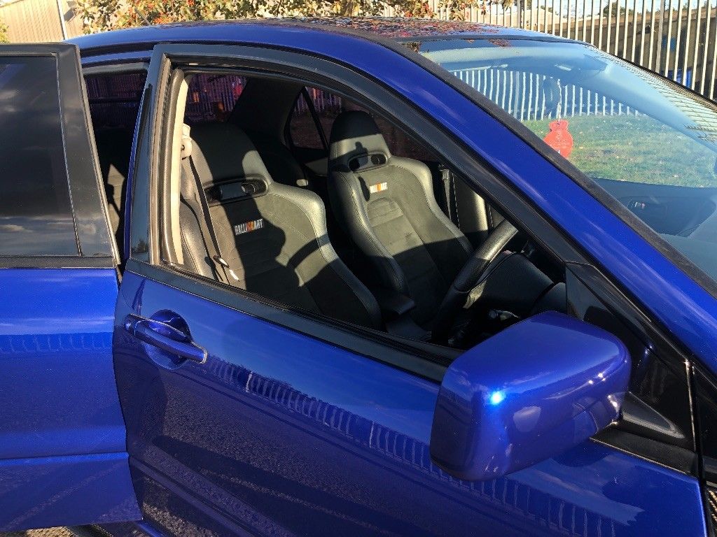

Interior
HKS turbo timer
Evo 9 Ralliart Half Leather Seats Front & Rear
Evo 9 Black Carpet
Evo 9 Dash Inserts
Ralliart Floor Mats
Ralliart boot carpet
Carbon Gear Surround
Ralliart Gear Nob

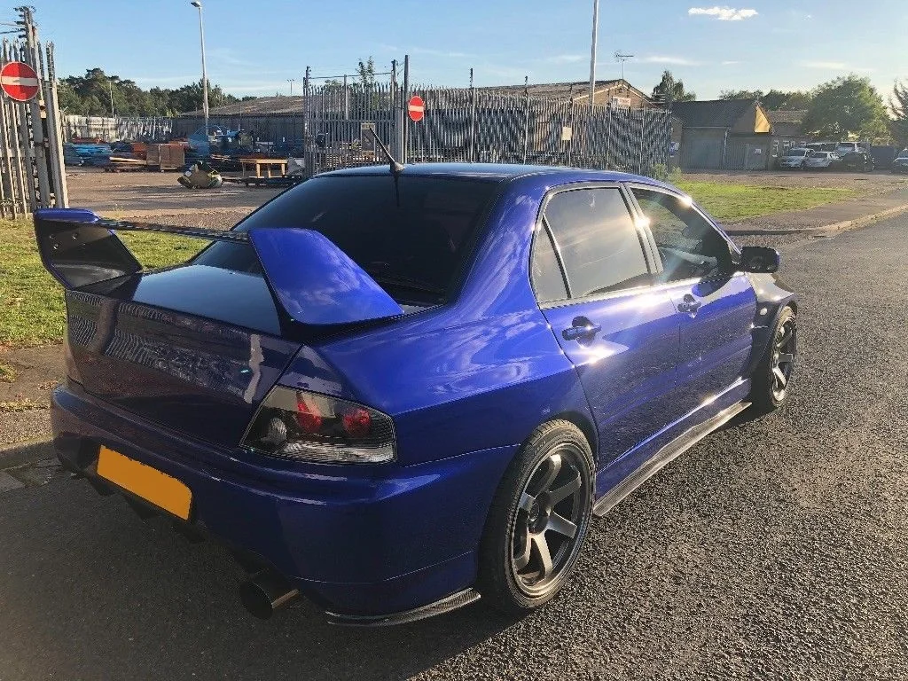

Bodywork
Carbon Front Wings + 20mm, Custom Painted
Evo 9 replica Rear Bumper with Carbon Extension
Carbon 7 bonnet
Carbon Side-Skirt Extensions
Varis Carbon Front Splitter

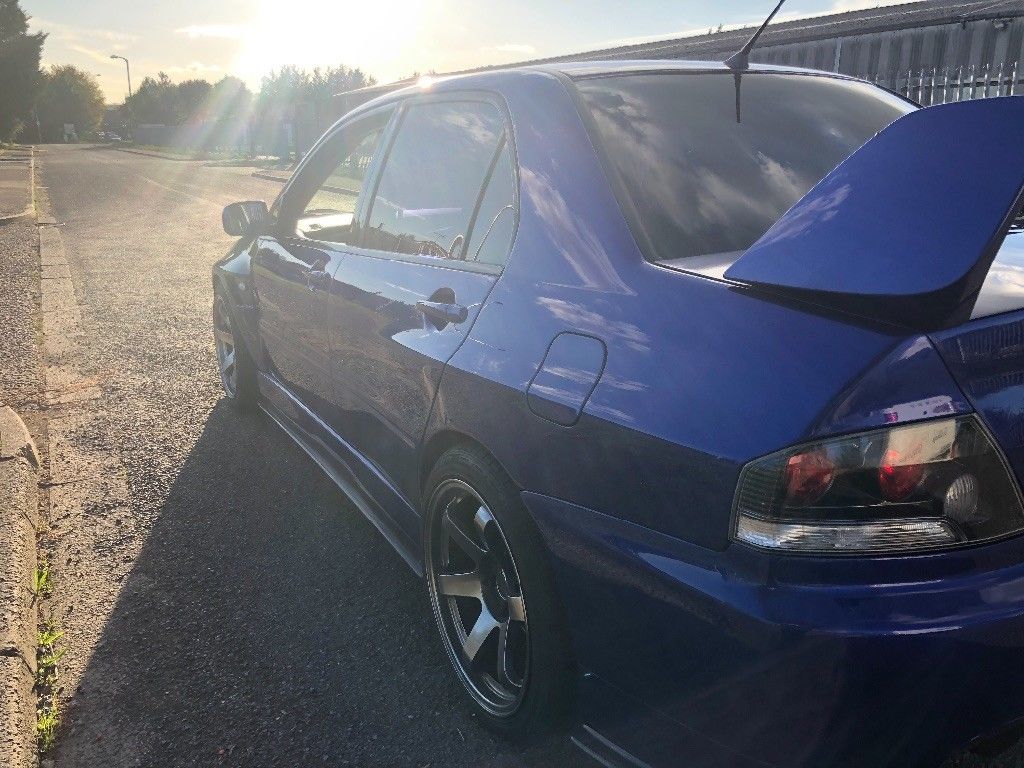

Carbon Rear Spoiler (bit faded)
Carbon rear bumper extensions.
US rear lights.
Engine bay
Stainless slam panel cover
Stainless Spec r power steering resivour
Stainless spec r engine coolant resivour
Neverman catch can

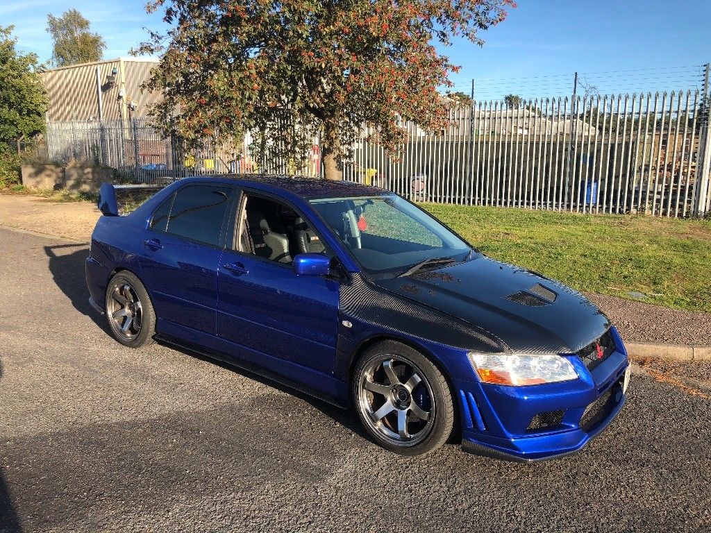

Wheels will be changed for something better and Japanese. I personally like the carbon. Looks lovely in real life.

Was just about to mention, how can you spend that much on a car and then still fit Rotas. Would love an Evo though, not too my tastes but fair play I bet it’s amazing

Oh I do miss my Evos, I like all the foundation work done on that but can’t stand the exterior, however if he’s happy fair play ??
Rojer
I'll just mention that he bought the car like that. However I think he is pretty happy with the spec apart from wheels.
Rojer
or paint the CF panels? Rear lights look horrible as well.
Lights are US spec. Well each to their own I guess. I'm just happy that he got his dream car and it goes very well. Built to a high standard. Exterior can be changed if he wanted.
