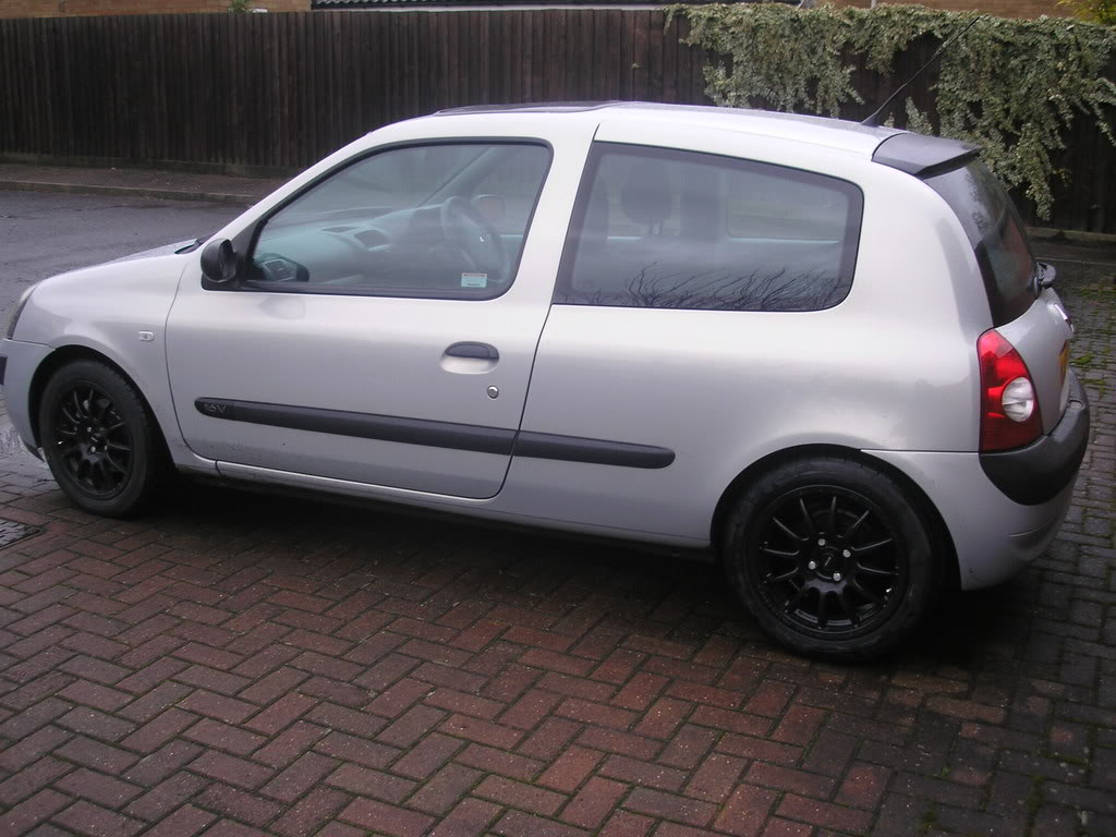

Currently have my clio lowered 40mm on apex springs, but would like it slightly lower so am thinking about buying some 60mm apex springs. Not sure whether to do it though as i've heard it will be a lot more bumpier. Also, i will be running them on standard shocks, will this be ok? Will it be worth it, and will you be able to notice the drop?
Heres a pic currently lowered 40mm
I would spend the money on colour coding myself, Though if your happy with the look and want to go lower then do it.
wanted to colour code but have just been having silly quotes so going to give that a miss now
Personally I don't see the need for colour coding, obviously the bumpers would look better, but with your black wheels it gives off a good mixture.

yeh mate, parked it oppisite work yesterday and thought the black went well together. Black/silver theme im going for.
