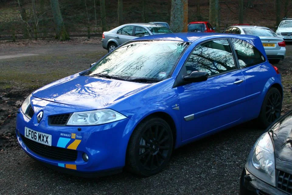

Not got any proper pictures yet but there were a few taken from Sundays Yorkshire meet.
Any suggestions would be appreciated :)
Looks fantastic mate, always liked the colour combo on the F1s and the matching Recaros
Cheers mate. I love the recaros. Always wanted a set in my 182 so when i was out looking for a Megane it had to have them. I'll be in touch with you over the next couple of months to sort out some disks and pads for this ;)
Looks great, nice colour. How do you find it compared to the 182?
I love it. Really different to how the 182 drives even though i can see the similarities at times with the engine. The power delivery is crazy because of the turbo so smooth and always there and the shorter gear ratios, remembering to use 3rd instead of 2nd when pulling off at times is taking a little getting used to!

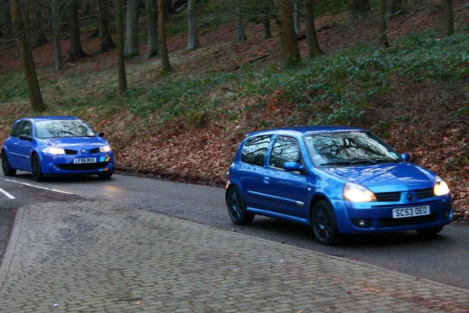

That 172 Cup on the picture, is the reg sc53 oeo, or sc53 oeu? My old one was sc53 oeu!
Lovely Megane by the way, really like that colour on them.
Cheers, really love it when its had a fresh clean, the blue is awesome. Next to @Dan.AS 's RB they look a good pair together with the blues.
This picture was from one of the Yorkshire meets so not quite sure who the car belongs to, SC53OEO is for that one though, its quite weird how close in letters they are!

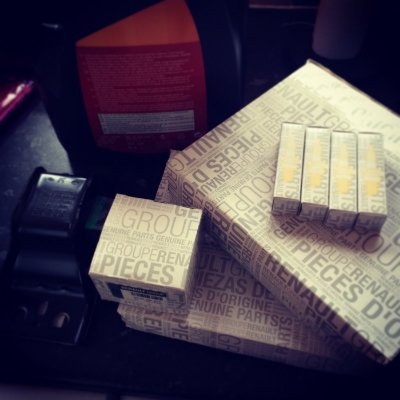

So i set off and ordered the parts from Renault Wolverhampton on here. Great prices and quick delivery :D
This consisted of
Oil Filter
Oil
Air Filter
Pollen Filter
Spark Plugs
Engine Mount
Didn't take any pictures of the pollen filter change (as exciting as it was..) the old one was filthy and covered in leafs. A good clean out and in with the new filter :)
The engine mount needed changing. I was getting a terrible vibration from cold on idle and had a look around and the general feeling was that it was the engine mount so i ordered a new genuine one. Quite a bit fiddly to change with the AC pipes in the way but managed to get it sorted. The old one was shot, there is such a difference now driving the car, nice and quiet and smooth, no rattling windows when stationary!

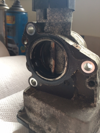

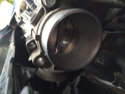

I decided to take the throttle body off, my last car it was filthy and this was the same!
Out came the carb cleaner!

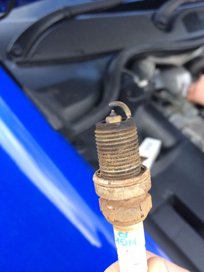

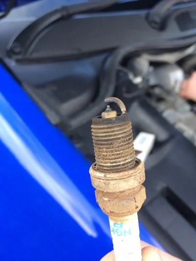

Out came the old spark plugs. Not sure how long they have been in, not had chance to get the receipts out again that came with the car. It was nice to see NGK ones come out rather than anything cheaper.

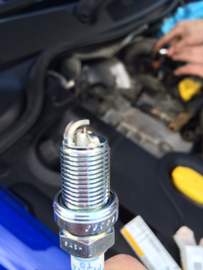

and in with the new

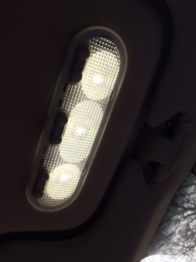

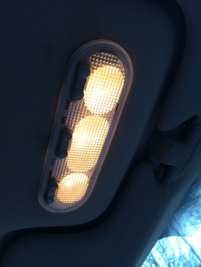

I ordered a pile of LEDs for the interior. Changed them all over from the standard ones, a much better clean light now inside.

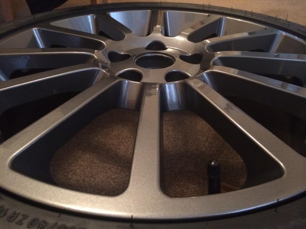

Although its an F1 and wanted to keep it looking as F1 as possible i really loved the look of my wheels in Anthracite. My wheels where in okay condition with no markings just a patchy on the paint. The tyres were on the limit and i took a corner too tight and fast and slightly slid and marked my wheel.. just an excuse to get them done!
So from black to
To compliment the newly done wheels..

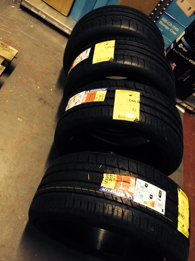

Michelin Pilot Sport 2s - A tad more expensive than PS3s but they're suppose to be noticeably different between the two.

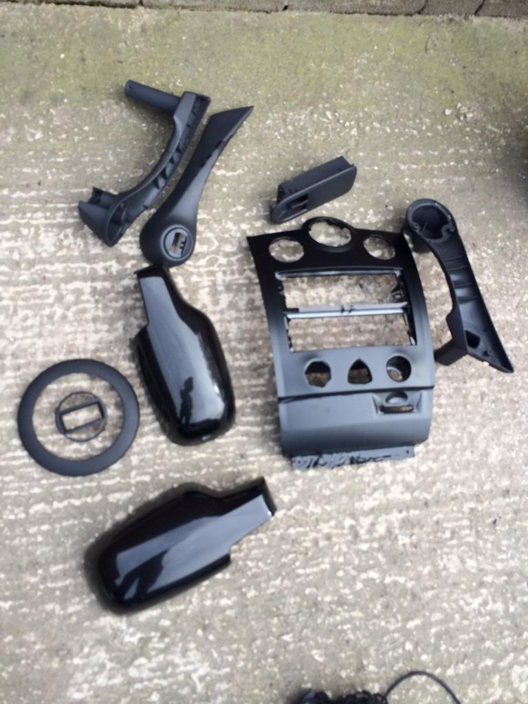

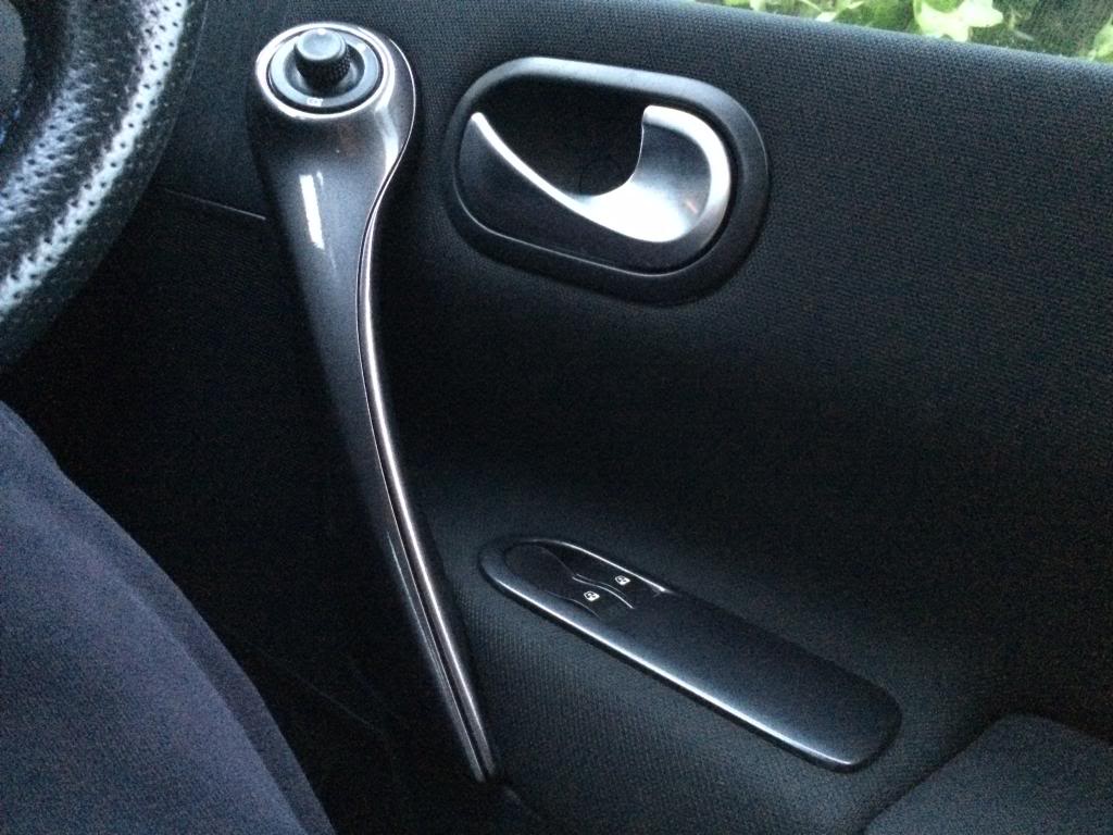

So obviously the black mirror caps didn't match now so i thought i would get them done and a few interior parts done too at a bodyshop.
Didn't get all the bits pictured but..

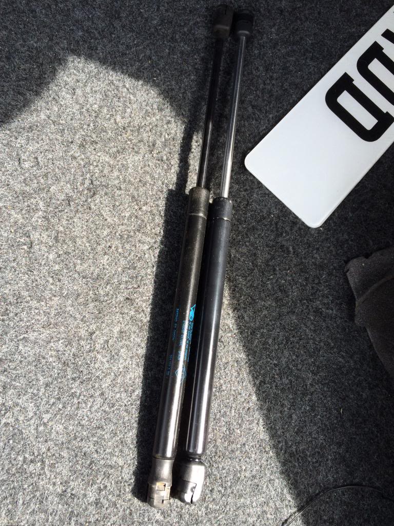

Also changed my boot struts as it just didn't open right.

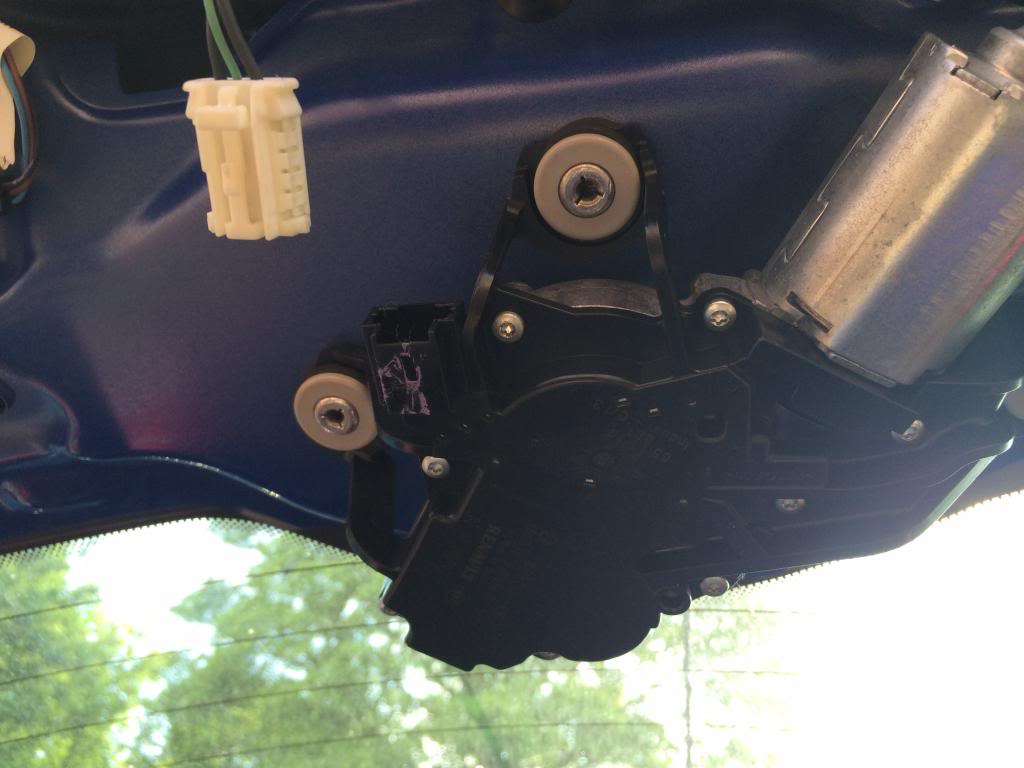

At the same time i decided to unplug my rear wiper as i never use it and hate it when it accidentally comes on when going into reverse.
