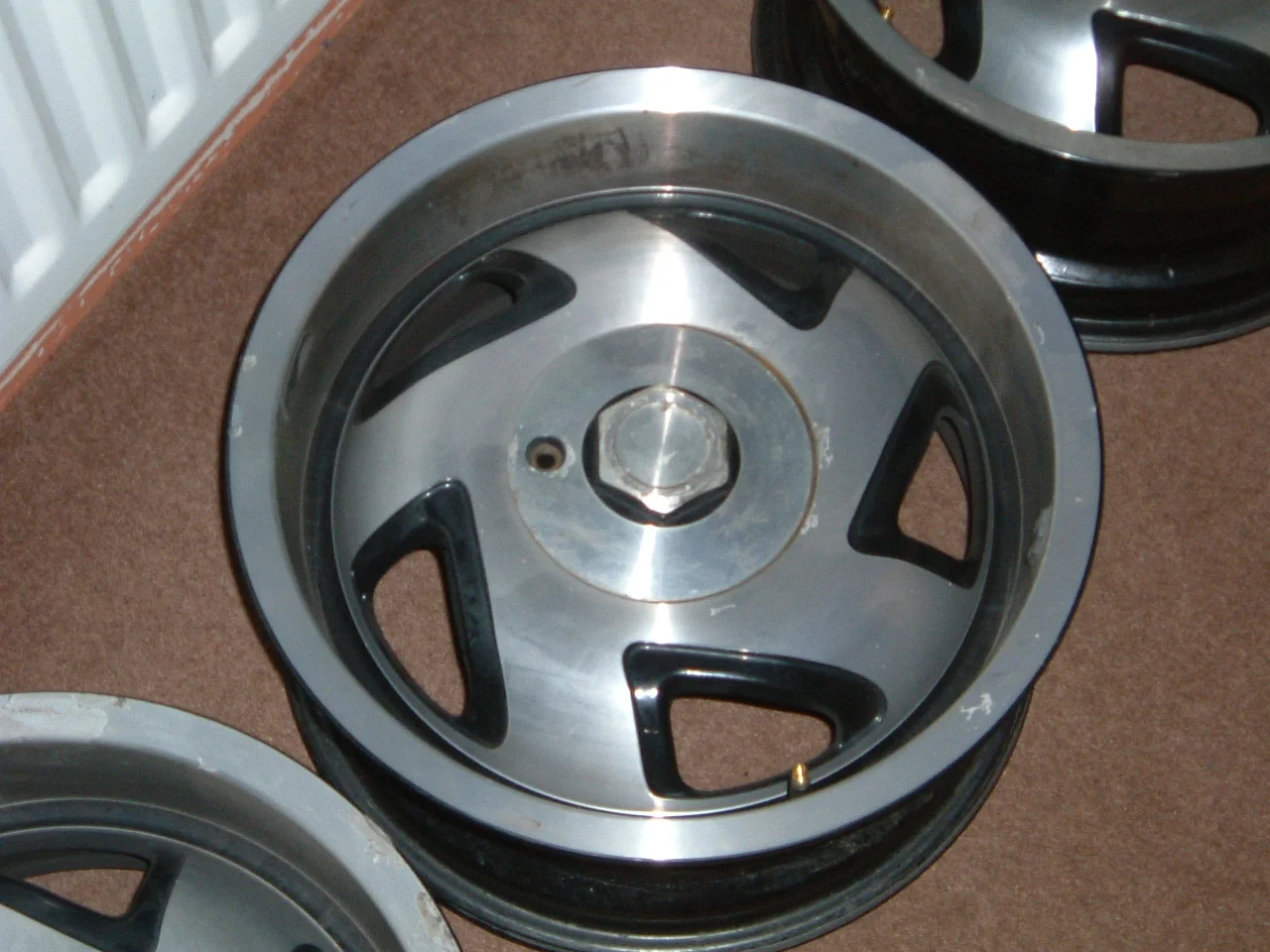

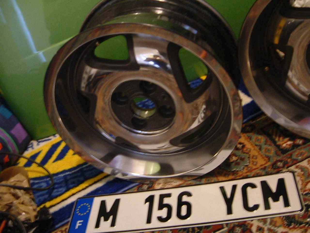

From this.... to this.... and then to this!
Bought these wheels off of german ebay. Apparently they came off a Nissan a long time ago!
Polished them up by hand and repainted the detailed bits on em.

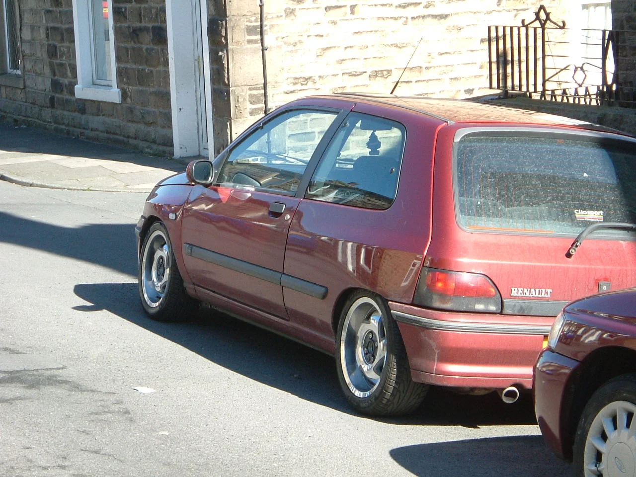

Now they're on my car but i cant drive it cos the rear is too low and it just scrapes on the inner arch so im gonna have to raise it up this weekend and put some new shocks on it cos the old ones are fubared and that wont be helping the situation!!!!
What everyone think???
P.S i know my car needs a wash but i was too eager to put them on and see what it looked like and then once i realised it wouldnt move with em on i decided to leave it and had to come back to uni :(

looks great mate you've done a top job cleaning them up:cool:

they are 15x7 on an et28, the same as the Ronal Turbos that just came off(which didnt scrub which is kinda weird) so they stick out a little in the arches compared to the Ph2 wheels. Cant wait to get the suspension sorted so i can clean and drive it!

Quick point - in the pic when they're on the car, haven't you got the tyres on the wrong way? i.e. they should be on the other side of the car as otherwise the directional abilities of the tyre to disperse water will be all fucked up and create, er, 'interesting' handling... lol
It would appear that way from the tread wouldnt it but they were all marked up by the tyre fitters as to which corner each wheel was intended for and i put them all on the right corners. I also checked the directional indicator on them all and they point the right way!
The tread does look wierd tho, you got me thinkin now! gonna have to check them all this weekend when i get home again! Are you the guy who bought my Ronals mate?

They are definitely wrong as the tread is supposed to push the water out the side as you go along, not force it into the middle! Post up a side on pic of the wheel so we can see the side markings and see if you're being silly ;) lol
