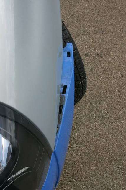

Just noticed my front rs bumper has come apart from the driver side wing, ive looked under the arch but cant seem to work out how it clips/goes back together? What should i be looking for?
my bumper looks bit like this at the moment...
how does it screw/clip back in :S
just give it a slight bang with your fist, itll clip back in. it should have 2 bolts holding it though. one bolt being where the right hand side hole is in the above pic and bolt 2 in the left hand hole that you can barely see near the headlight.
