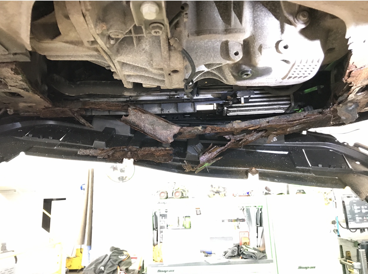

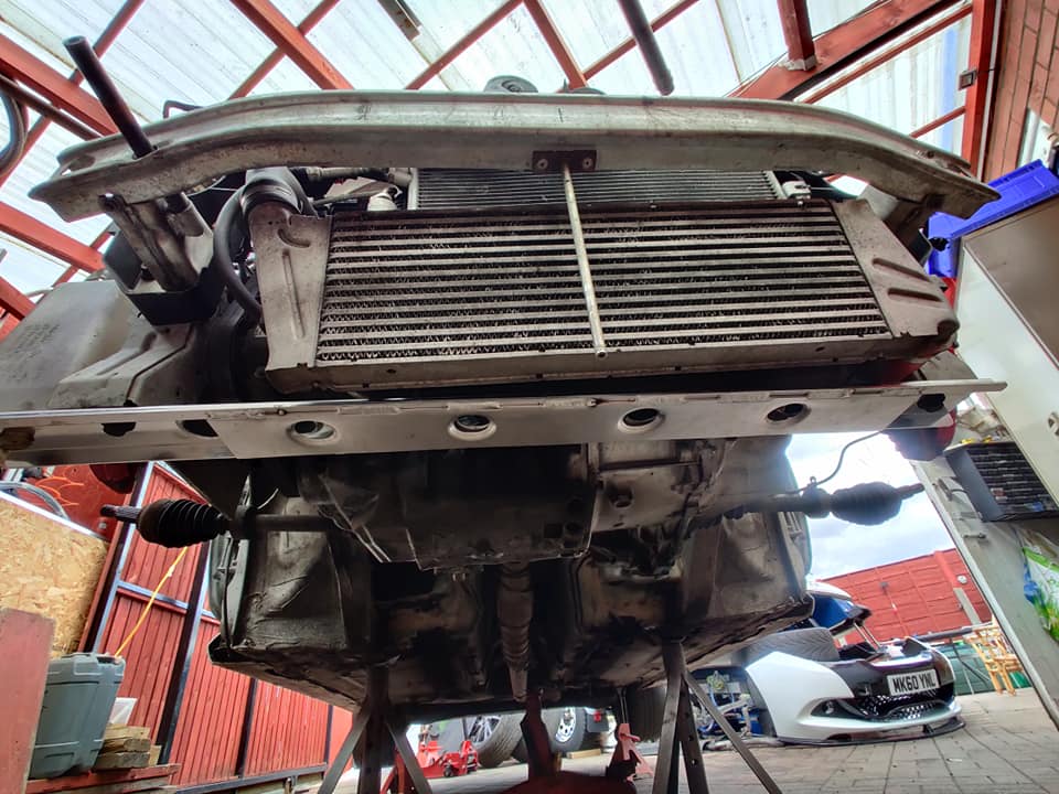

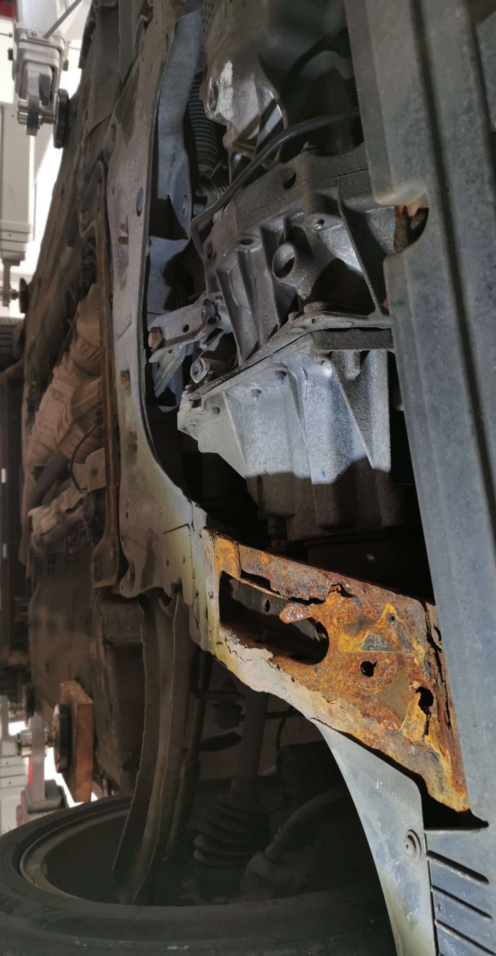

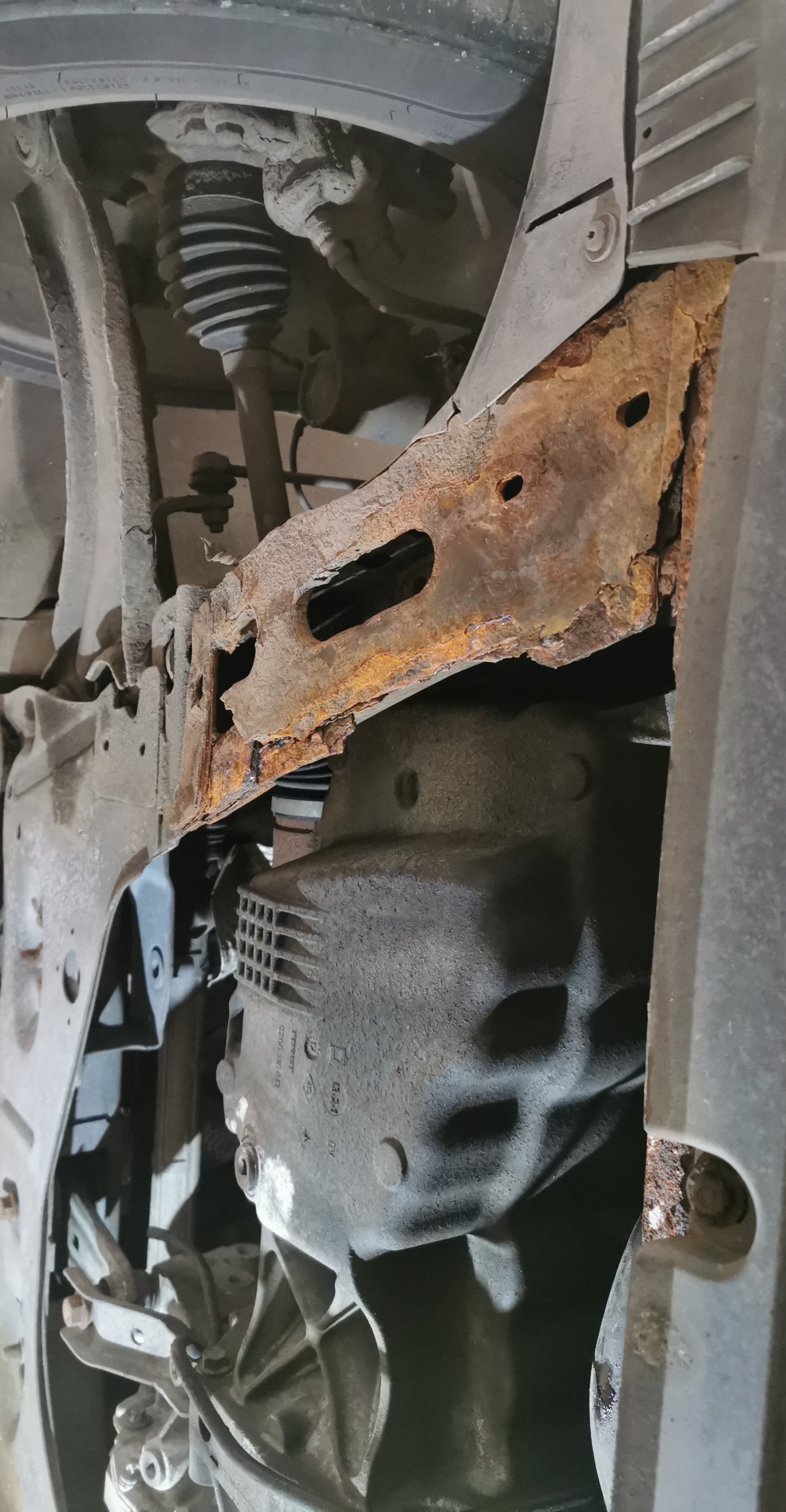

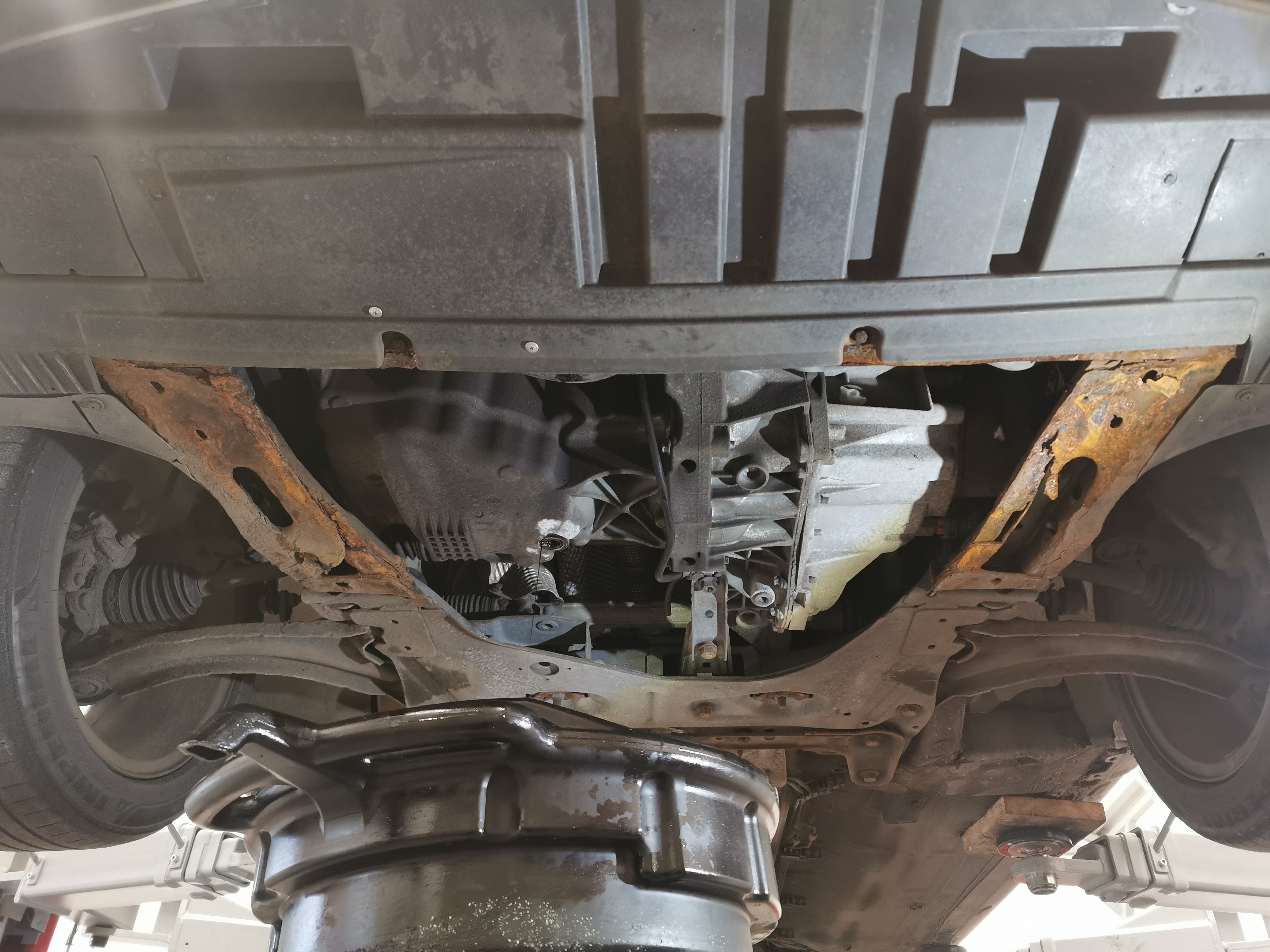

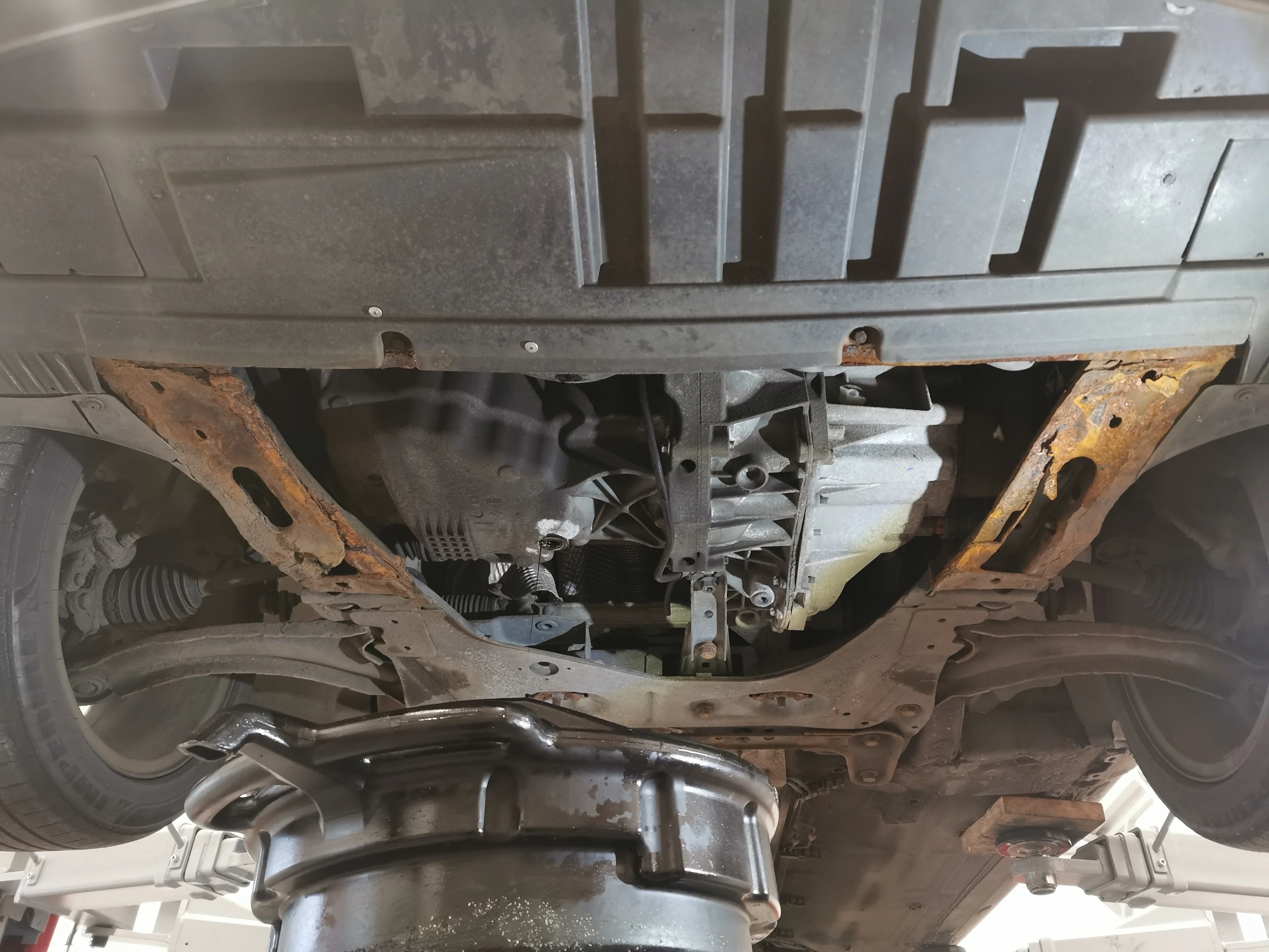

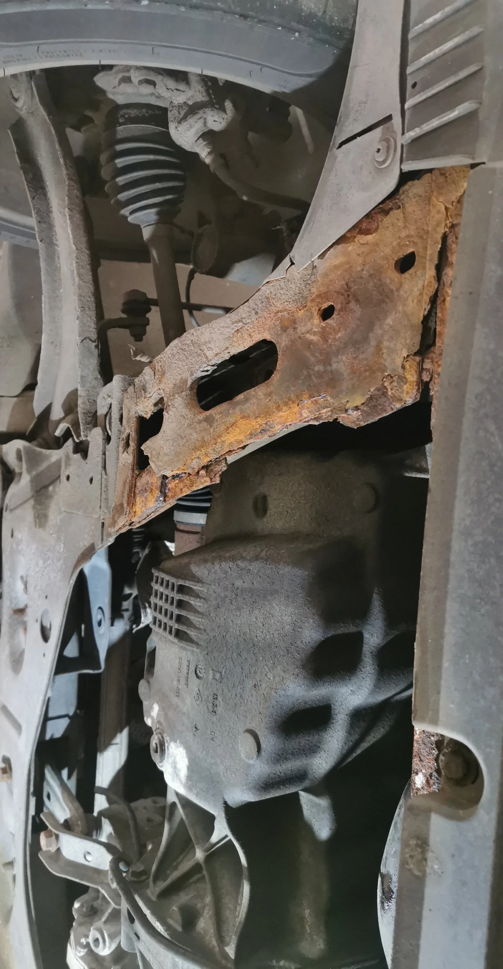

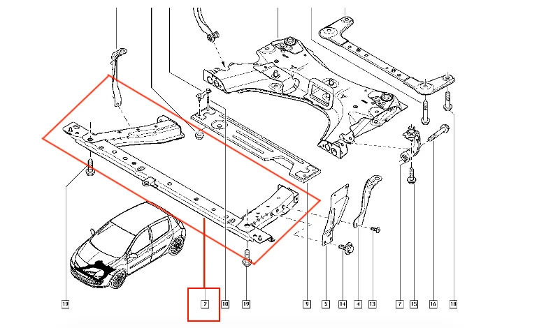

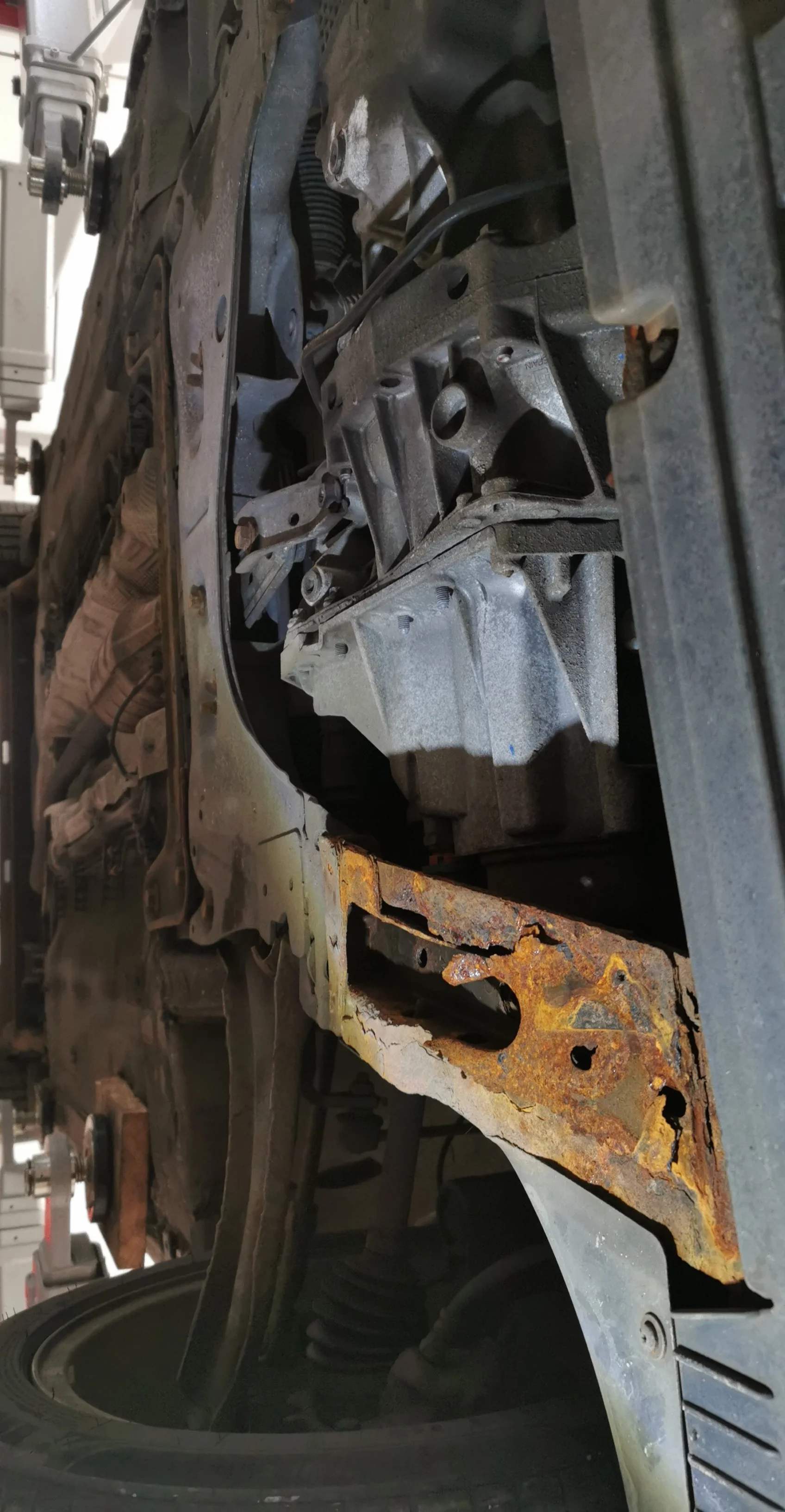

Does anyone know the correct term regarding bits of the front chasis that has corroded so I know what to order to replace. Thanks

Daniel
  Whichever has fuel
You need a new subframe mate.
Buy a good secondhand one and send it to be shot blasted and powder coated and you’ll be fine for years.
Louis
I Park Like a C**t

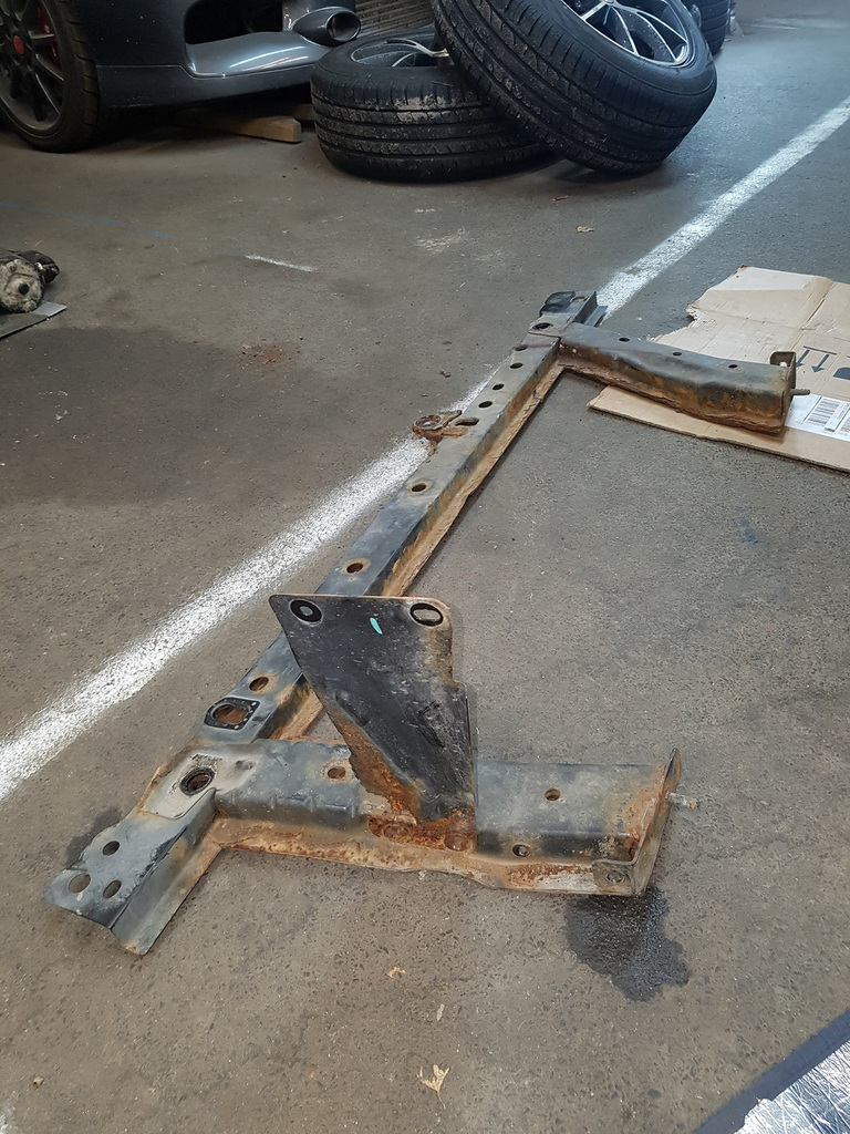

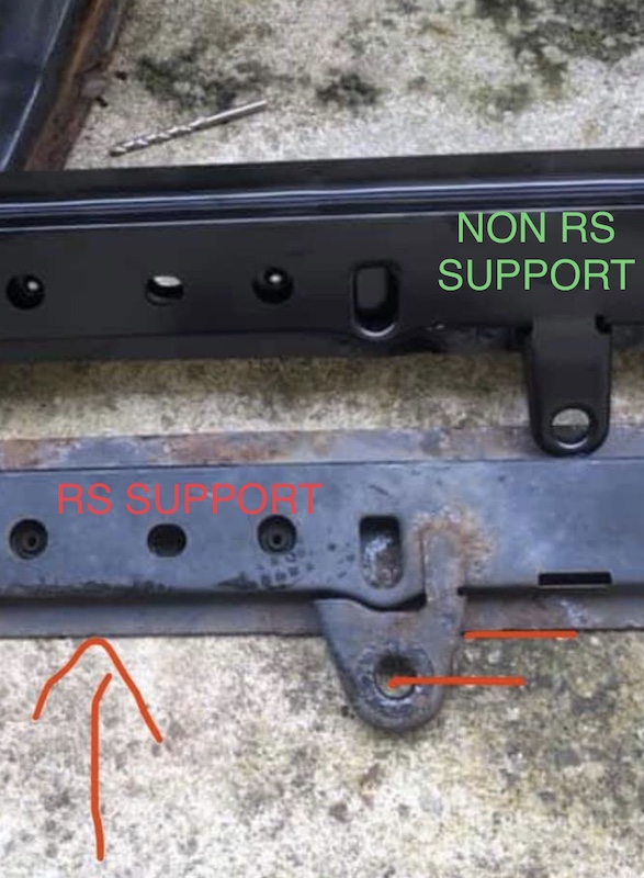

You can buy them cheap from ECP but make sure the radiator bracket bit at the front is in the correct place.
Louis
I Park Like a C**t
My brother did one where the customer supplied the part. Customer had it all powdercoated in preparation for going onto the car.
Came round to fitting and it was the incorrect one with the bracket in the wrong place so he had to cut and reweld it 🤔😂

Trouble is the s**t shield keeps things nice & wet in there.

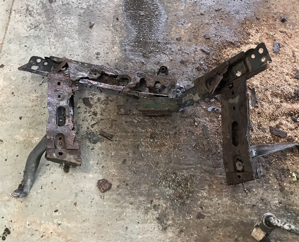

Mine was on the car 1 year and 1 month and it was starting to rust already.
Dom_capper
  2012 Renault Clio

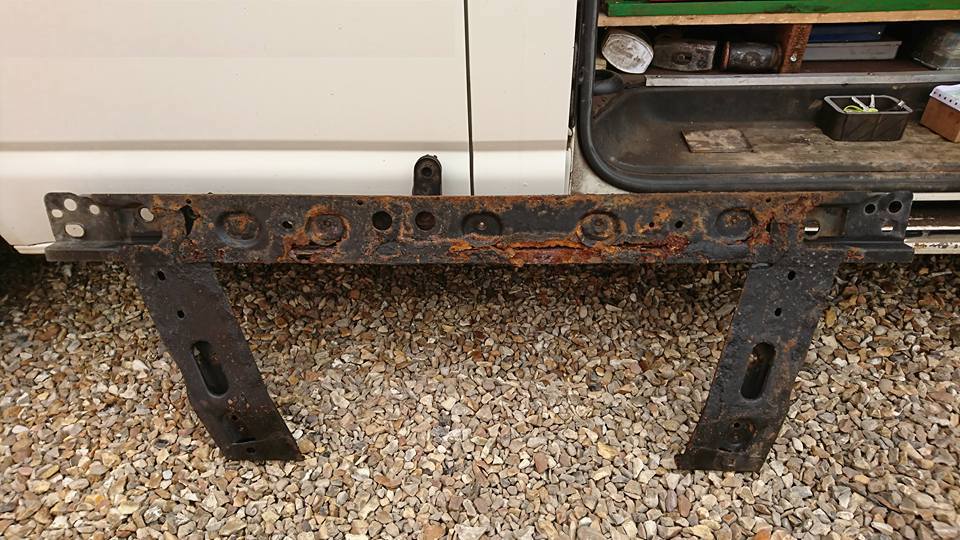

Mine is disintegrating badly, radiator is still held solid.
2012 car and the only rust on it really. Seems they are made of cheese.
I’ll change it when it gets worse. £70ish on eBay but seems they rust for fun.

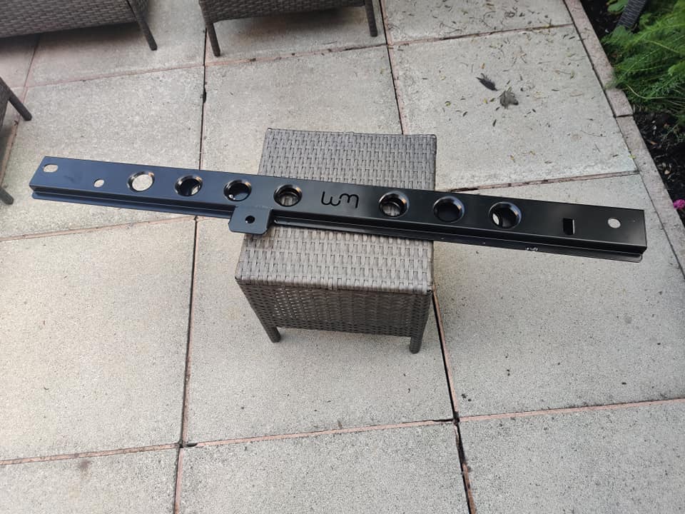

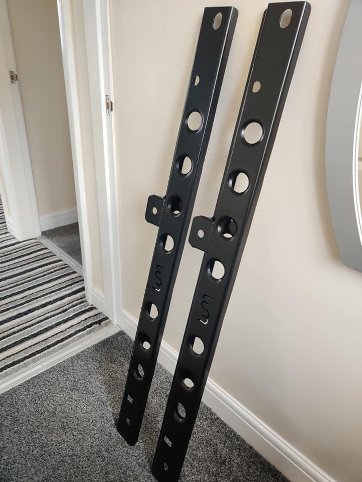

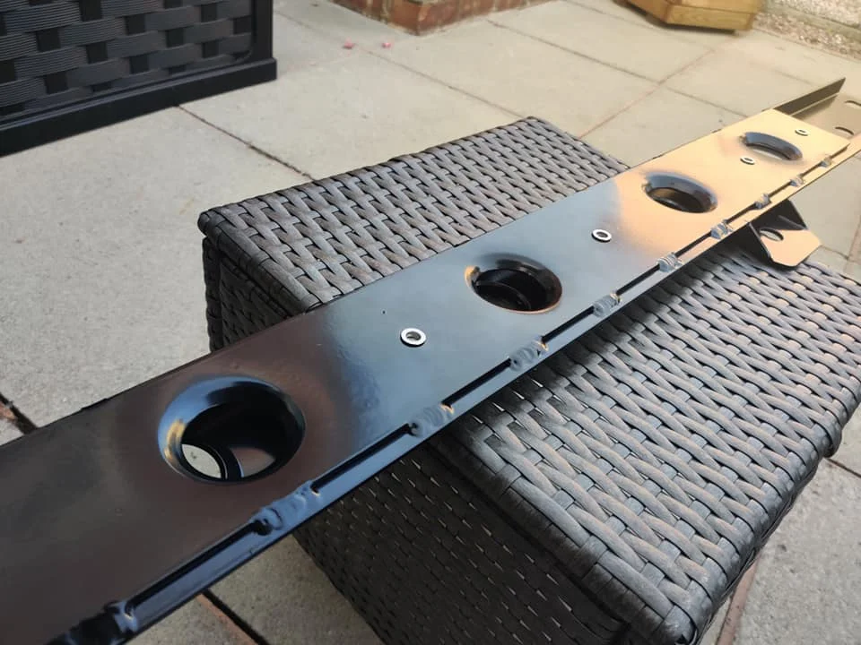

Guy called Josh Wheeler on the Facebook groups makes them.
Aluminium Radiator supports back in stock at WheelerMotorsport!
I've just got a new batch back from coating.
Direct fit radiator supports which will not rot and corrode away like standard and offer a nice weight saving.
7 currently in stock first come first served.
Usually £150 posted but I'll do 20% off the first 5 at £120 each delivered. What a steal!
