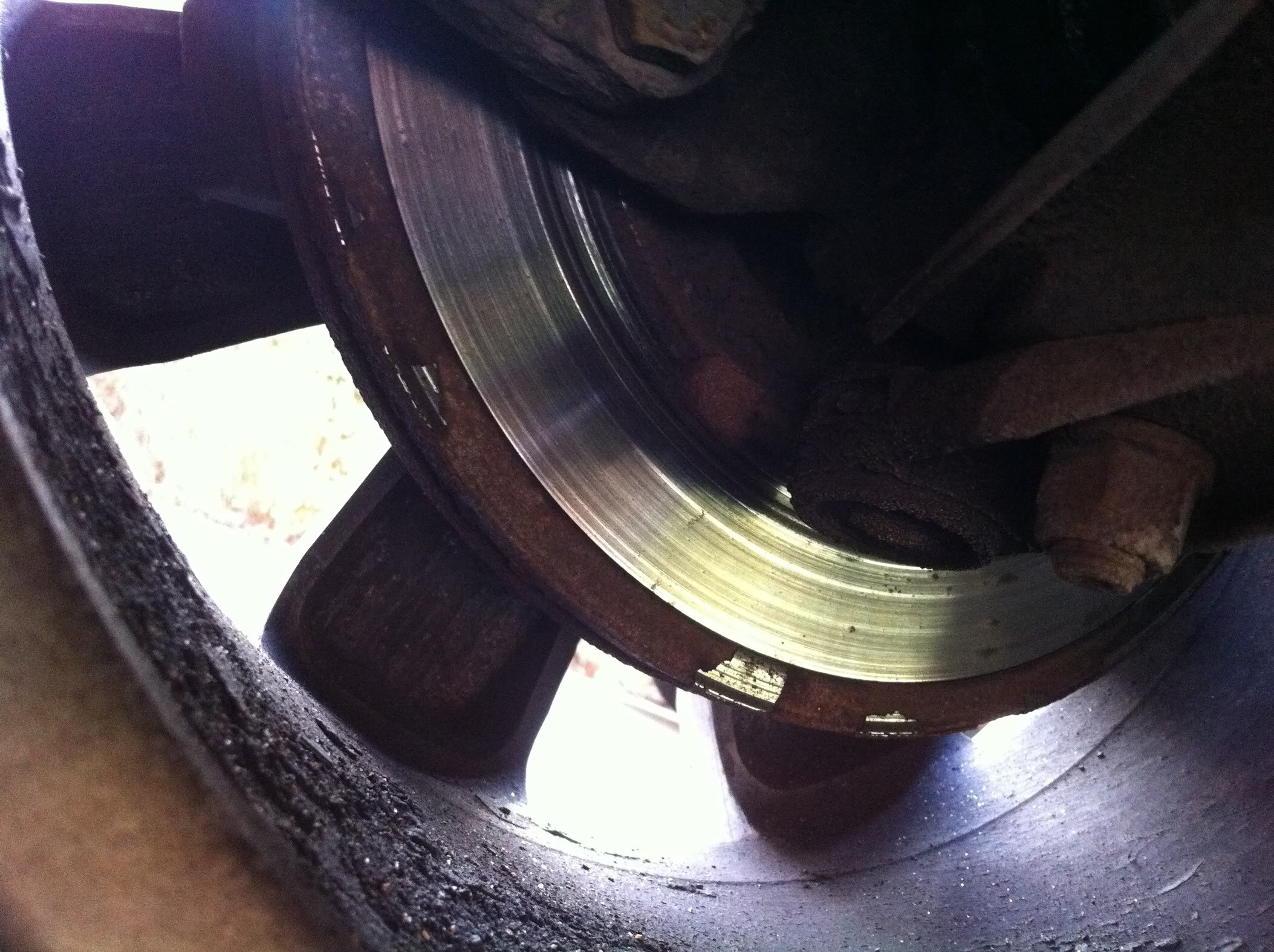

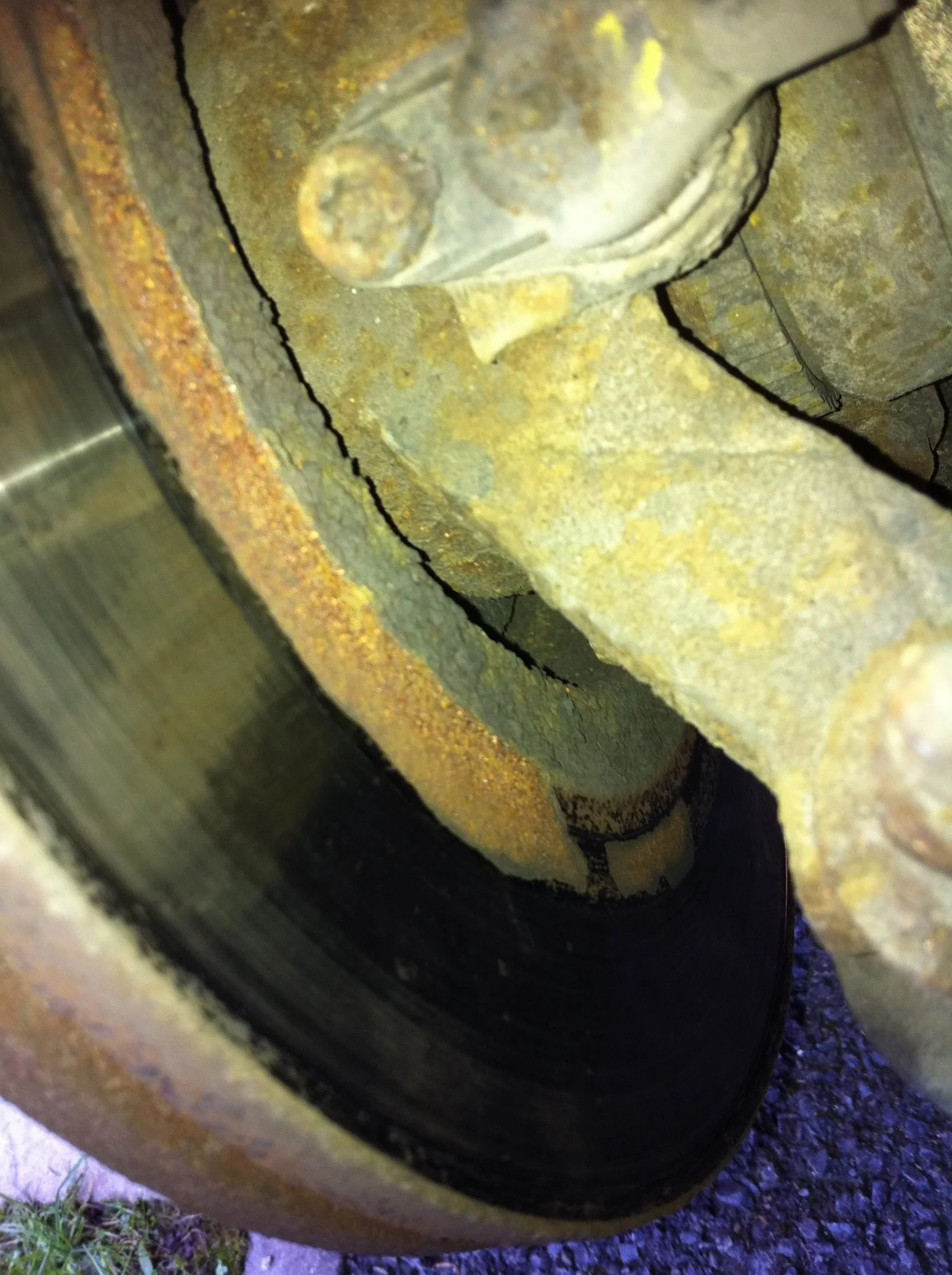

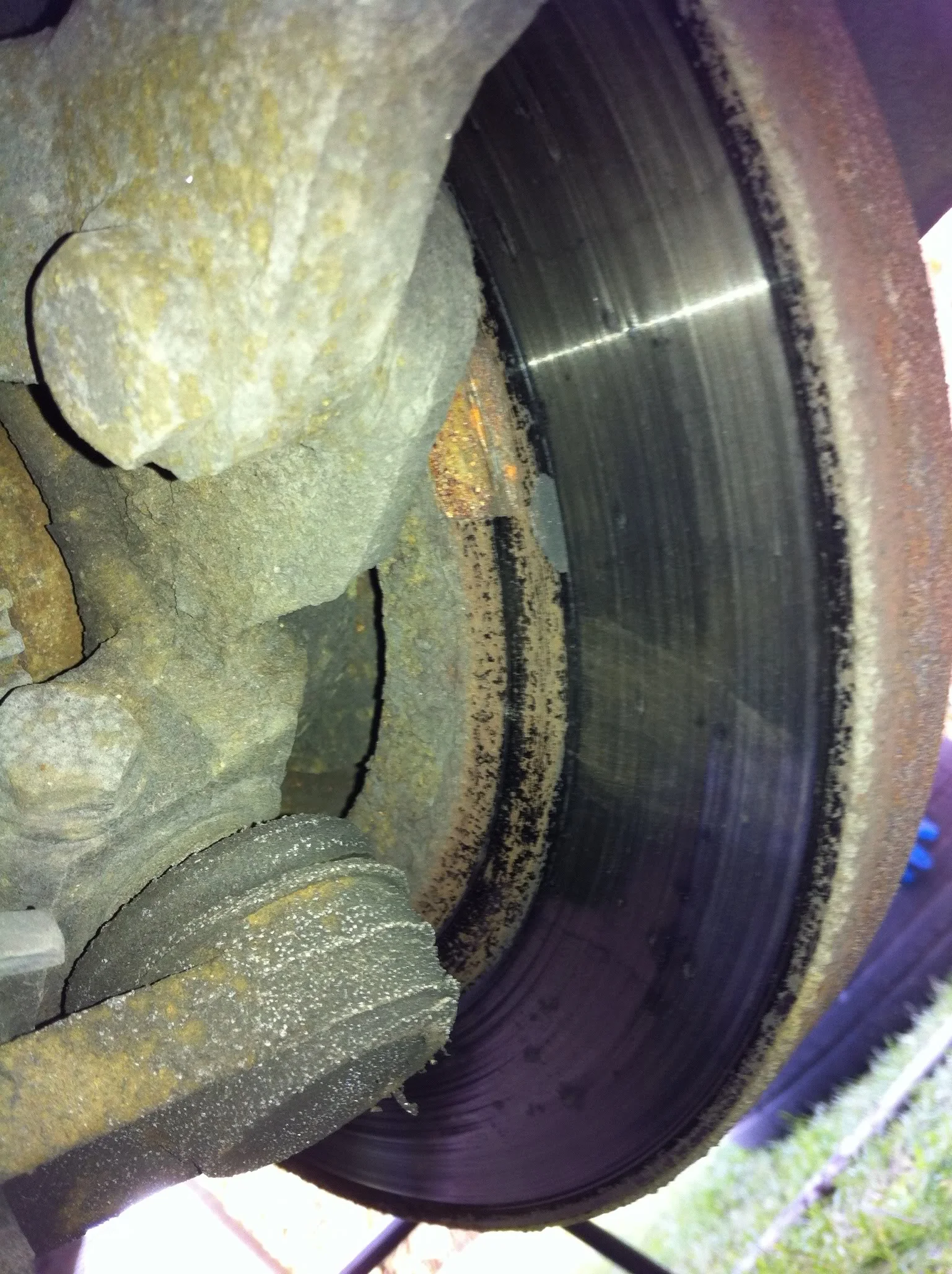

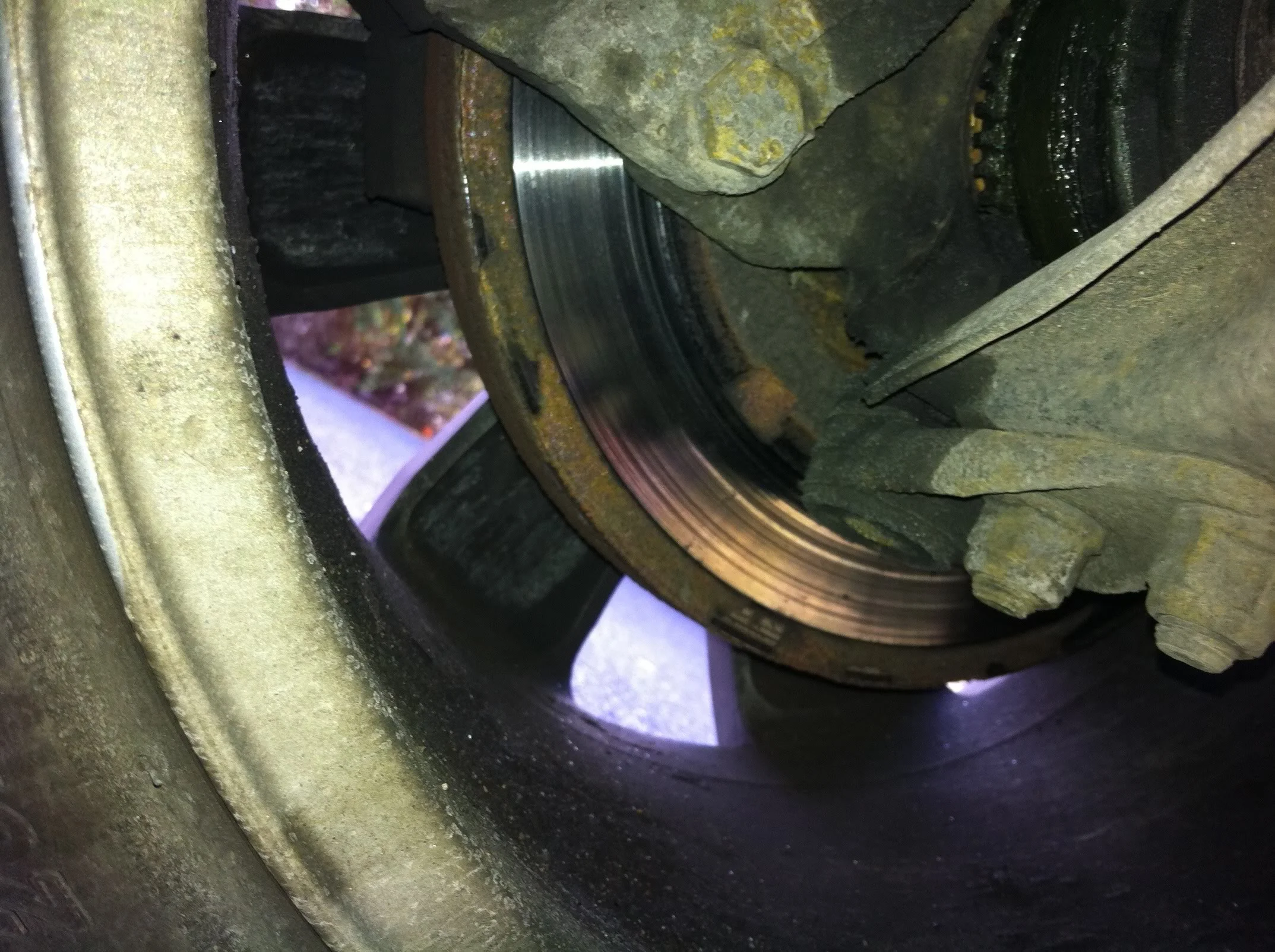

after an annoying squeek me and my dad decidied to have a look and see if we could find the problem, and found something else (which may be causing it anyway)
Here's some pics of the driver's side:
And the passenger side:
Now clearly i need new discs theyre fecked, but do you think they'd be covered under the Renault Extended Warranty? i can't imagine it's been done by me overheating them or anything (i've never pushed it that hard), so i'm wondering what to do? I'd like to uprate them, but wondered if you guys know where i'd stand warranty wise!

Most warranties will not cover serviceable items like discs and pads.
I'd just go buy the uprated ones and get them fitted asap :)
Check your pads. Squeaking is normally there to tell you they're getting low on meat.
Won't be covered on warranty ! If they're only a week old take them back. Clearly however, they are not.
I assume you've noticed your f**ked CV joint boot? The rusty bits that are breaking off are just bits of rust that have built up because the pad is not touching the brake disc.
How long have you had the car? If you bought the car yesterday say and you noticed the discs were like that then they would sort it out. Otherwise they wont touch it just normal wear and tear same as the CV click.
Before going Check the CV joints, the clips are known for popping off ;)

It's pissing out grease on the pic!

you need new front disks and pads, and if you have clicking on cornering then due to the CV boot leaking all its grease out, you'll need a new driveshaft too. All wear and tear items

If it was me, i'd be taking it to fred, paying him some money to write you a problem list and take the s**t back! Look at the state of it!

as a guess (it is a sunday remember, so don't quote me) no more than about £150 to sort that out, need to see the car though really, then i could advise you what should be sorted on warranty, brakes - no chance IMO
