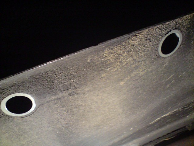

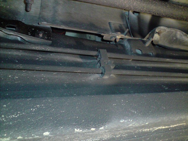

i shall go look by the heat sheild take a picture and show u what i can see!
but tbh cannot see any other bolts
rite these the two i found! with rubber grommets
cant find the other two!!!
I've circled where i think 2 are, little hard to tell from the pic, the other 2 will be opposite those.
They are behind the heat shielding, so are a little difficult to see unless your right beneath them.
think ive found them:P not too sure yet tho as ive not got the last bolt off ! its abit stiff
