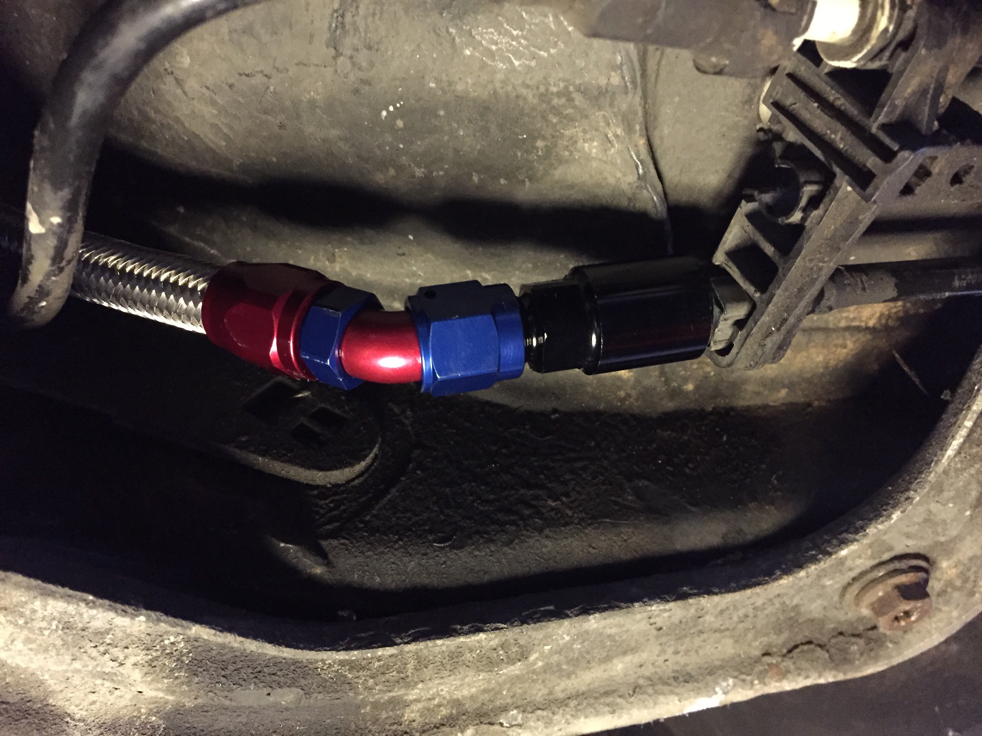

This is where and how I connected my braided hose.
