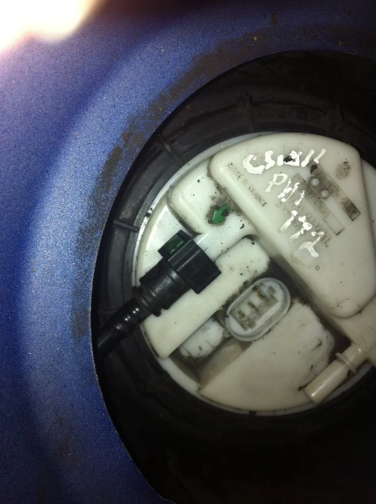

I have used a PH1 fuel rail with a 3 bar regulator. using the ph1 fuel sender unit as that uses a fuel return line i will try and grab some pics for you
Thats the only pic i could find. PH1 sender unit. I got mine from cliospares. the fuel rail is similar to a PH2 but has another fuel line on the opposit end of the rail nest to where the FPR is located
Thanks for the photo and look forward to seeing your setup Tony!

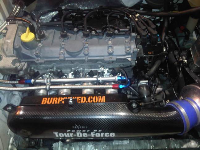

The ph1 setup allows a fpr to be used on the return line and as I'm going turbo I wanted a fpr.

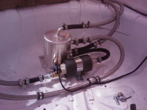

if going the swirl pot/uprated rail route there is a better/simpler way to do it than what we have but we left ours as it was as it was easier to fit the rail and new reg into what we already had.
