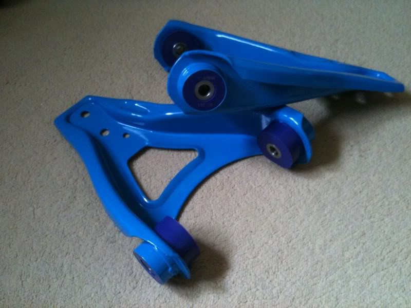

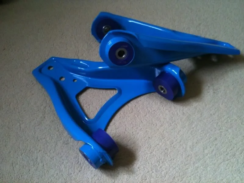

my can has just failed mot because the sleeves where welded in b******s
You can just..about see where they have been tacked.
Any decent garage will be able to do it, just make sure they prep the area for a clean weld.

iv just had mine welded and they did 3 15/20mm welds around each sleeve? is this bad?
yes the bushes go in fine? just wandered is they had to be spot/tac welded rather than a full weld?

I was getting them powder coated anyways and i thought the blue looked different lol :cool:

Also As far as welding on wishbones It hasnt been repaired and significantly weakened by the welds has it? Therefore cannot be failed! I own an MOT station and have thorough knowledge of the book!
However load sensing valve linkage missing is a straight fail if fitted its gotta be working!
I put mine in without welding for the MoT as was a bit short of time. I'd done less 100 miles by the MoT and one of them had popped out, but the guy showed me but said it wasn't an MoT fail, so can't see why he failed yours.
I've welded them up now.
