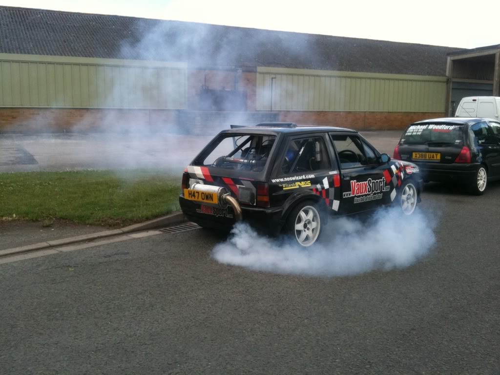

Bit of an extreme example but I was trial fitting a new engine into my nova as I decided to convert from the previous calibra turbo engine to a Saab turbo one, I didnt want to spend money on building a big spec saab engine initially so to make sure it would work I just fitted an old snotter of an engine to use so that I could make all the engine mounts up etc. And then I figured while it was in there before I took it out and binned to fit a rebuilt one I may as well just fit a massive turbo, and a big set of injectors and crank the boost up on the one thats in it and remap it to see what I could get out of it just for a bit of a laugh really as it was disposable.
Was making probably somewhere in the 450-500bhp region or so with over 2 bar through it from a GT35R turbo when the corroded 20 year old head gasket decided that enough was enough with that sort of pressure in it and it broke through from the combustion chamber to the oilway, didnt lose any water but lost plenty of oil.
If you look really closely in this picture, I think you might just about be able to make out where some of the oil went, lol
