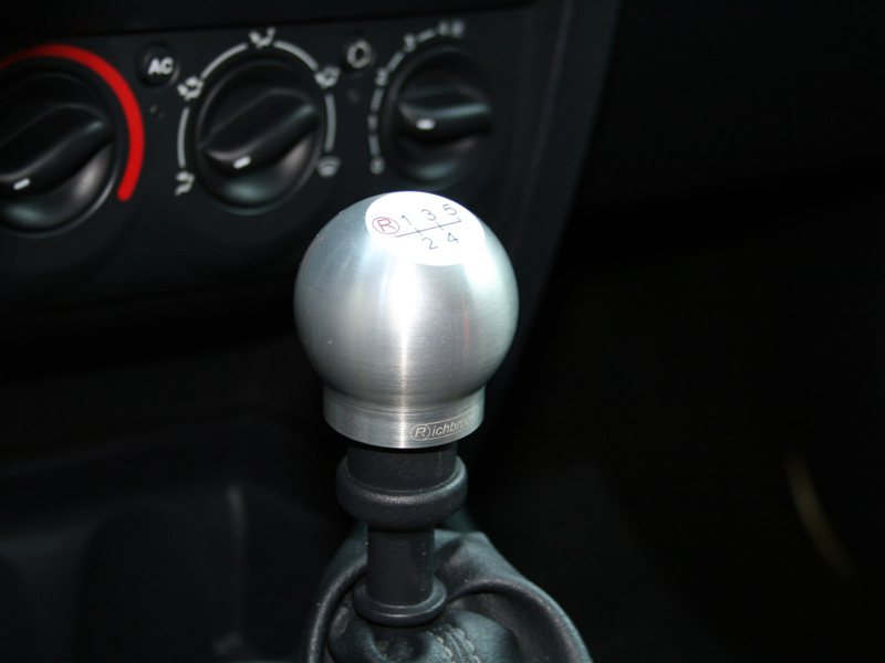

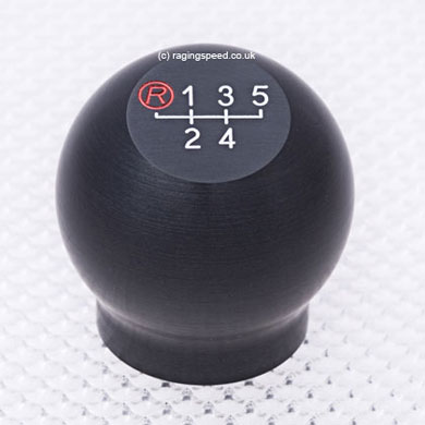

The only one you should look out for is a PH1 172 Gear knob or the MK1 V6 gear knob.
Nah man... those look garish!
Richbrook, slanted...
