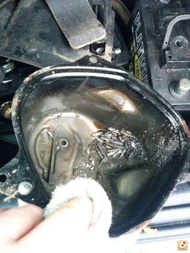

I've just taken the end cap off my gearbox this morning because it was wining since I had it. About a week ago I lost 5 gear. The gearbox is buggered now!
The oil was black and hardly any left, change the oil and fix the leak and you may get a couple more thousand out of it while you get a new box sorted.

This was what I found!

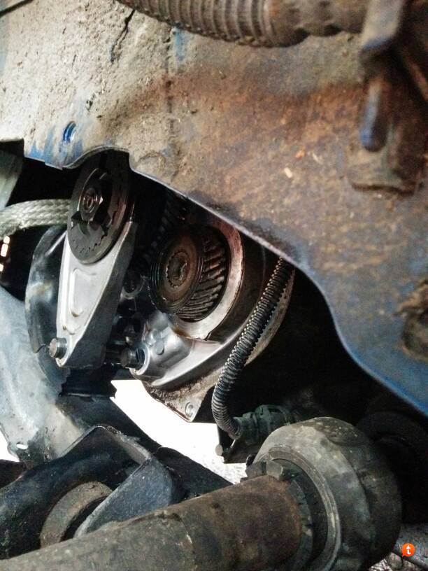

Here is a photo of the end cap of the gearbox, you can see the nuts here, you can get to this under the car without taking too much out.

Thanks for the reply .. can't figure out what I'm looking at tho :-( Front N/S, wheel off, then bottom of the picture is drive shaft (still in place)? and wishbone? And then .. errm .. bit lost. Something's been taken off? then what would need tightening?
Local independent Renault place seemed to think that to take a look and diagnose they'd need to drop the gearbox which would mean a new pump when they put it back together or something .. got a bit lost . Any help much appreciated.
