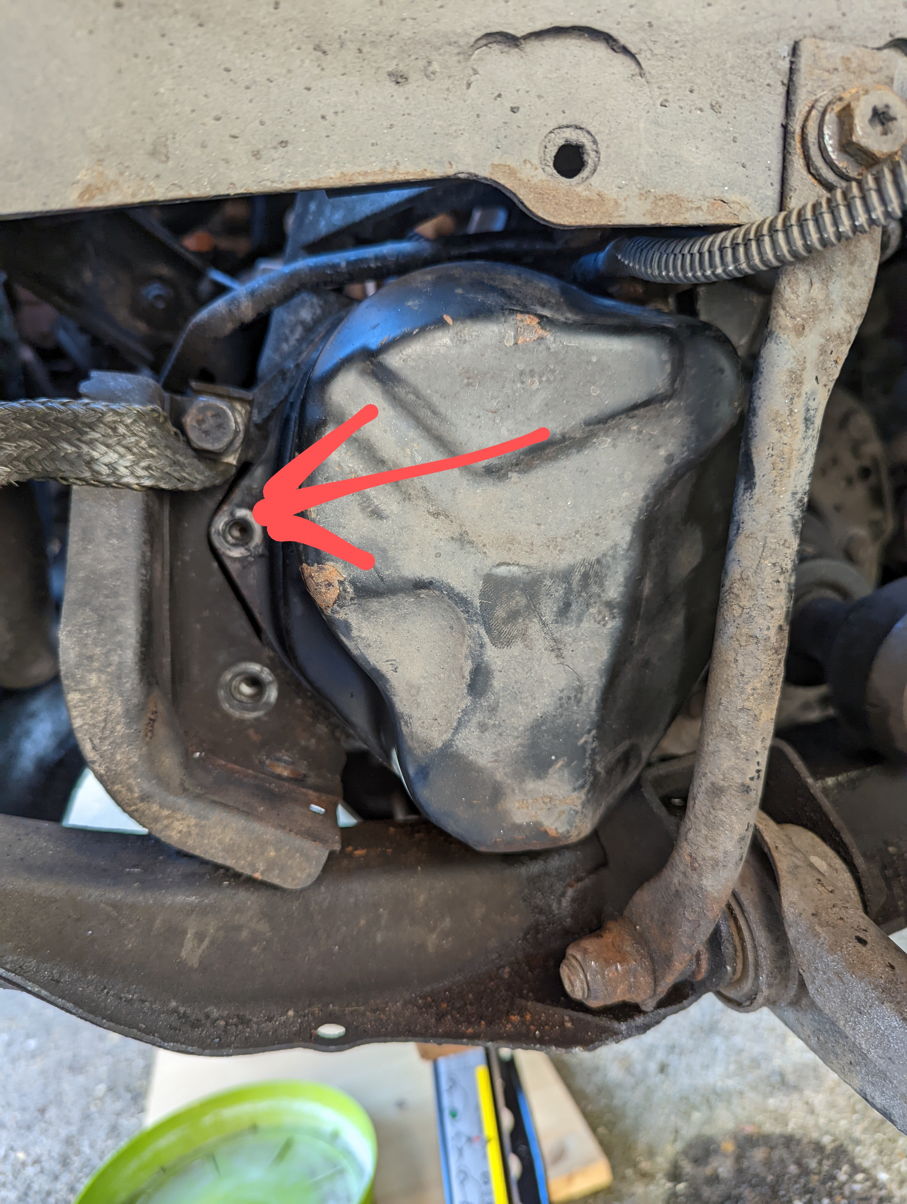

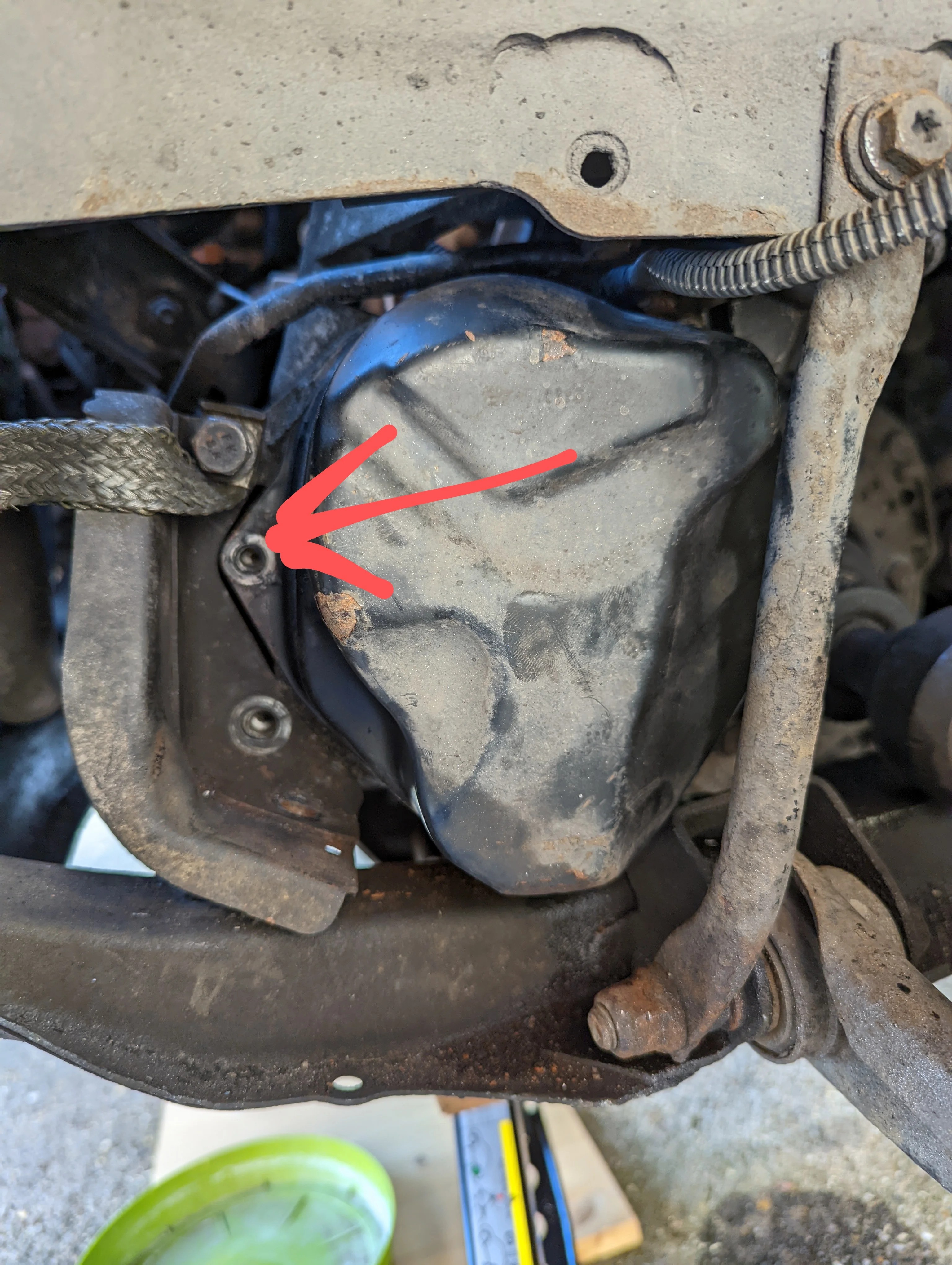

Drain the oil out of the box and lower the gearbox down on to the subframe.
There’s a black end cover on the end of the gearbox that’s held secure with 3x 8mm bolts (13mm socket/spanner size). Remove the bolts and drop that end cover off. It’s a bit of a faff as there’s a oil feed tube in the end of the cover, but it’s definitely doable.
Once you’ve got that off, take a picture of the gears and shafts that you can see and upload it in here. Plenty of pics from as many angles as you can mate.
Tag me in here when you’ve done it and I’ll be able to tell you if the box has to come off, or if it can be fixed in situ. 👍🏻

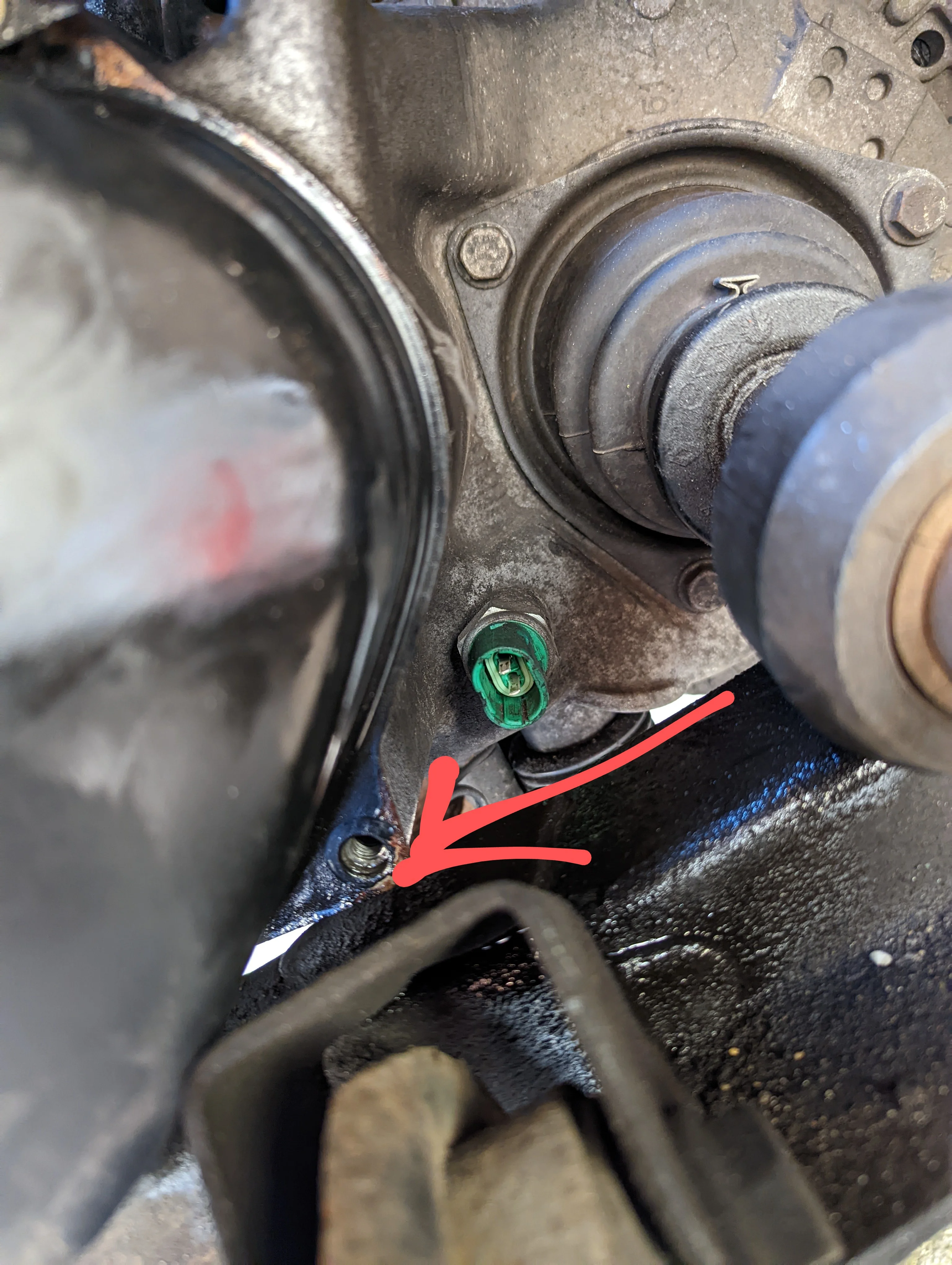

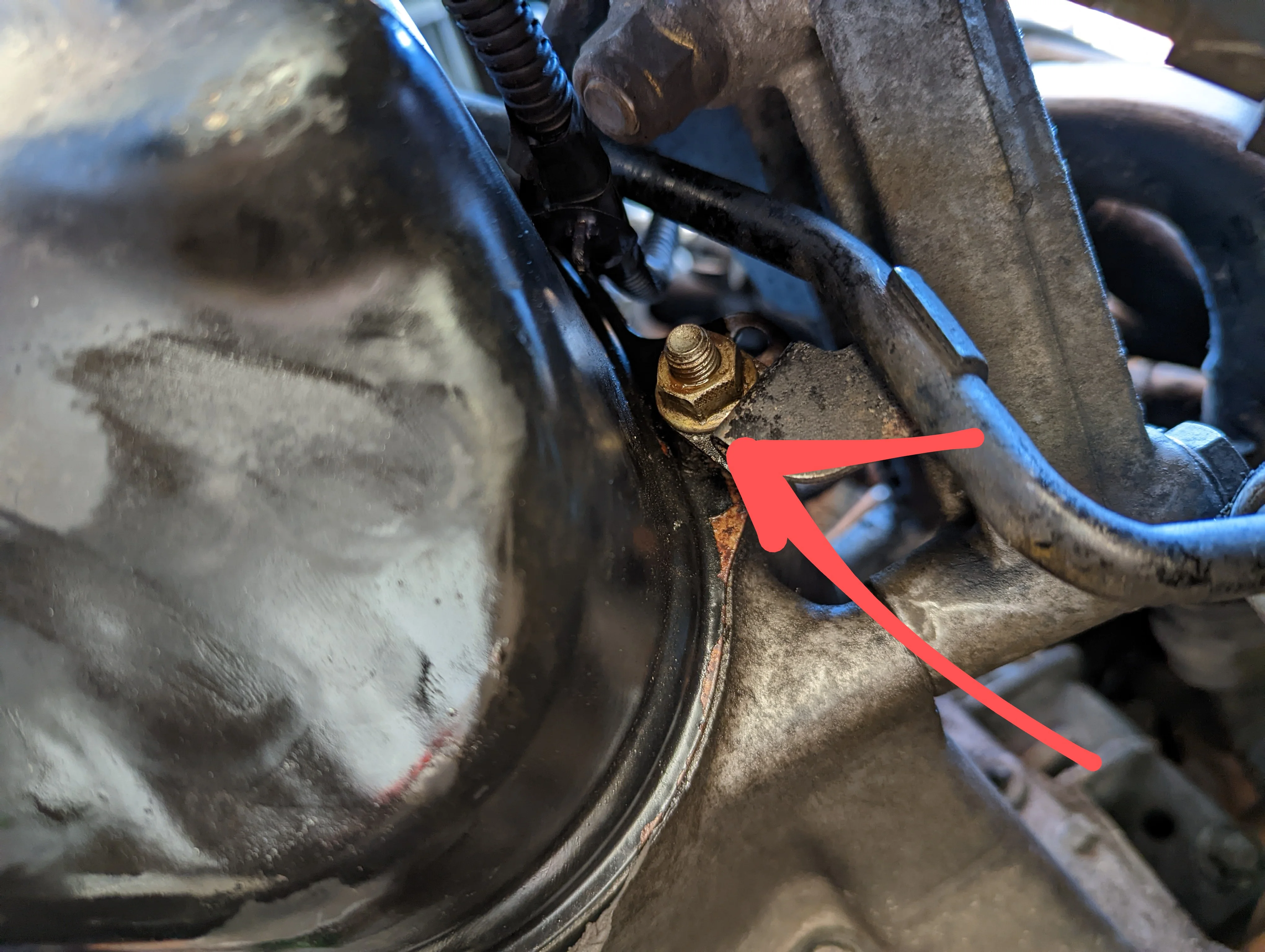

do we I need to drop the actual subframe itself to get the black cover off or will it fit ? Seems like a tight gap 😁
It will come out with the subframe on and the box dropped

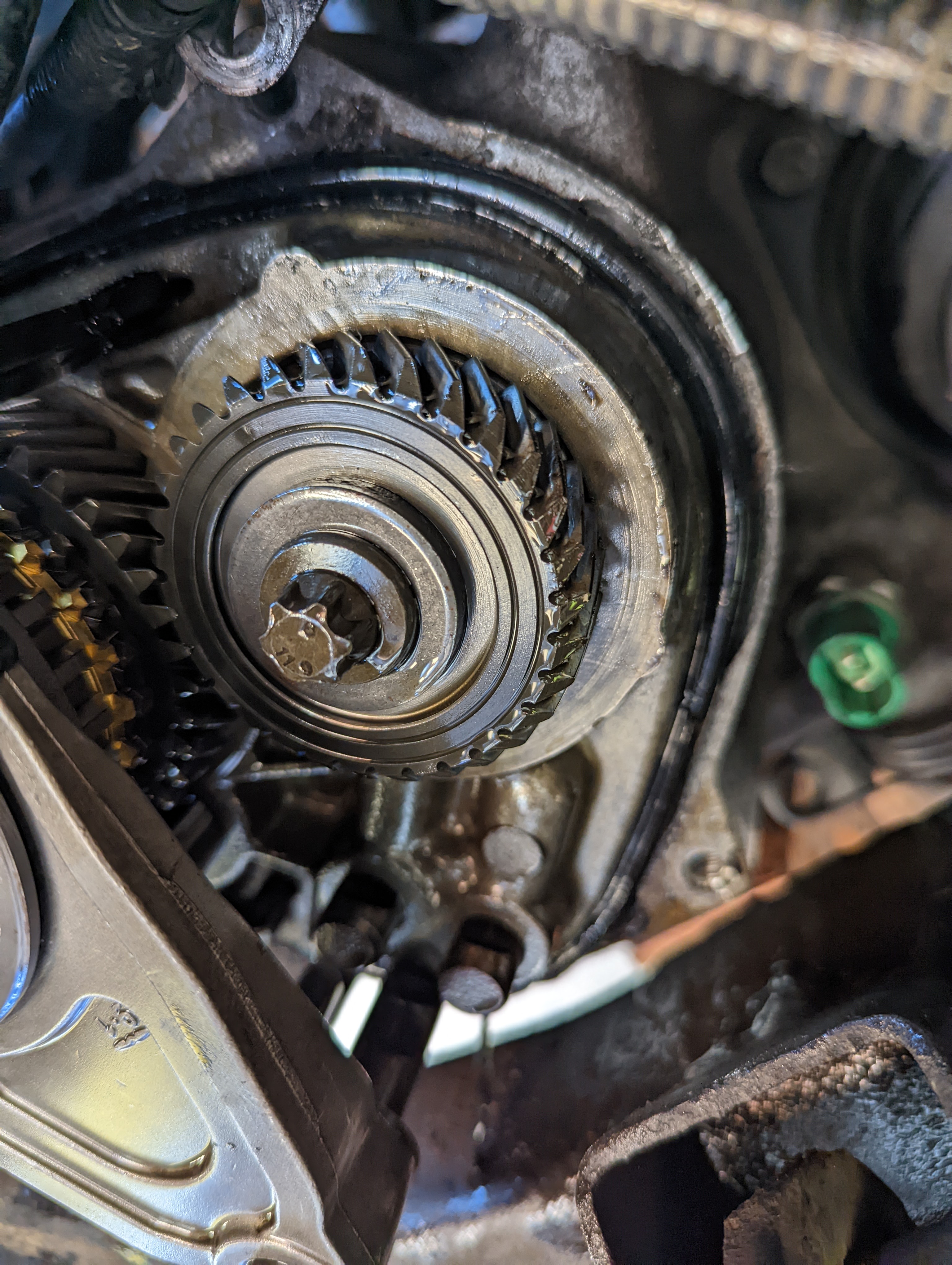

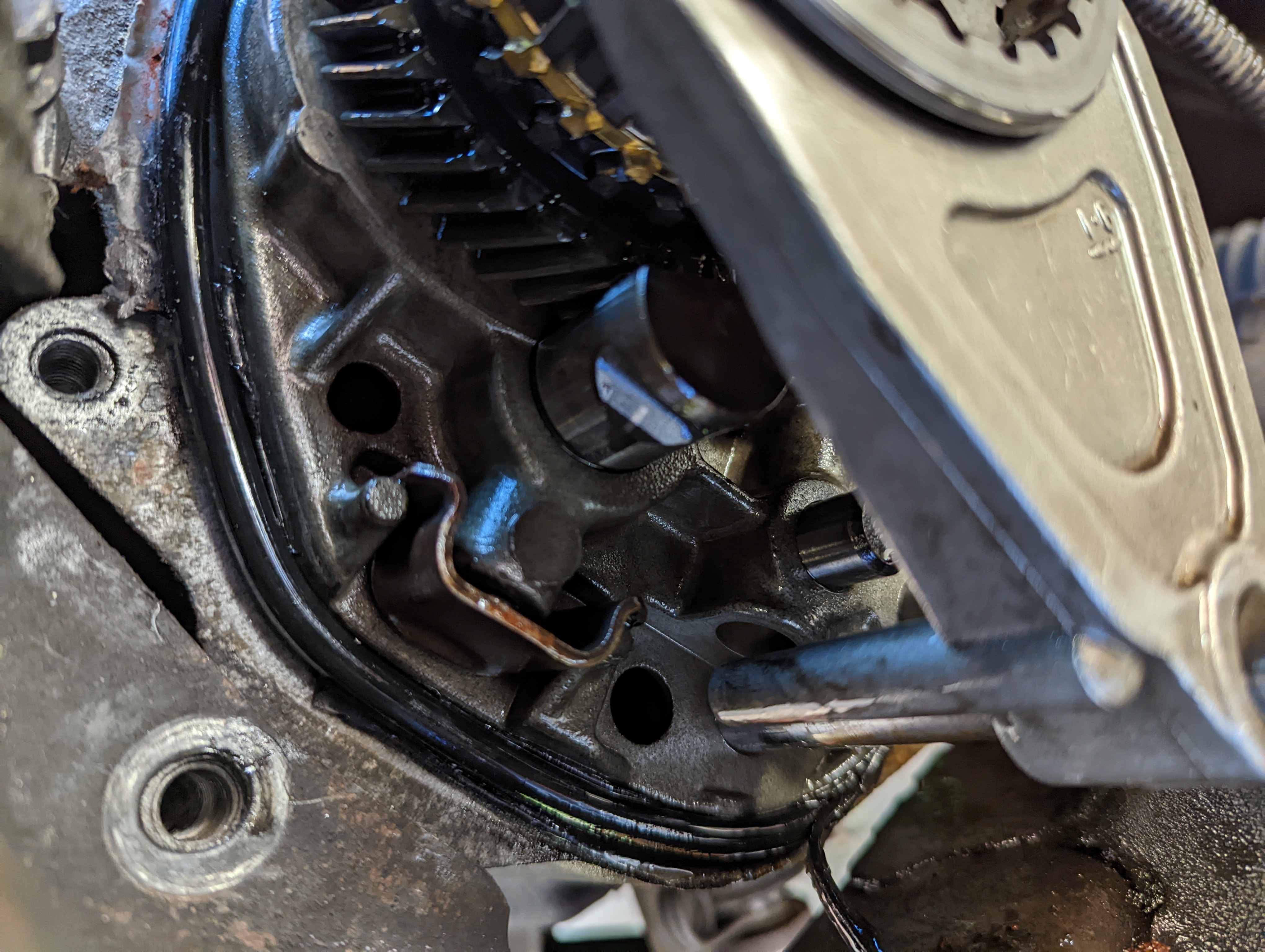

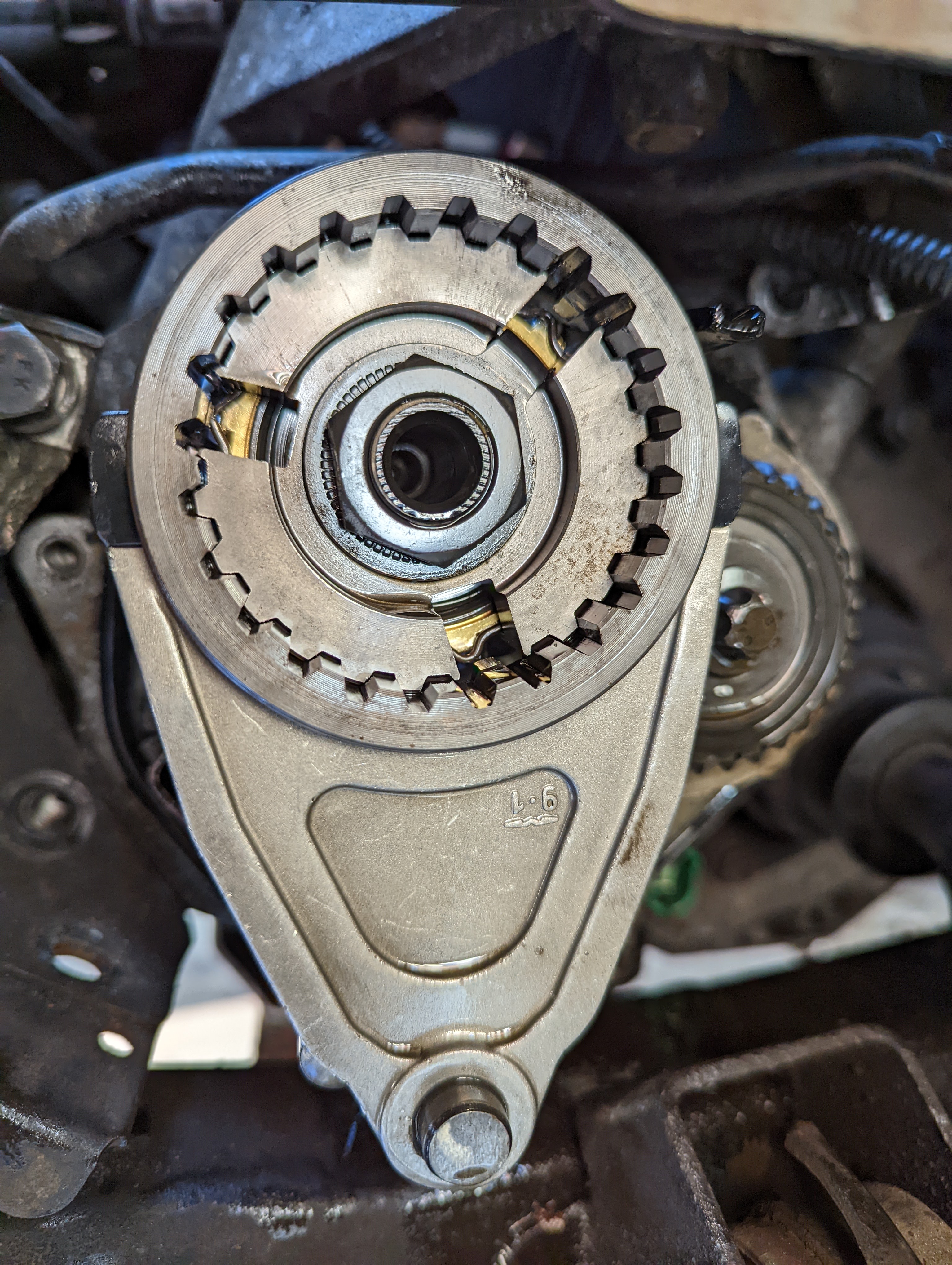

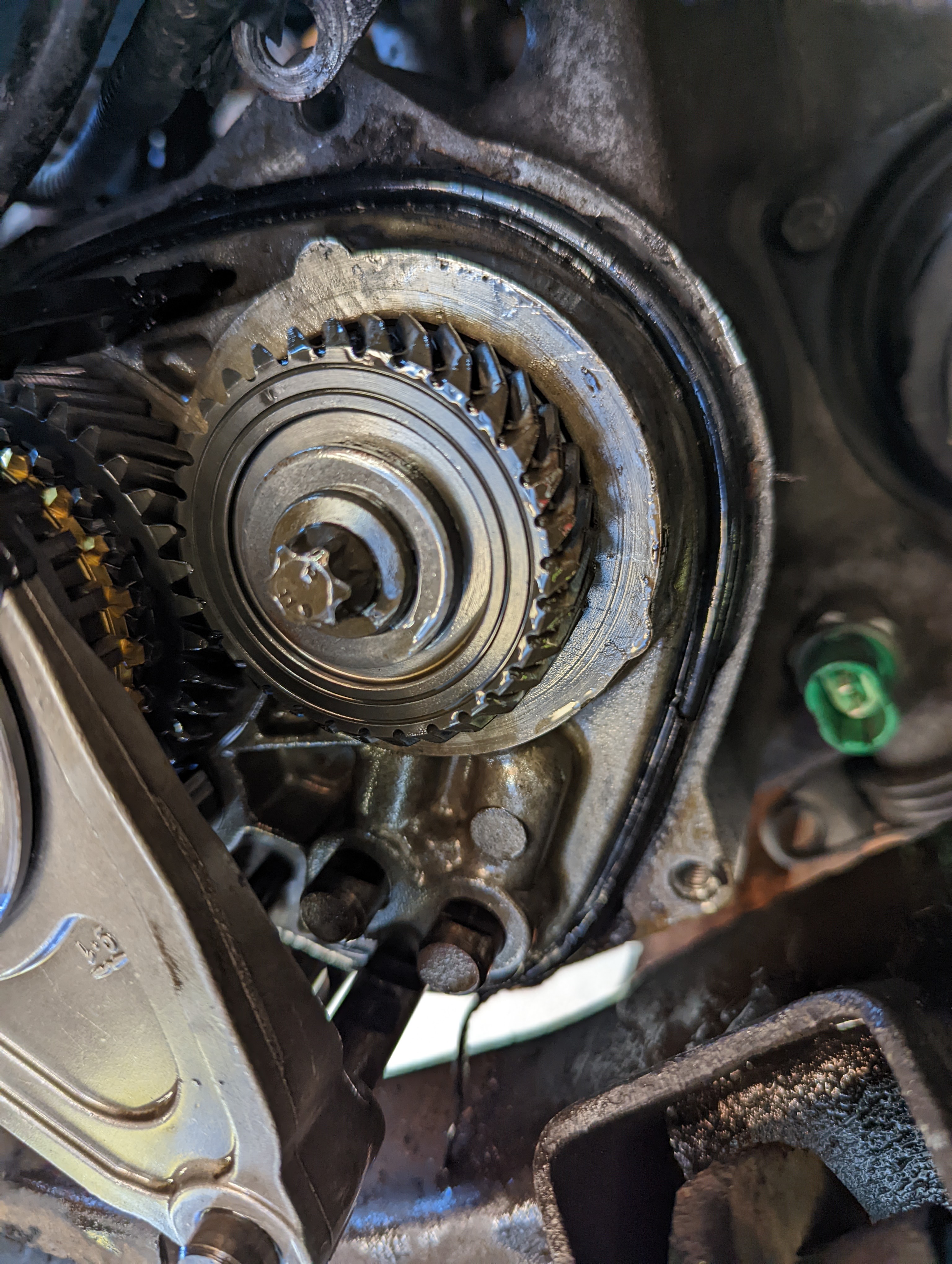

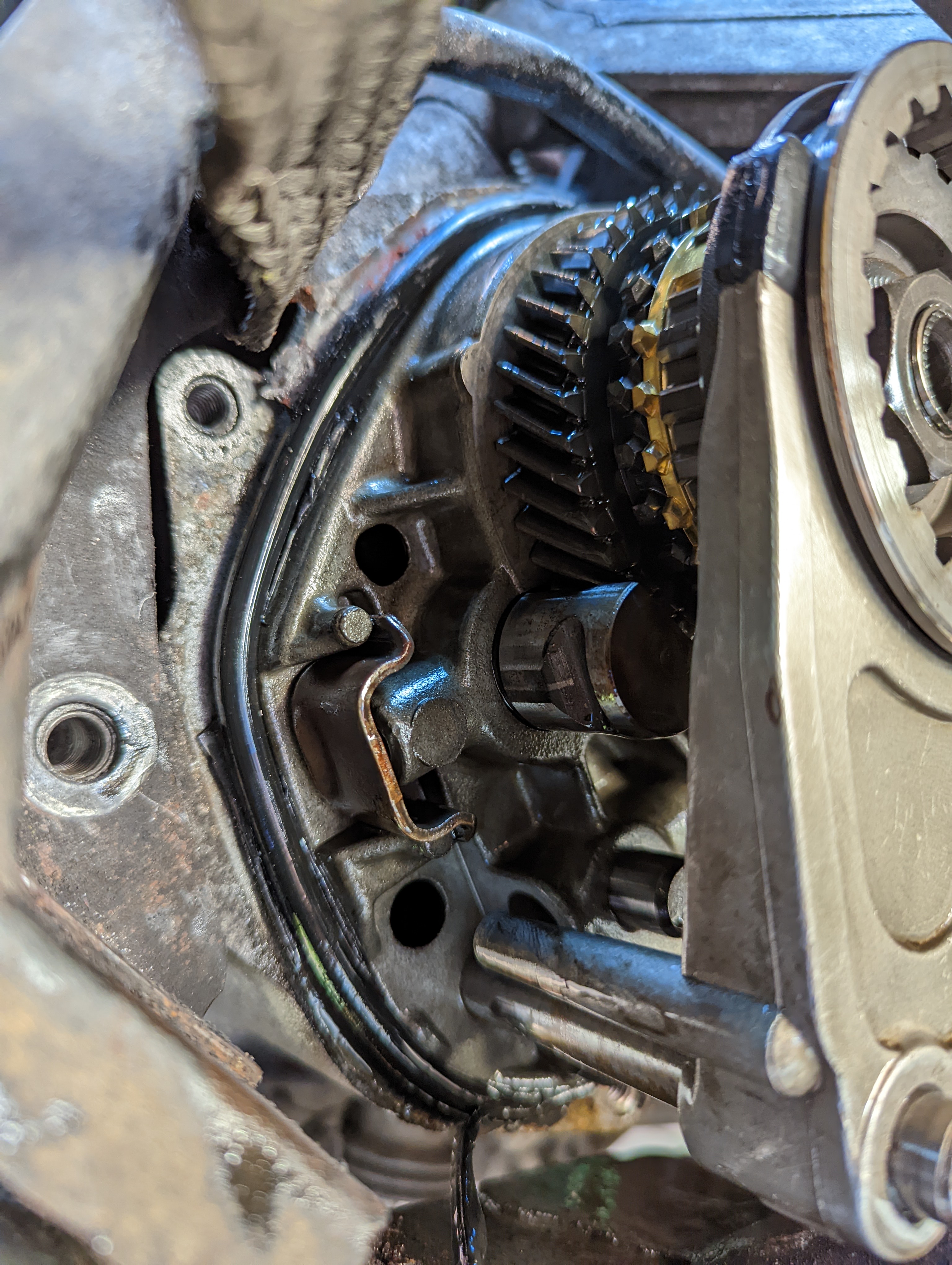

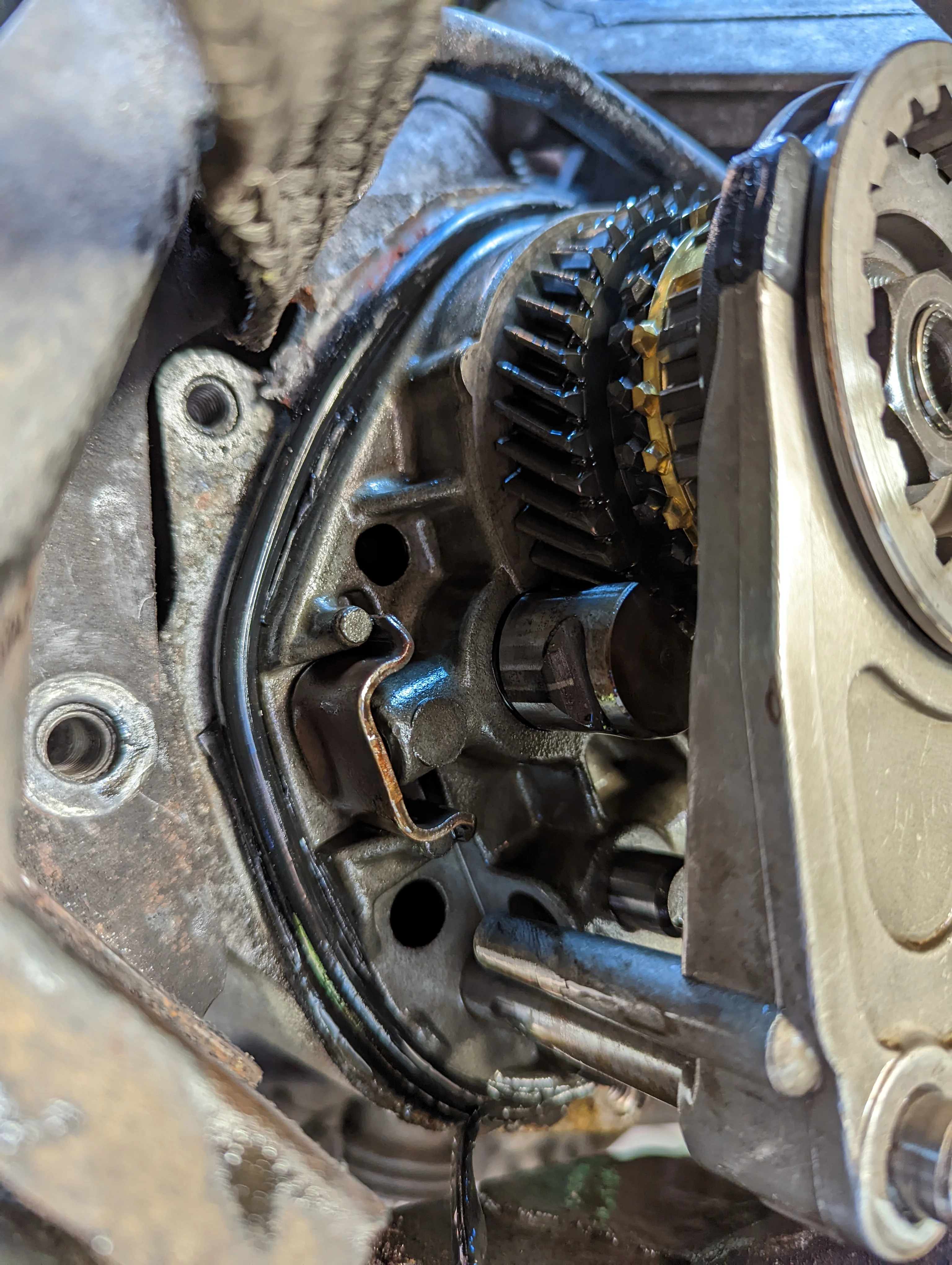

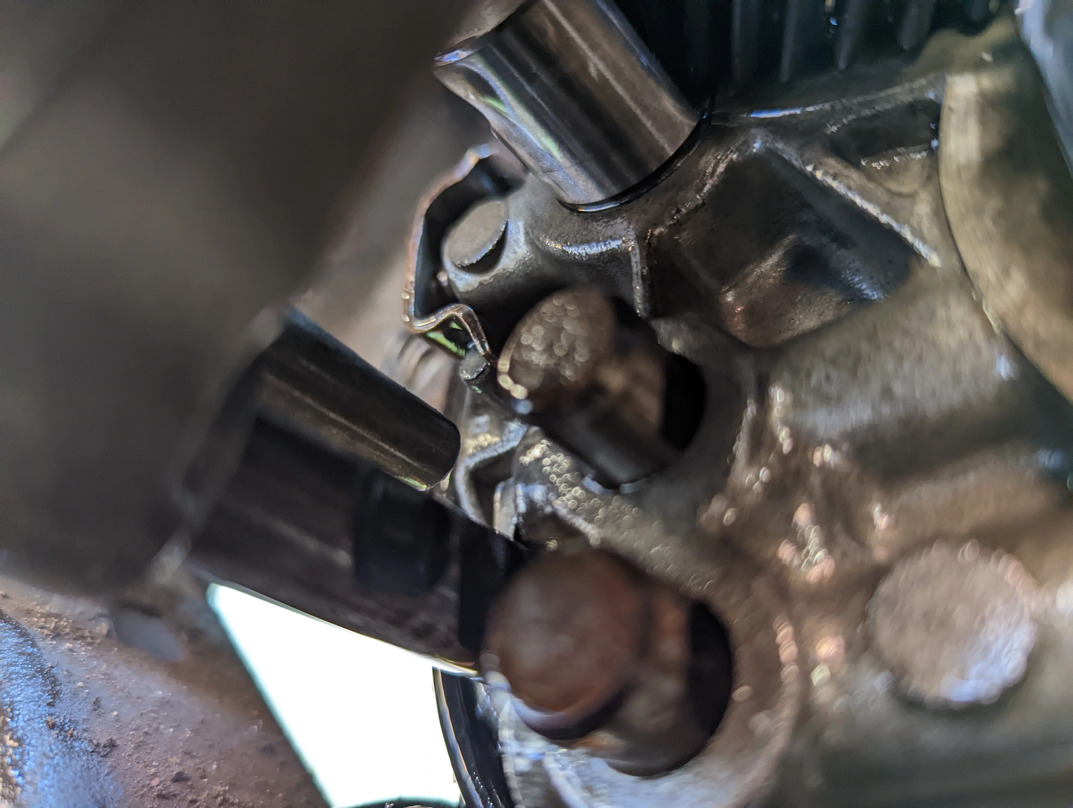

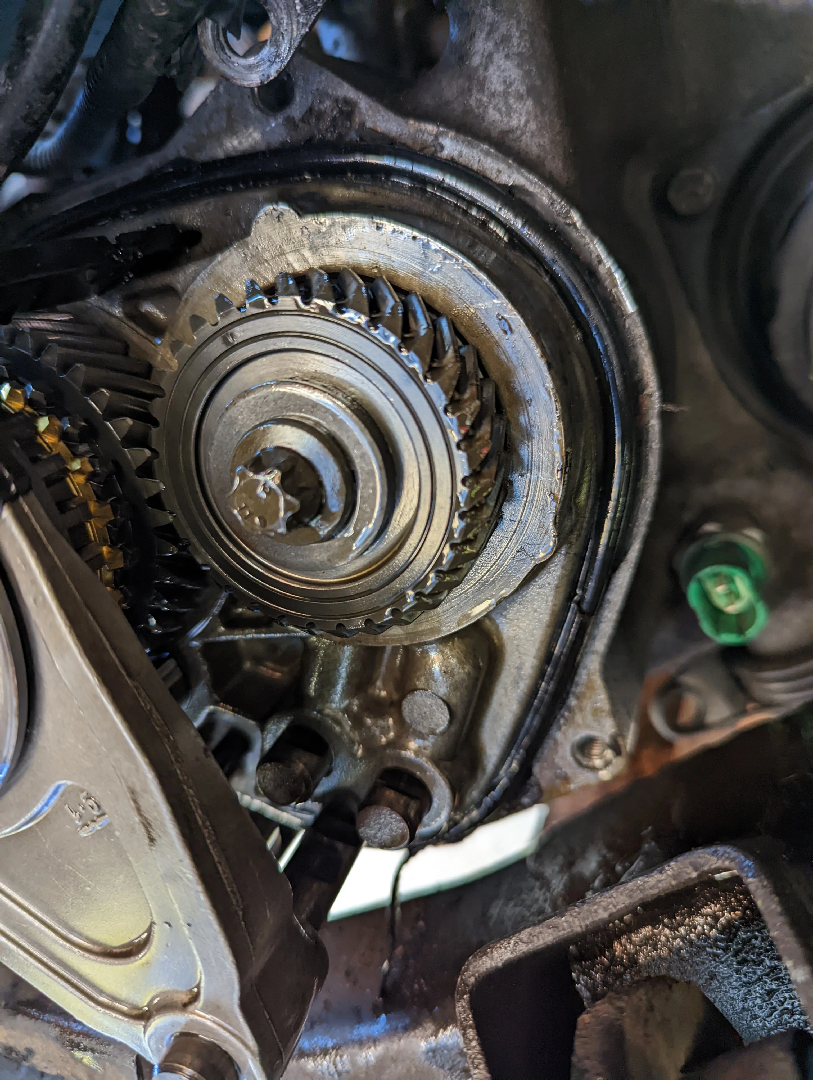

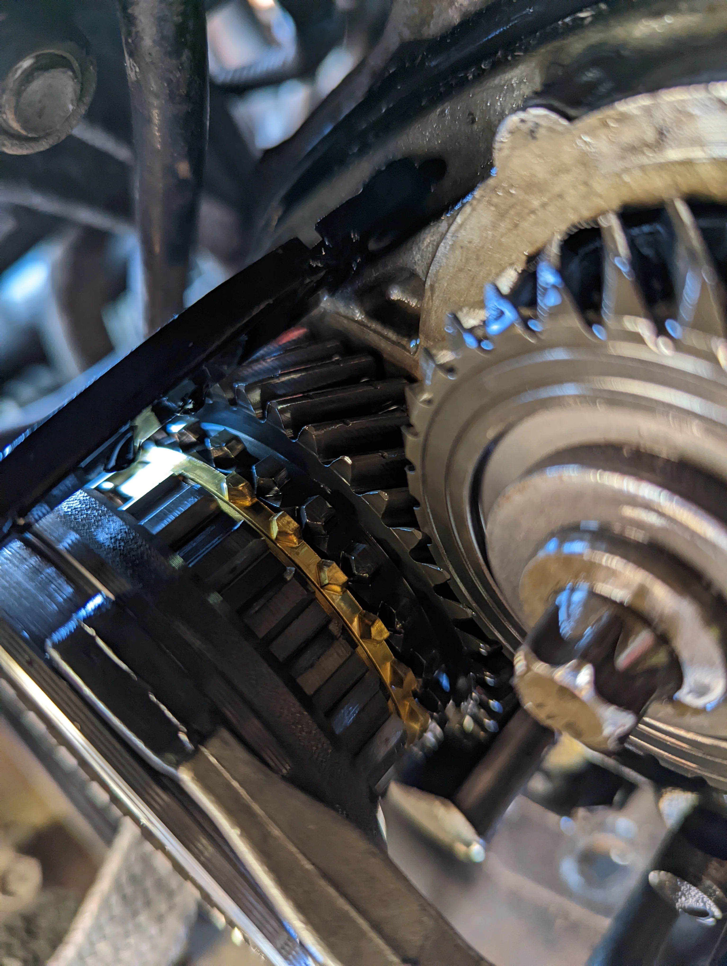

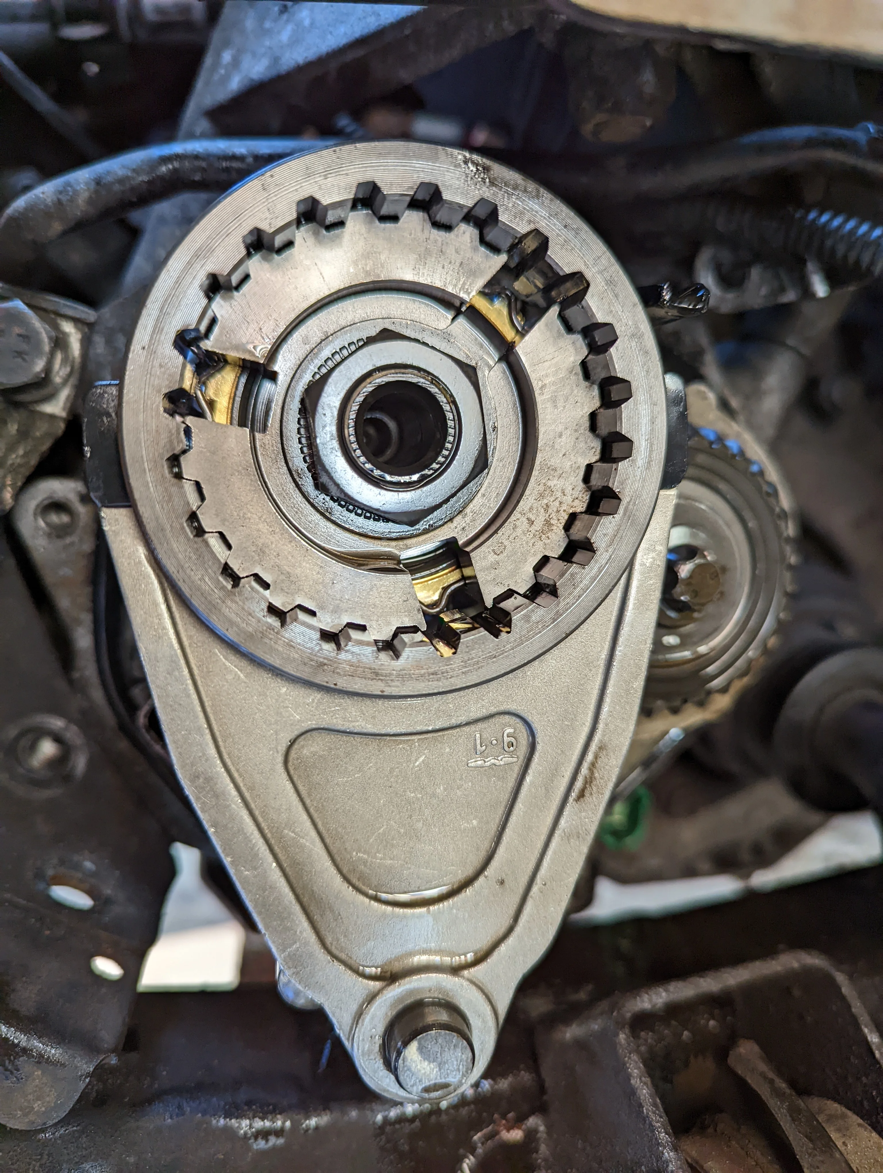

Right I've dropped the box down to the subframe and removed the two bolts on the bottom and left. Do I need to do anything with the top bolt as it just seems to spin on the bolt itself and the but doesn't get looser.
Assuming a bit of prying force is needed to get the black cover of itself ?
Ignore the last one just needed a bit of encouragement :) !

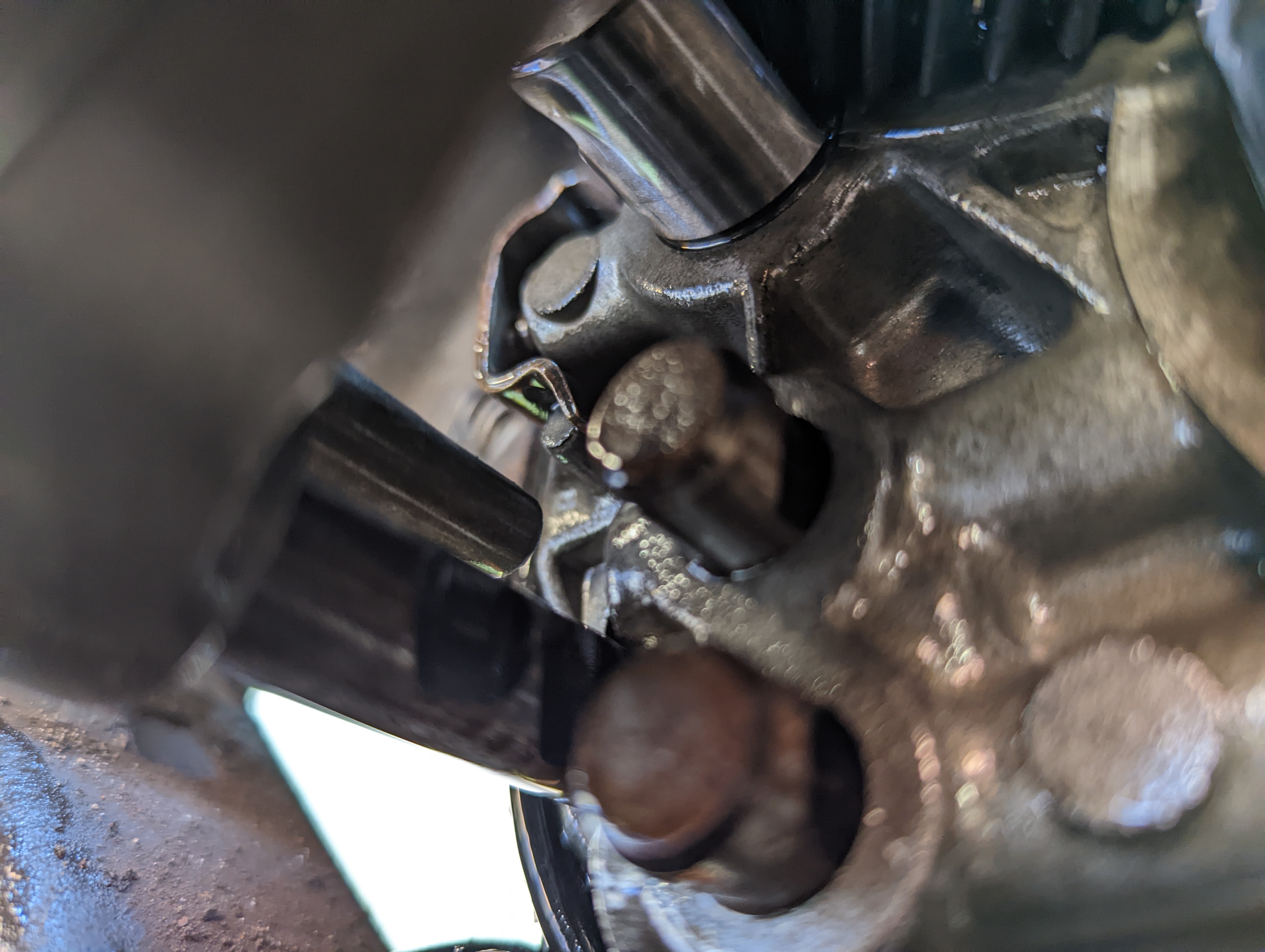

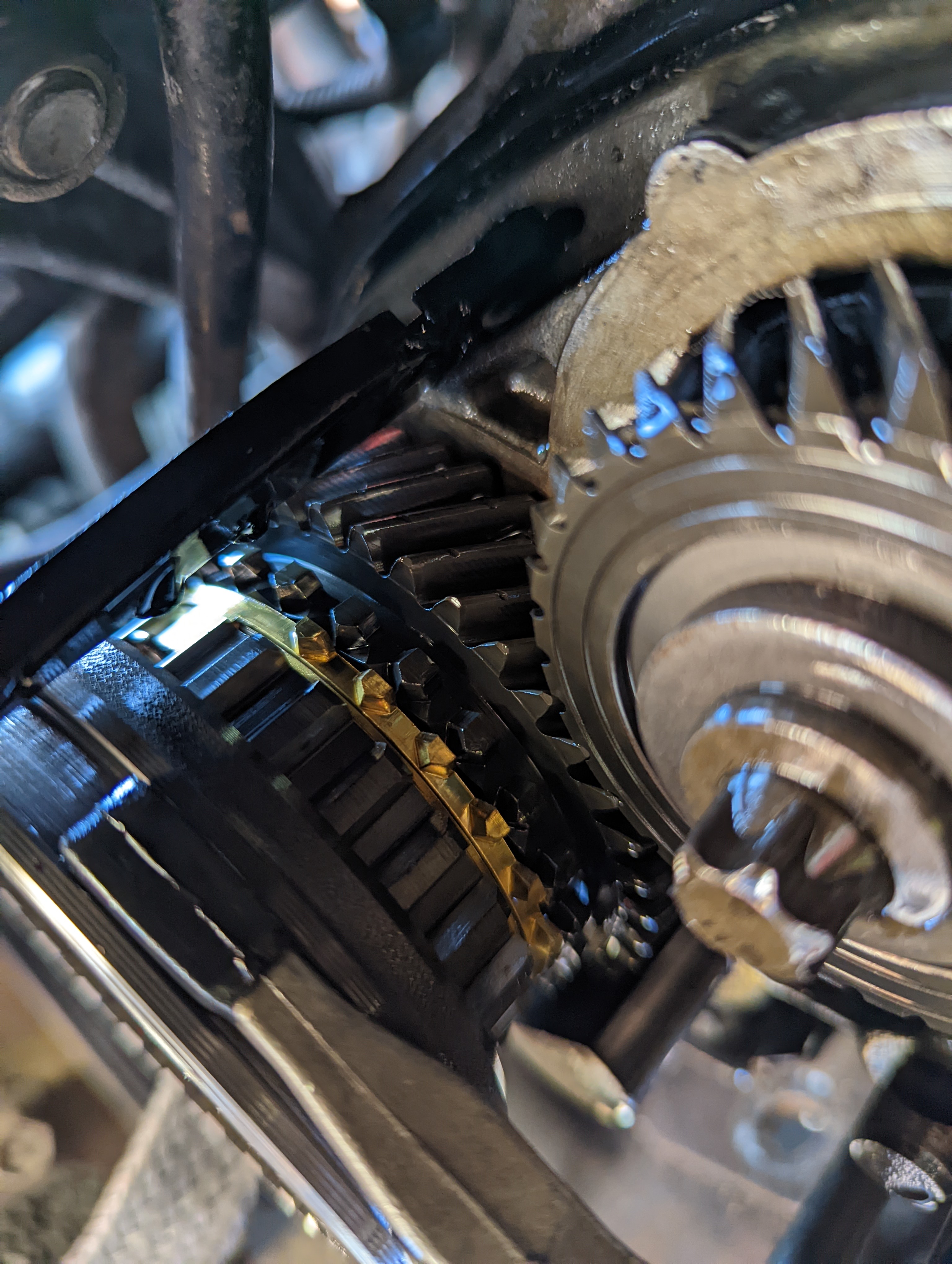

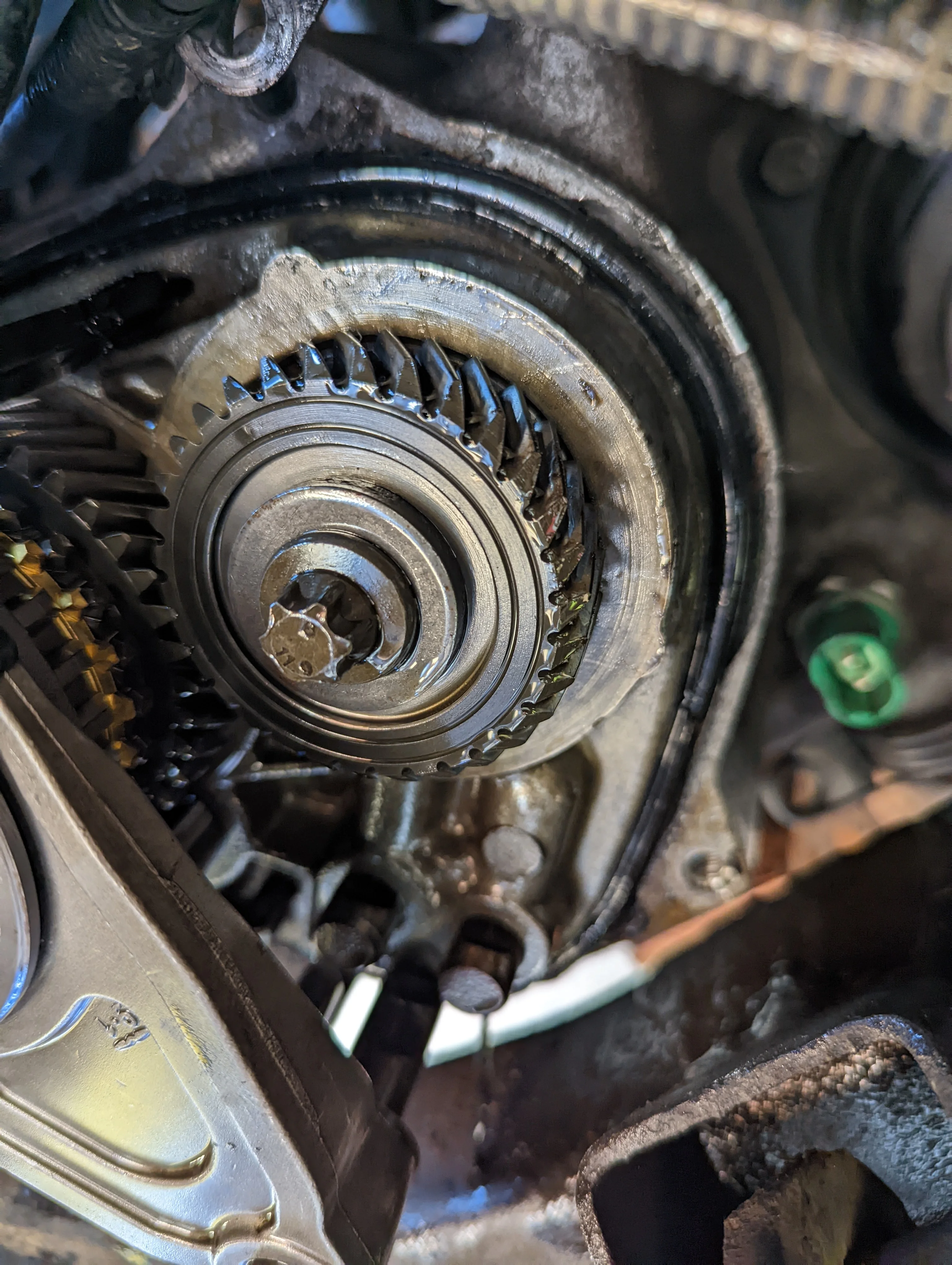

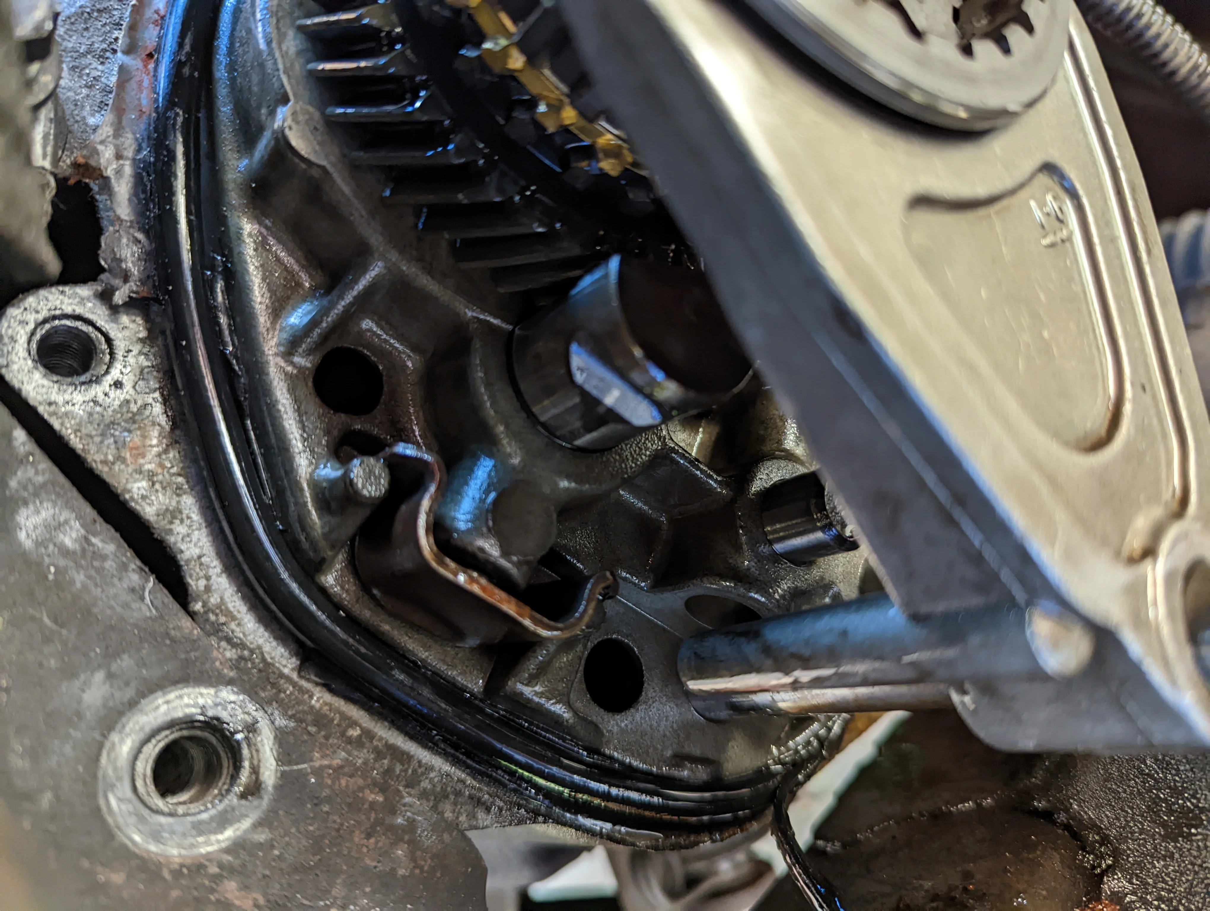

See pictures @NorthloopCup

Right, so straight away I can see that the selector for 5th gear isn’t in the correct position.
I will post a pic in here of what it should look like this evening and tag you in it mate. 👍🏻
The good news is that it hasn’t stuck in any gear, so hopefully with 5th gear back in the correct place, you will get all gears again.
Perfect, great news 😁
Appreciate the help

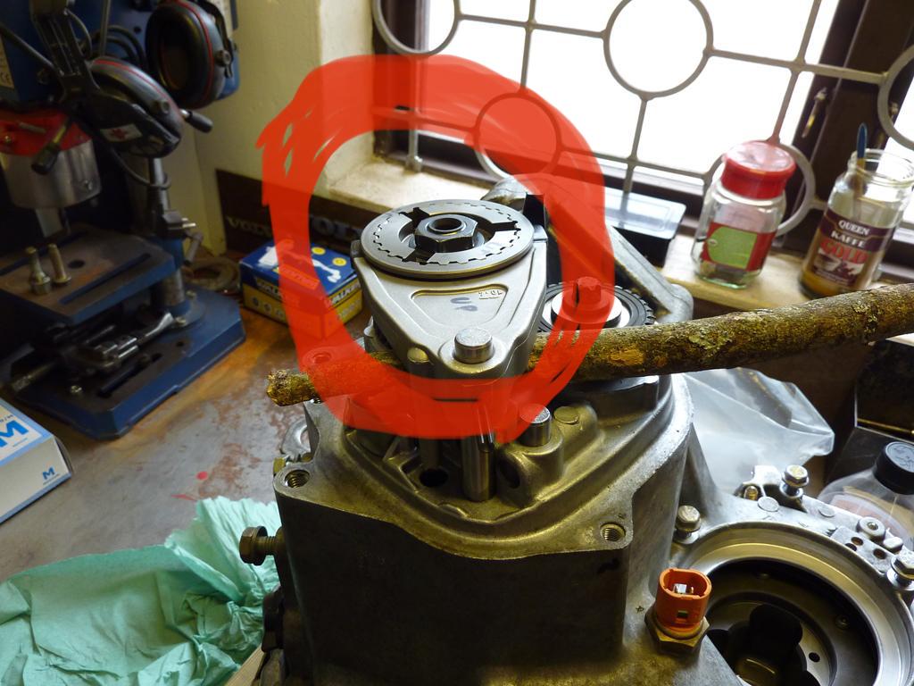

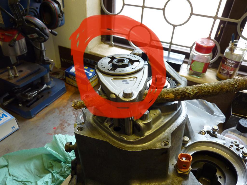

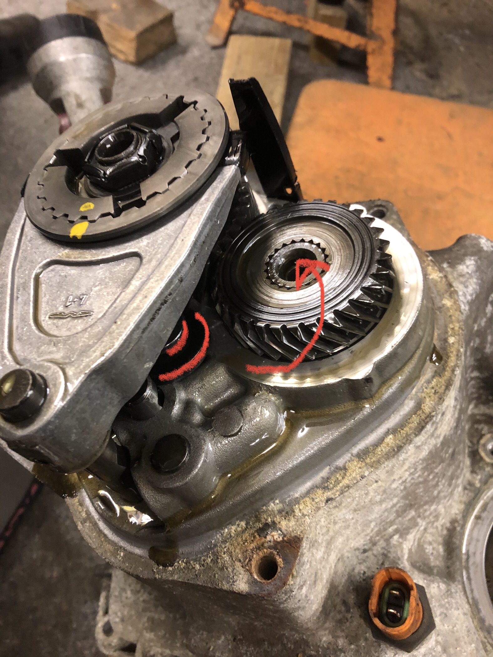

Right so you see the fork/hub assembly circled red? On yours it’s sitting proud and it needs to be flush - as in the image.
There’s a spring clip you access via the 3 slots in the hub - if the hub won’t slide down and sit flush, stick a small screwdriver in the slots and manually manipulate the clip to allow the hub down.
Sounds a lot harder than it is lol!
View attachment 1590241Right so you see the fork/hub assembly circled red? On yours it’s sitting proud and it needs to be flush - as in the image.

I like your use of fancy tools!
Why thank you. I’ve also got a c**k like a lion bar.
TBF to @NorthloopCup they aren't his pictures, I suspect he has a much nicer looking stick.
No I shamelessly robbed the image off here as I forgot to take a pic of the one I’ve got in the garage lol
