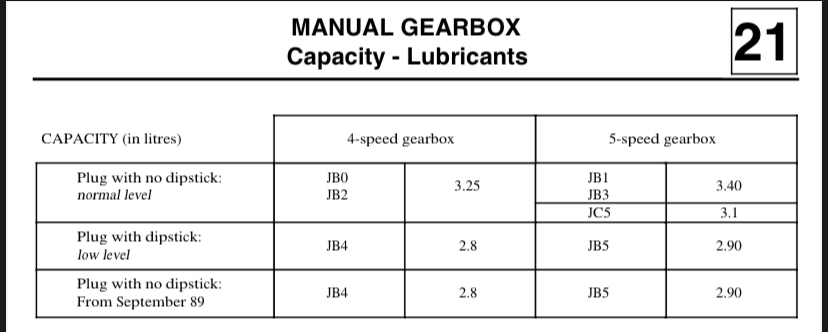

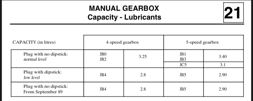

Is this the correct Motul stuff?
If so, how much does the gearbox take and is this a decent price?
