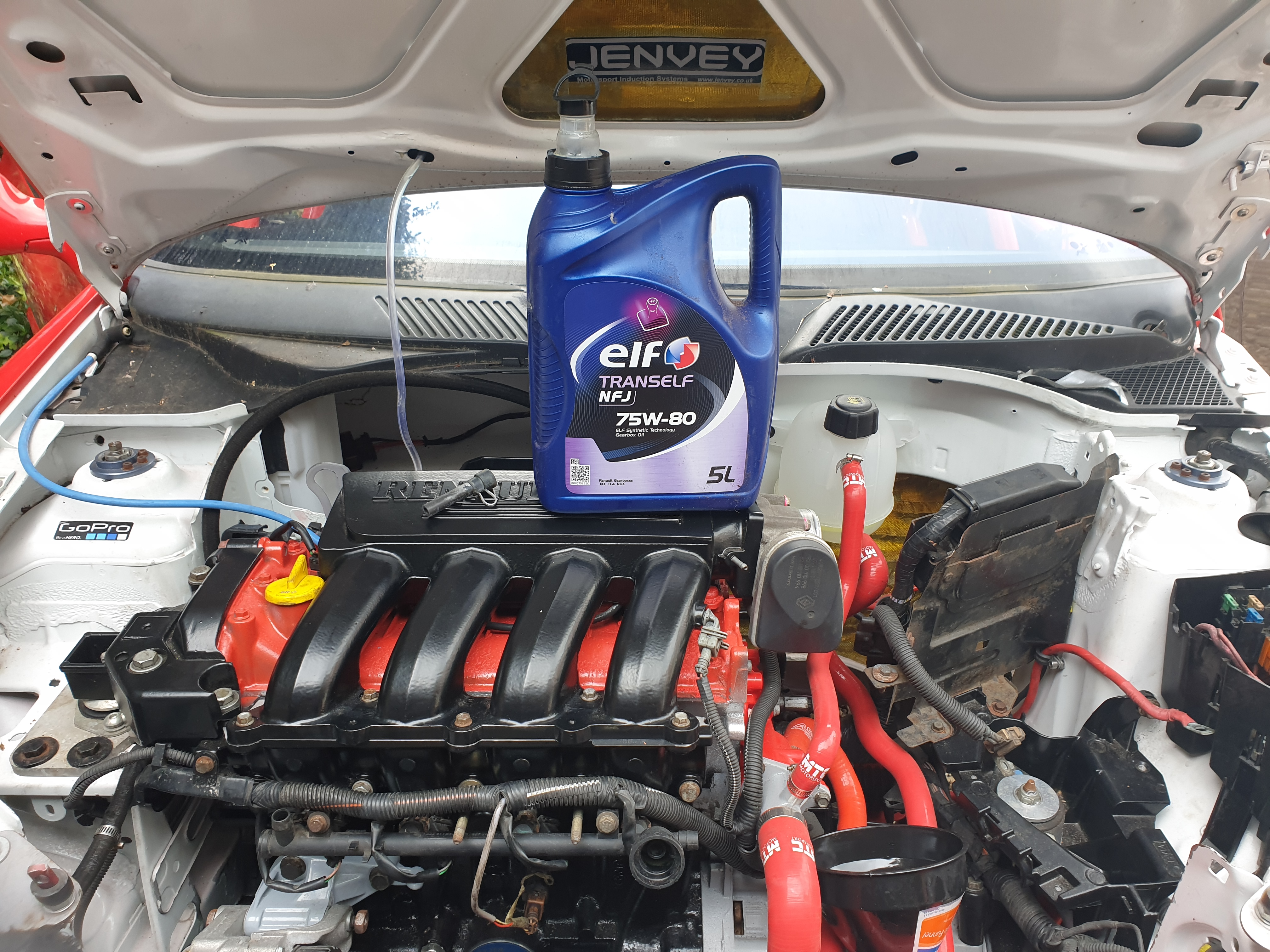

Hi , just been having a nose for gearbox oil requirements.
Ive seen 75w80 elf Nfj pop up ? Is this what i need and around 3 litres per box ? Need for 2 gearboxes.
Is this what people recommend or any other manufacturer ? I think ive only used elf in the past when ordered oils via renault ?

Yup that will be ideal, and as the above poster mentioned, Redline MTL is also a good choice.
ELF NFJ or Redline MTL
Just make sure it's definitely GL4 because if not your synchros are gonna have a bad time. And you need about 3l per box
I use the redline mtl in the nissan , yeah thats why i wanted to check as i know the jc5 likes to self destruct 😂. I will makesure i get either one of these then. Whichever works out best price or can get in so i can do it this weekend
You could try it, it wont break anything or harm anything but being a little thicker when hot you might get a baulky gearchange.
Best to stick to 75w-80 (y)
