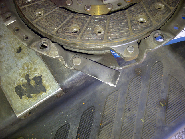

Was pulling out of a layby on Thursday night when my Clio lost all its drive :(, i originally thought that it jumped out of gear, Ive got no drive in any gear, if i release the clutch in R 1 2 3 4 or neutral there's a clicking noise from under the bonnet but when i try to pull off in 5th there's a grinding noise from under the bonnet. When i put the clutch in the clicking & grinding noises go away :S
Ive got it in the garage at the min but they cant look at it till Monday, im almost certain its the clutch, just wanting to know if anyone has any other opinions, could the clutch failing like that take the gearbox with it?

Could be the springs on the pressure plate, they do let go.
