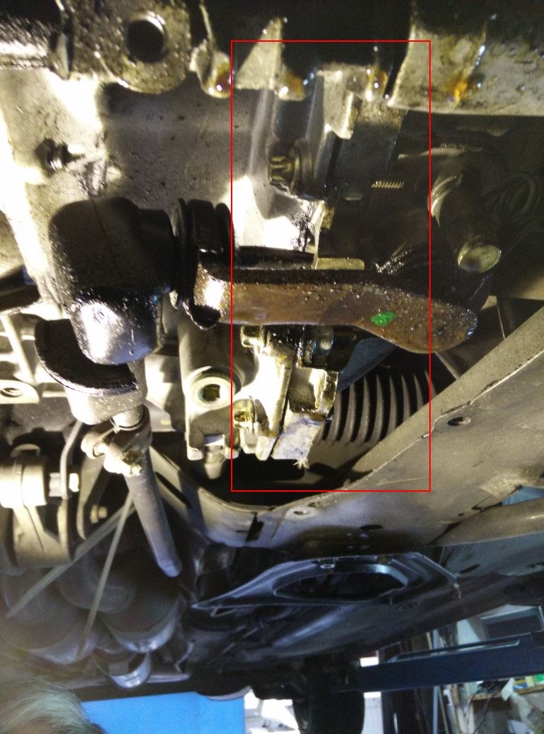

hi guys...my box is pissing oil where the casing joins the engine block
there shouldnt be any seals inside yea? if not then why is it leaking so bad?
is it possible to check other stuff without taking the box off?
i have replaced the selector rod seal with that split in half kit already and the leak got worse... i have to fill 100-200mil every 1000km or so....

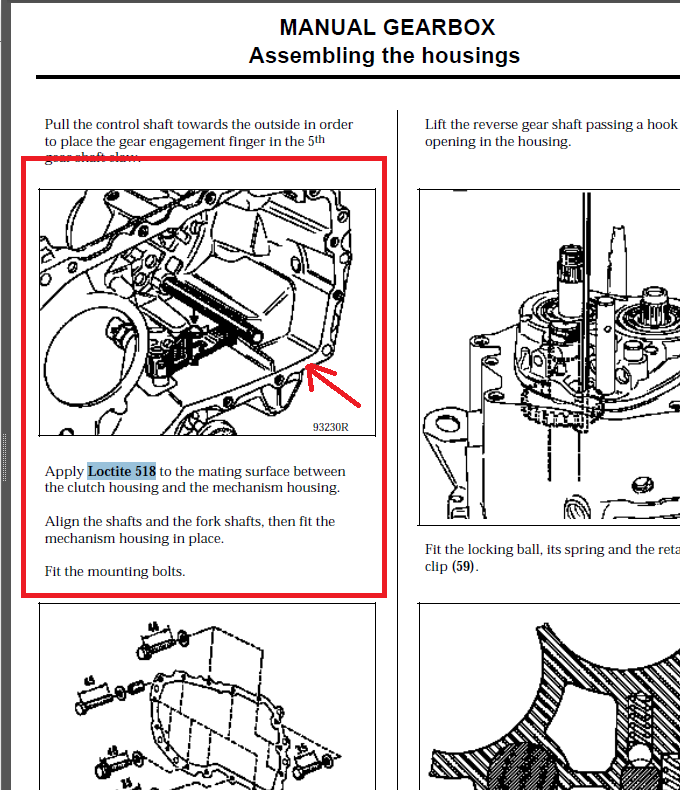

guys am i leaking oil here?
if i am reading this correctly, i need to redo this gasket?
if so, can this be done with the box in the car?
can i just undo driveshaft, undo the e-torx bolts that mates the gearbox casing to bell housing, pry it open, clean the edges and redo the gasket?

well....my ps is leaking as well but engine side should be good cause everything other than headgasket is replaced
and im losing gearbox oil.selector seal alrdy replaced with the split type
and since its not leaking engine oil i concluded its not due to flywheel bolts put on withiut loctite

If you are saying it's worse since you replaced the selector seal, then I'm guessing it's the selector seal again.
They are the weakest link.
  Clio.
Mind you looking at the photo above, the gear oil seems forwards of the selector seal.
Is it leaking from the breather pipe on top of the gearbox?
Also, if there is evidence of oil spraying around the bell housing (where it joins to the engine block) it maybe the oil seal of the input shaft.
Give it a bloody good clean off and stick a sheet of cardboard under the car to see exactly where it pools the oil.

hmm... well i have another selector kit here alrdy cause i was thinking if it was the the seal:laughing:... but since its not...its sitting here for now
dont think its the breather pipe leaking cause the top is clean..let me have a look again tonight
and yes oil is spraying everywhere ...i can smell the oil especially after spirited drives...

ok cleaned around the box with brake cleaner...went out drove flatout for 10km....only the bottom is wet
so...i guess that concludes its the seal?
