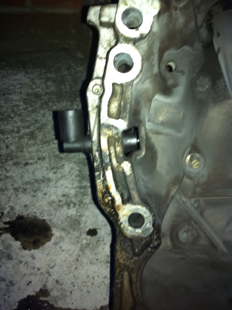

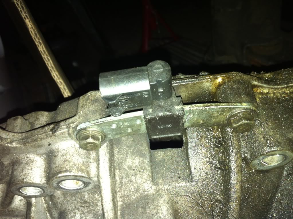

okay got the box out last night and the scrap yard has two clio box`s. He needs to know weither the speedo runs of the abs or the actual box.
i cant see anything apart from this that would be a speed sensor, i think this is a crankshaft position sensor
Yea thats cranks sensor. The soeedo will drive off the ABS on a 182.
Are they 172/182 boxes they have? Not all Clio boxes are the same.
