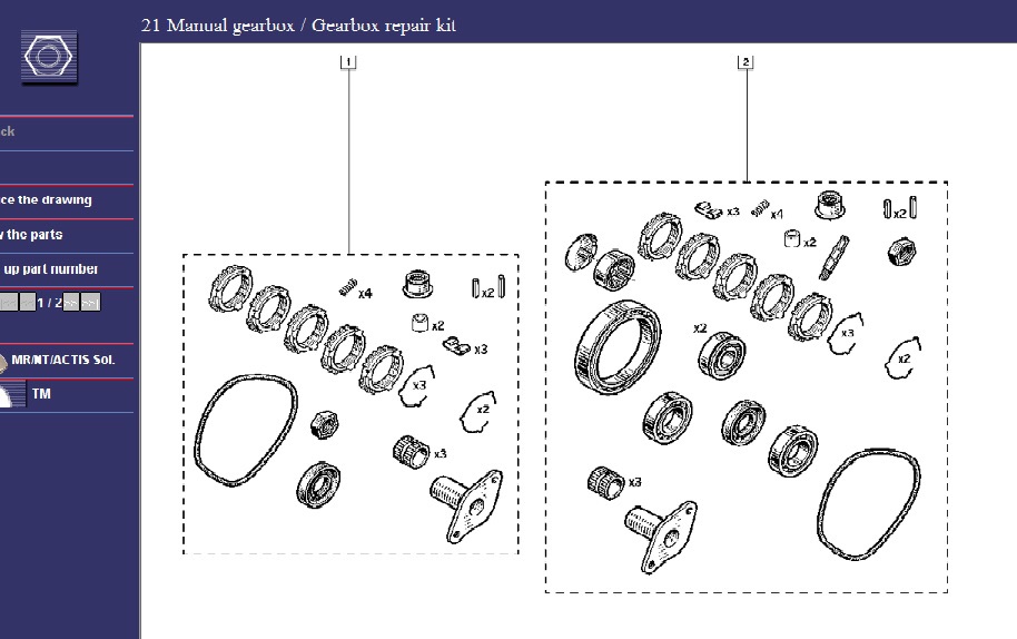

@Gerben Visser the part number for the full rebuild kit you require is: 3201 043 88R
The item on the right of the picture is the large overhaul kit with bearings and synchros, but the item on the left is only a basic one with synchros and seals.
I can get the large kit for around £270 (gbp).
Hope that helps.

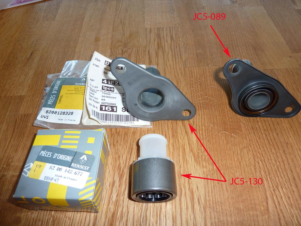

Back again! I have ordered the kit at my Renault dealer (32 01 043 88R), but it does not look right.
I need the parts (both) on the left (JC5-130 according the arrow), but in the kit is the part which is on the right (JC5-089). Also the supplied bearing is wrong, I need the one from the left, but there is only a smaller bearing in my kit (not on the picture):
Also, I don`t have the sealed bearing from this pic (which is a ball bearing), there is only a open roll bearing in the kit (so with rolls instead of balls). I am talking about the bearing on the left:
Somebody knows what happened? I can order the missing parts, but why is it not in the kit from Renault? They called already with Renault France, but there is no kit which contains all the right parts, strange?
Pictures are from a other thread and it is not the same gearbox, but they show the right parts which I am talking about.

Well that doesn't make sense! At all! Going from the gearbox code you sent me, that should've had all the correct parts in it.
The jc5 130 has the sealed bearing and bearing/seal arrangement for the input shaft (which you are missing).
It's only the main shaft that has the taper bearings so you can shim it to set the preload.

For your information, I did not give my dealer the partnumber I found over here. They came up with the same partnumber as you gave me, without telling them.
And all the parts for the input shaft are wrong indeed. I have a bearing and seal for the input shaft, but not the good ones. So there is something in the kit, but not what I need.
To bad, but I have the numbers so I can order them separately.

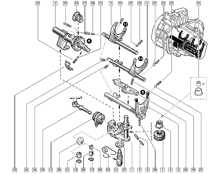

Small question, maybe @NorthloopCup again? I am sorry for bothering you, but it seems that you know a lot about gearboxes.
The springs above (number 22), do they have the same partnumbers? I have 3 grey springs and 1 black spring, it are the old ones because I don`t have them new. Does it mather were I put the black one or are they all the same?

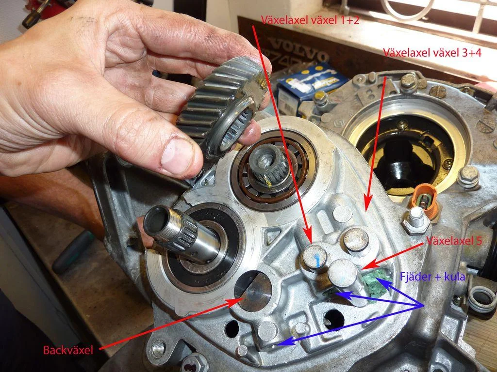

Hi Gerben. The grey ones are used for the reverse shaft, 1st and 2nd selector and 3rd and 4th selector. The black one is used in the 5th gear shaft. God knows why because they're all the f**king same! Lol!
Little tip - get some 12mm bolts to hold the spring and ball bearings in place for 1/2 & 3/4 selector shafts on reassembly. Life is made substantially easier!
